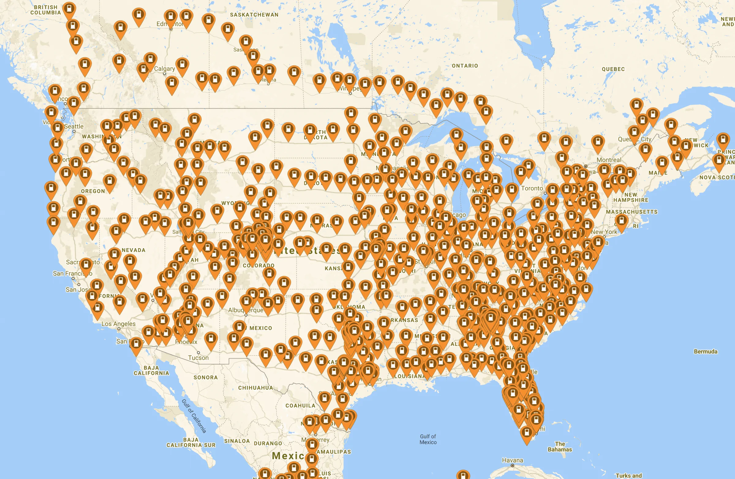

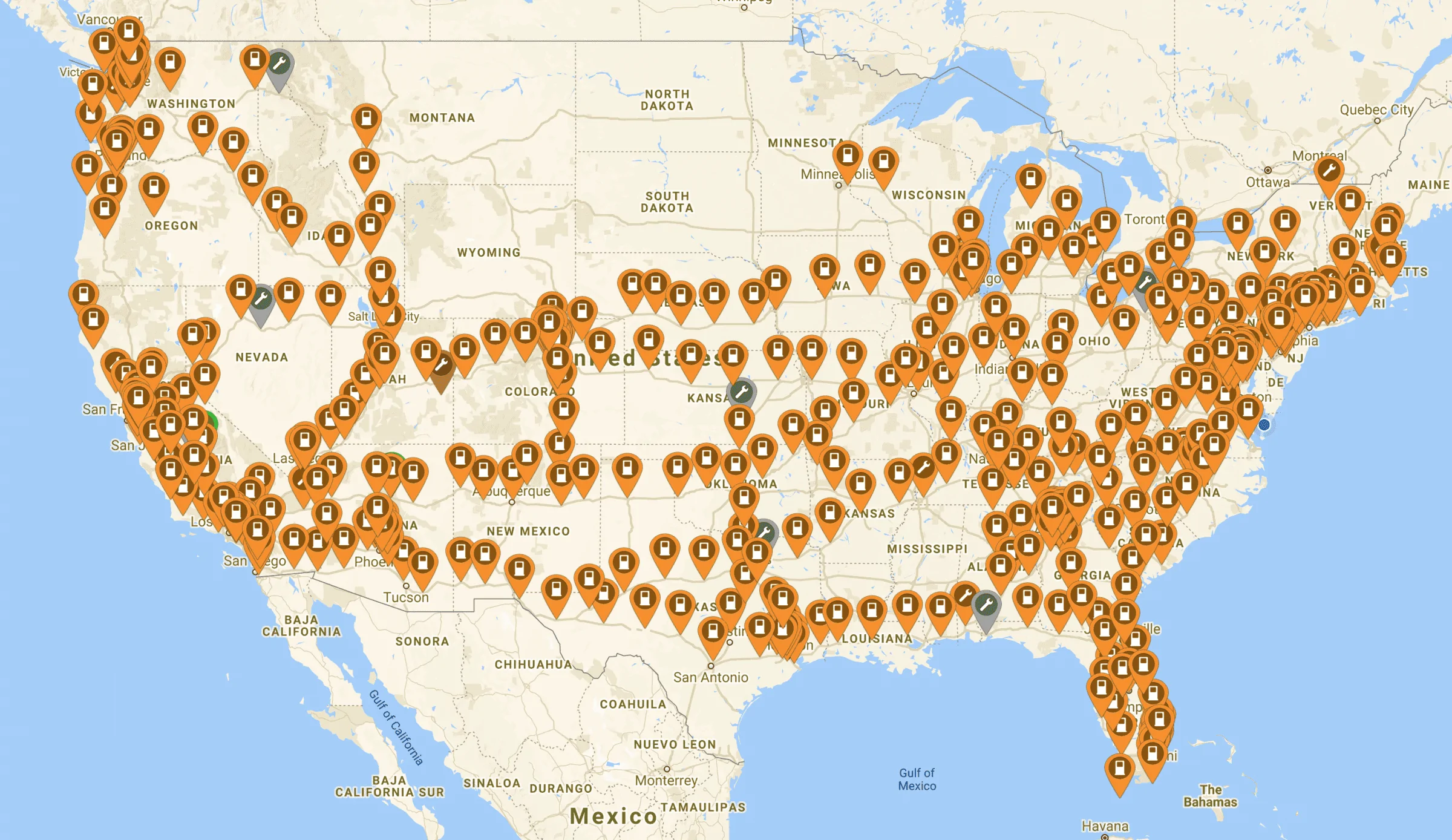

Nah - I used campgrounds and marinas in 2013 and 2014 before the Supercharger network existed. Those days are over. Superchargers and DCFC are ubiquitous within the 180-mile range you speculate these days on most travel corridors. Check the maps - and they are filling in every day - I am an EA critic, and they still have huge gaps in areas I care about, but going East/West or North South, you are covered within your range spec.
https://www.electrifyamerica.com/locate-charger/
https://www.tesla.com/findus?v=2&bounds=56.521752356345885,-33.39955542500001,12.401932806199708,-118.301899175&zoom=5&filters=store,service,supercharger,destination charger,bodyshop,party
EA Network as of today (first Image):
Tesla Supercharger network as of today (second image):
Both courtesy plugshare.com
Great post, thank you!
