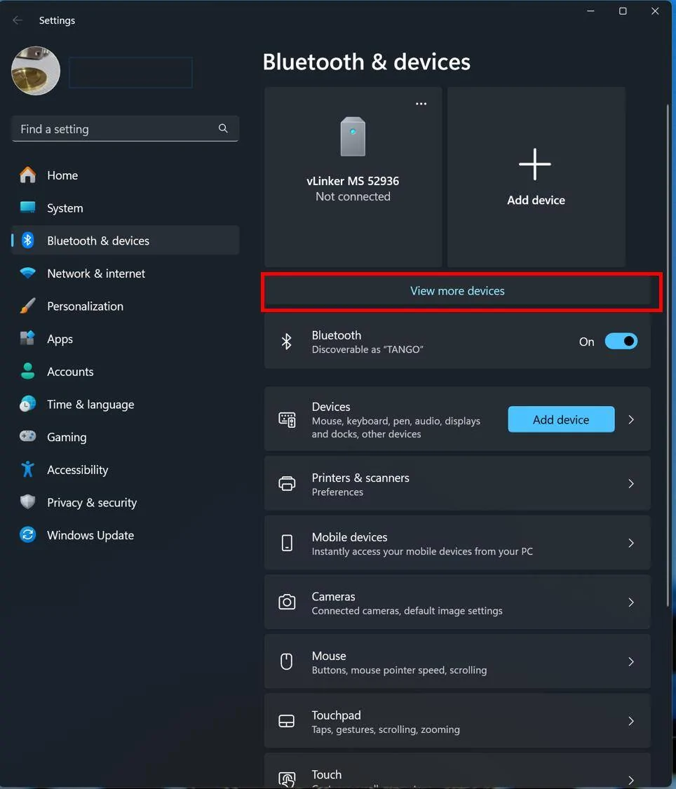

Open Bluetooth Settings and go to "View more devices"

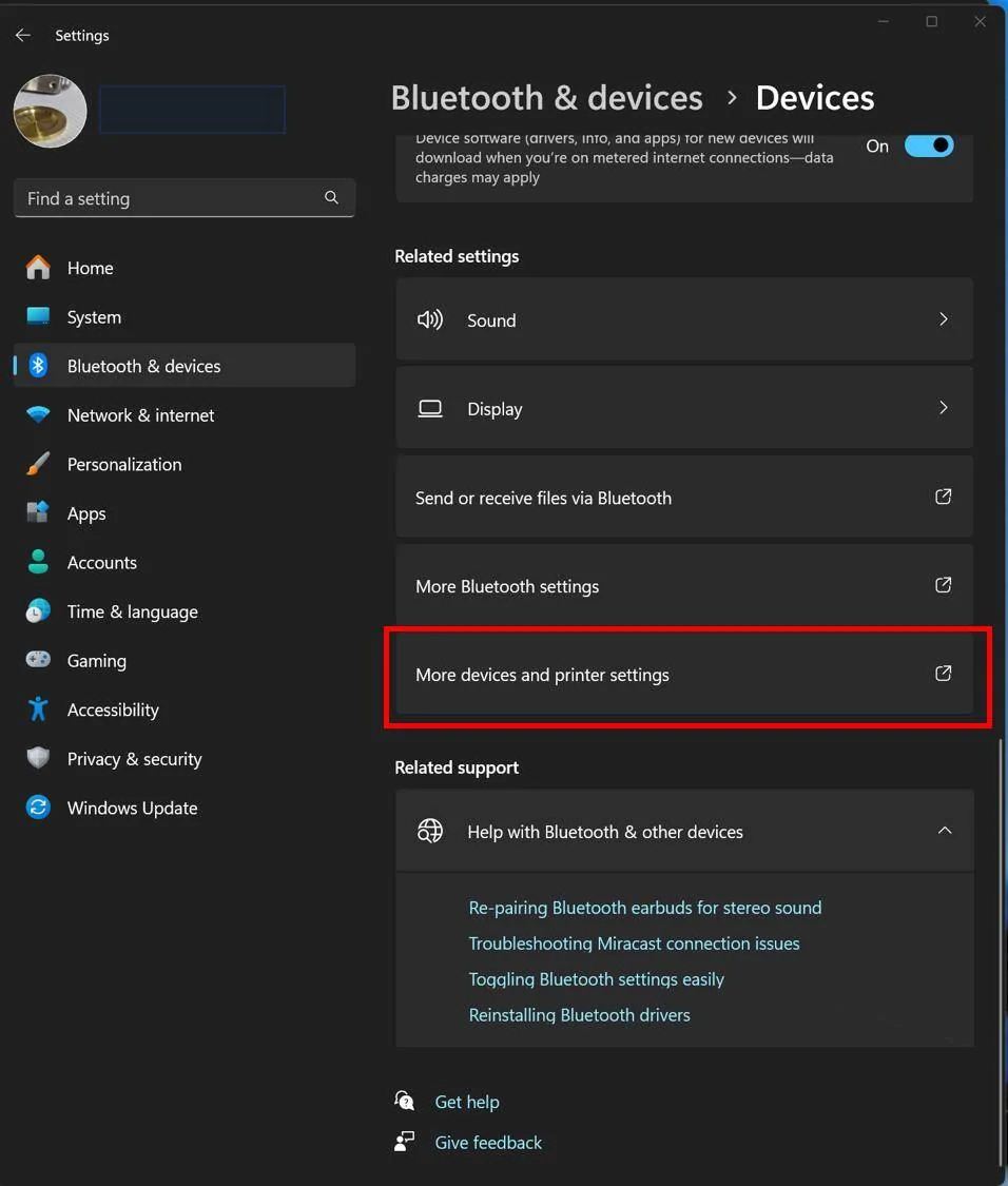

In "View more devices" scroll to the bottom and select "More devices and printer settings"

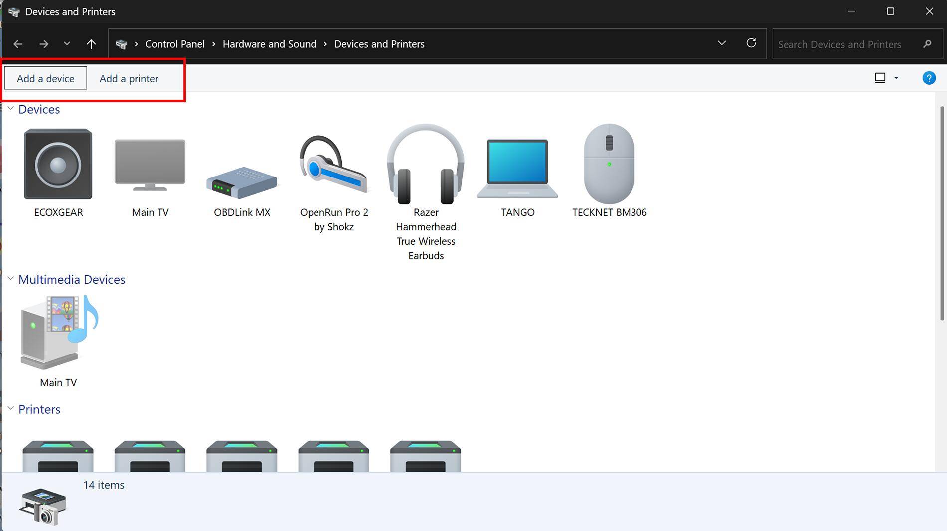

In the devices and Printers select "Add Device"

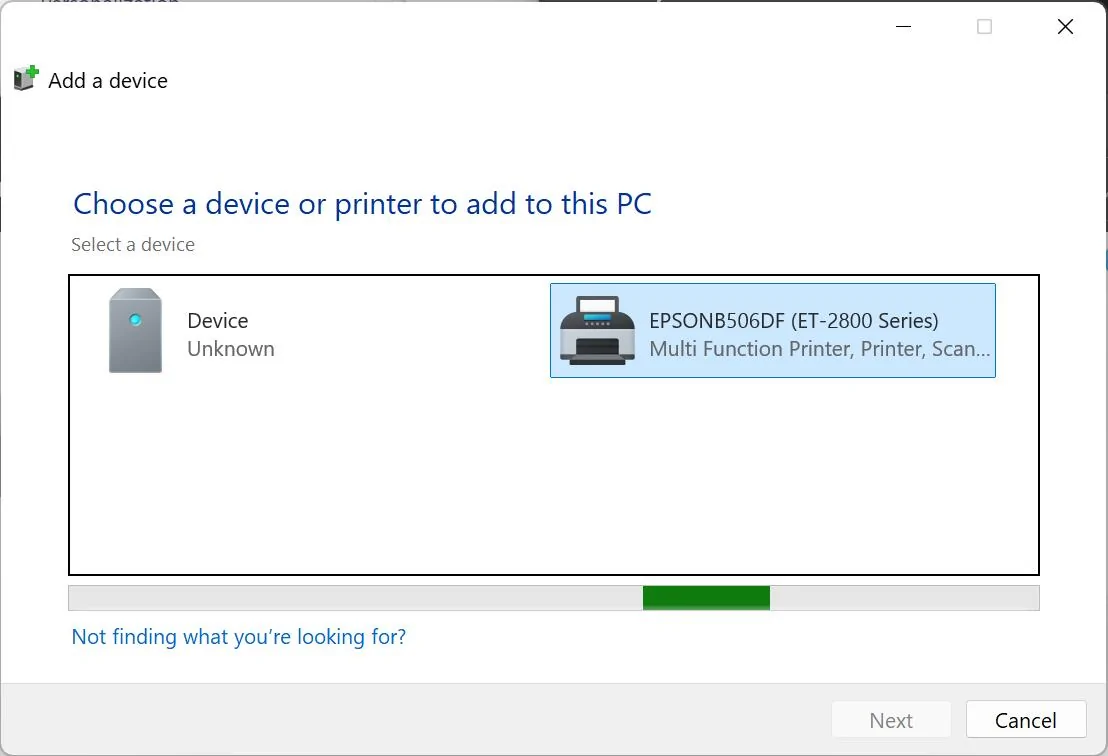

The vLinker should show up here by name (not shown in this screenshot). Make sure you have enabled pairing on the vLinker.
Ford F-150 Lightning Vgate vLinker MS for Monitoring & FORScan (and connection issues) Screenshot 2025-07-12 090119
The vLinker MS will now show up as a Bluetooth device in the device list and you can also select it from the dropdown in FORScan.

In the Bluetooth and Devices > Devices window (second screenshot) if you select "More Bluetooth Settings" you can go to the Comms Ports tab and see which comms ports your device is connected on (or remove them). My former MX+ was on comm 3 and 4 and I did remove it before connecting the vLinker but I do not believe that made a difference in my case.
Also, Windows is dumb...
To add the device you are in a screen under the control panel (Control Panel > Hardware and Sound > Devices and Printers). If however you go to the control panel, select hardware and sound, and then select Devices and Printers (or add device), it will not open that display, it opens the Settings window (and closes the Control Panel). You then need to follow the instructions above to get to the "devices and Printers" screen in the control panel.
