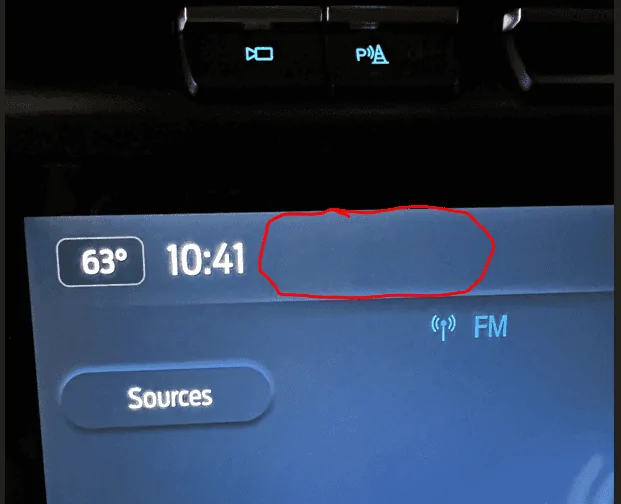

I've occasionally been hearing a random double chime with no apparent alert. It happens much more frequently when I'm towing my flatbed bumper pull trailer. It is still erratic but rather annoying. Is anyone else getting this alert or getting a double chime but not seeing any alert? My 2022 XLT SR has the onboard scales.
The truck has not been overloaded any of the times I've received this alert. I have had a couple of times where I've been over the maximum GVWR but never got this message. My last software update was September 8th with the 3.5.2 OTA update.
Finally this Saturday I was able to see the alert. I haven't been able to get a picture of it because it displays very briefly somewhere between a half a second to two seconds of duration. I am seeing it display "Weight Limit" on the 12" screen adjacent to the clock.
Ford F-150 Lightning "Weight Limit" Alert with a double chime 1668401954379
I've searched the owner's manual and this forum and there is no indication of a "Weight Limit" alert. It is pretty frustrating that the vehicle can give an alert like this and not have it covered in the owners manual.
I have not yet contacted my dealer but plan on doing so this week to have them look into it.

The "Weight Limit" display on the screen is not consistent with how long it displays. Once I figured out what it was displaying there were times where I would look at the screen upon hearing the double chime and the message was only displayed for a fraction of a second. I think the longest I've seen it displayed was two seconds.
It seems to happen more during stop and go driving.
This past Saturday I had fully charged the truck. Hooked up my 18' flatbed trailer and took off. I got the first double chime within a couple of hundred yards. It repeated within about a half a mile. Then nothing for the next 11 miles of highway driving. After I turned off the main highway and was driving on the county roads then I got several of them.
After I got back home and disconnected the trailer I haven't had one since.

I don’t think the “weight limit” alert has anything to do with the onboard scales. I have the onboard scales and I’ve had it over the maximum several times and that doesn’t trigger the alert. It seems to be related to connecting a trailer. Maybe it has to do with the trailer brake controller.

From what I gathered (ie, speculation) the truck is seeing weight restriction signs on the road. I notice this twice today when my truck beeped at me. I had a fake active trailer, and each time the truck beeped I was passing a weight restriction sign. One was a 3T bridge, the other was a 4T roadway.

Almost certain that it occurs when the truck thinks you're towing and the road in its database has some kind of weight limit. Given the glitchyness of ford software. This happens sometimes when you aren't towing.

My truck doesn't read anything from the road -- doesn't show speed limits based on visuals, that kind of thing. I don't have BlueCruise, it's a basic XLT truck.
I think this is the winner -- I was on a road that has weight restrictions. I was under the weight limit, and the truck should have known that (based on the trailer weight I entered), but it still beeped at me. I wish it would have had a more accurate message like, "You're driving on a road with a weight limit of X and you weight Y."
