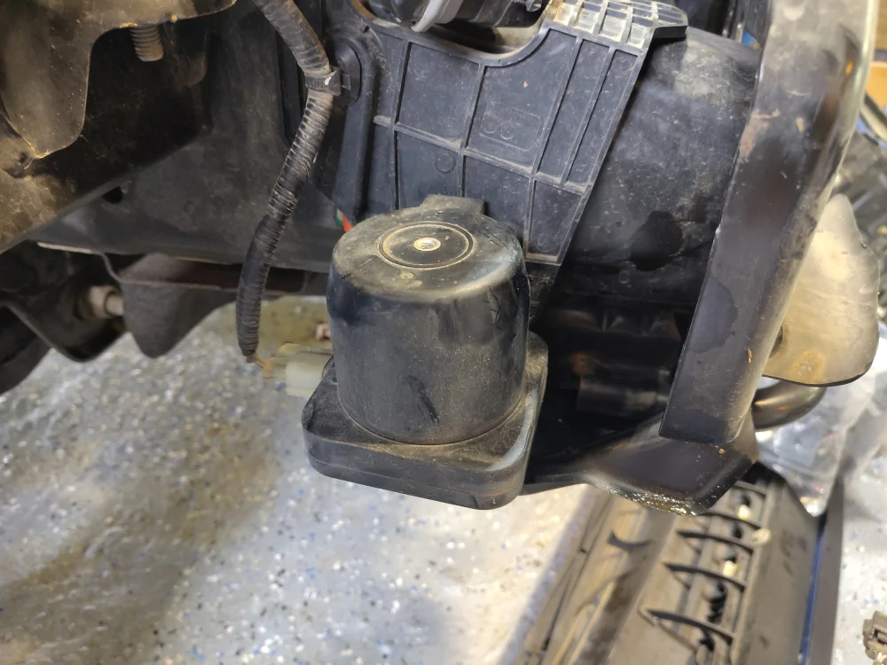

Wonder if anyone knows what these parts are? inside the front bumper. Attached two pics
Ford F-150 Lightning what are these parts? part2
Ford F-150 Lightning what are these parts? part3

NOTE: I have not looked in the bumper or under the truck at all and there is little to no sense of the orientation in your pics for me. That being said, the first one is almost certainly an actuator. The second one is a little harder especially without seeing the other side but first instinct says front facing radar or horn. The number of wires in the 2nd one should tell you which.

First one is an actuator for the air dam. Second one looks like a mount of some sort.

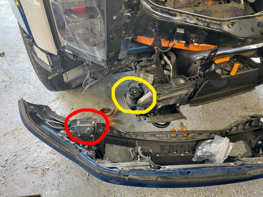

there are two of the things on the bumper in the first pic. left and right, symmetric. mounted to the bumper. looks like some kind of sensor. there is only one of the short fat round thing. it is on the passenger side. mounted to the frame rail, with that rubber saddle. on the other side of the center air damn. another kind of sensor, maybe? im looking at parts on line from ford dealership, but I havent found these items.

Hopefully this shows the parts better. There is only one of the yellow circle. And two of the red circle, on each side of the bumper.
Ford F-150 Lightning what are these parts? 1000016740

1st pic is an active air dam or active shutter actuator, 2nd pic looks like the pedestrian warning speaker.
