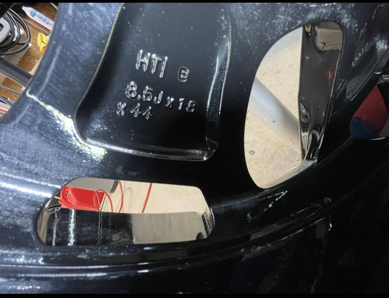

The offset on my Pro with the 18” wheels
Ford F-150 Lightning Wheel Offsets - I Need Help Understanding / Fact Checking IMG_8662
