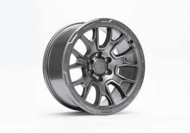

I am looking for a nice seat of wheels to put onto my ER Lariat. I REALLY want a set of these however I see a lot of posters saying to make sure new wheels are rated for the Lightning.
The Rousch site says they can be put on the Lightning, however I'm ignorant and inexperienced in such matters so I am asking you smart people for help.
If the wheels are not good for the truck, can you inform me as to how I would know if a wheel is good for the truck.
I'm wanting to put a set of Nokian Outposts on the truck and use the OEM wheels for my snow tires.
Thank you in advance smart people.

Divide that 4950 by 2 and each wheel should have that load rating
So 2475 should be each wheel.

Well thank you all. The nice, and I must say quite speedy, folks at Roush got back to me. Weight rating just squeaked by at 2,500 pounds per wheel.
