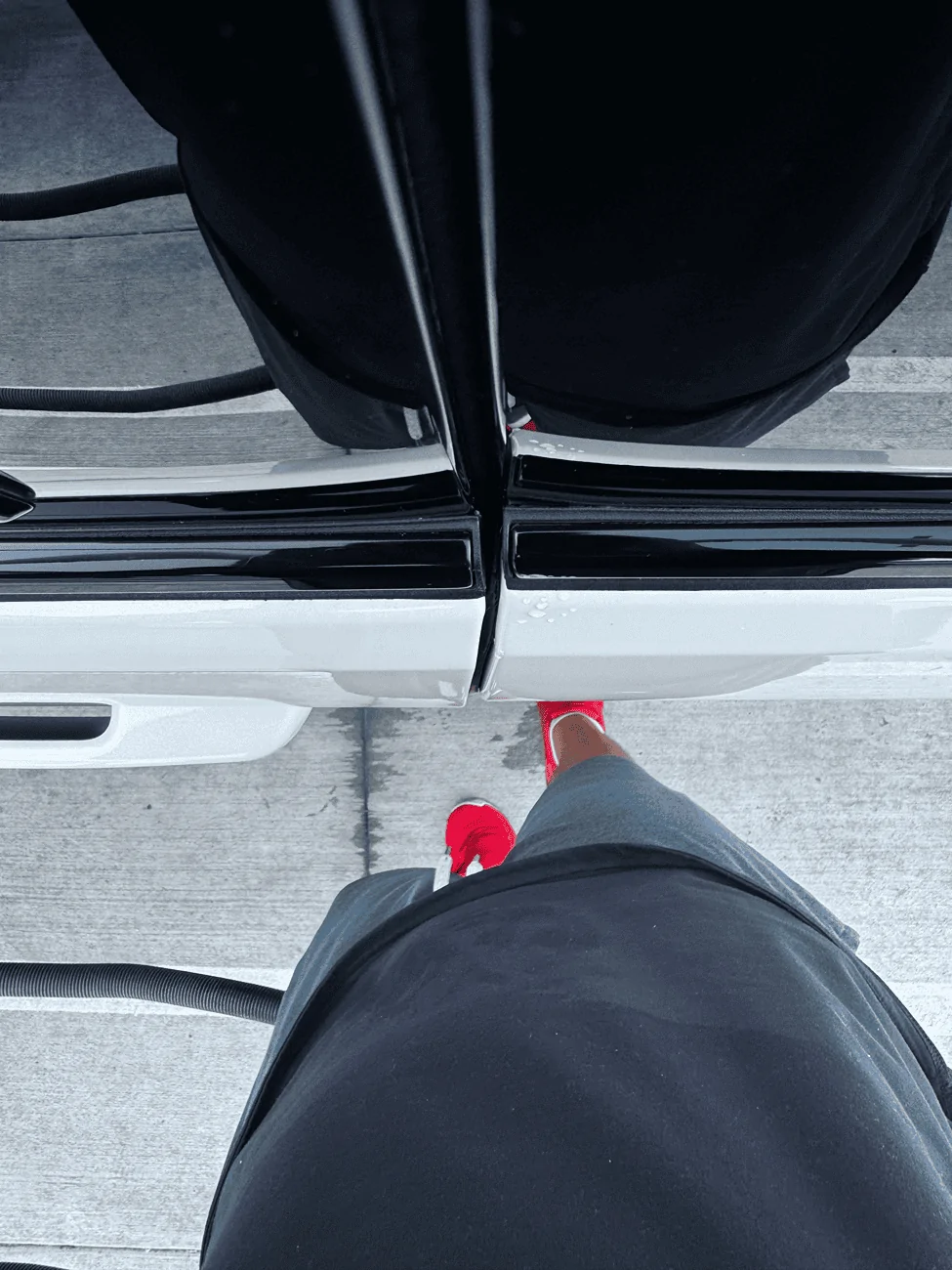

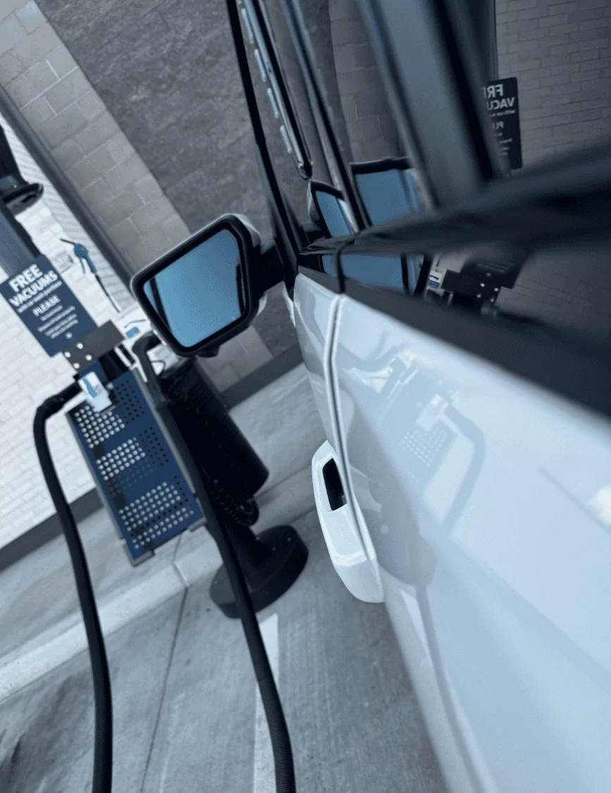

@mcrichardson Hey I am curious if you ever found a fix? My truck is in dealer for the same issue right now, should get it back this evening. Dealer said that it was going to body/collision shop for adjustments, so we'll see. I got the truck new a month ago and noticed the large amount of wind noise at higher speeds on the driver side. For comparison, I drive a ram 1500 laramie work truck that is quieter than my lightning on the highway. On my truck, I noticed the driver door protrudes out a bit more than the rear door. I am hoping the alignment solves the problem. I couldn't find any obvious weather stripping issues. Another issue I have is at speeds >70mph, I get a vibration from the window seal. If I push out on the window, it stops. They're looking into this too.

Just got car back from dealer. They removed door and realigned it. Results are that the driver door no longer bumps out beyond the rear door. Initial highest drive appears that this reduced the sound in the cabin. We’ll see on a longer drive.

our Lariat has the same drivers door gap as your picture and had similar noise issues at purchase which I think was dry door seal issues - truck sat on lot for 9+ months with only 50 miles on it - its improved since.
Would I still like the door gap fixed - yep - just not been a priority since. Many have also suggested a high end silicone style wipe on all the seals including moon roof to quiet the trucks.
