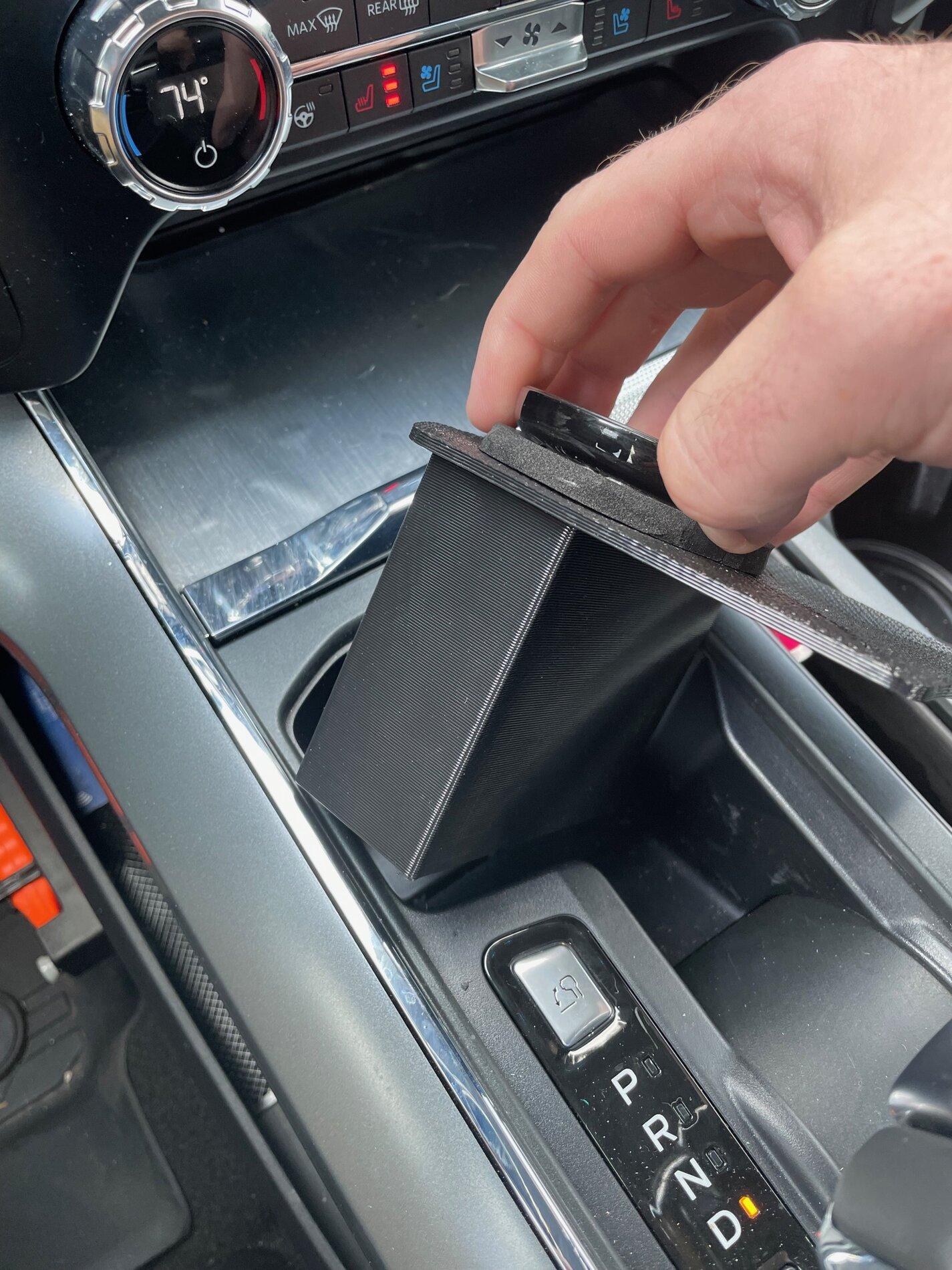

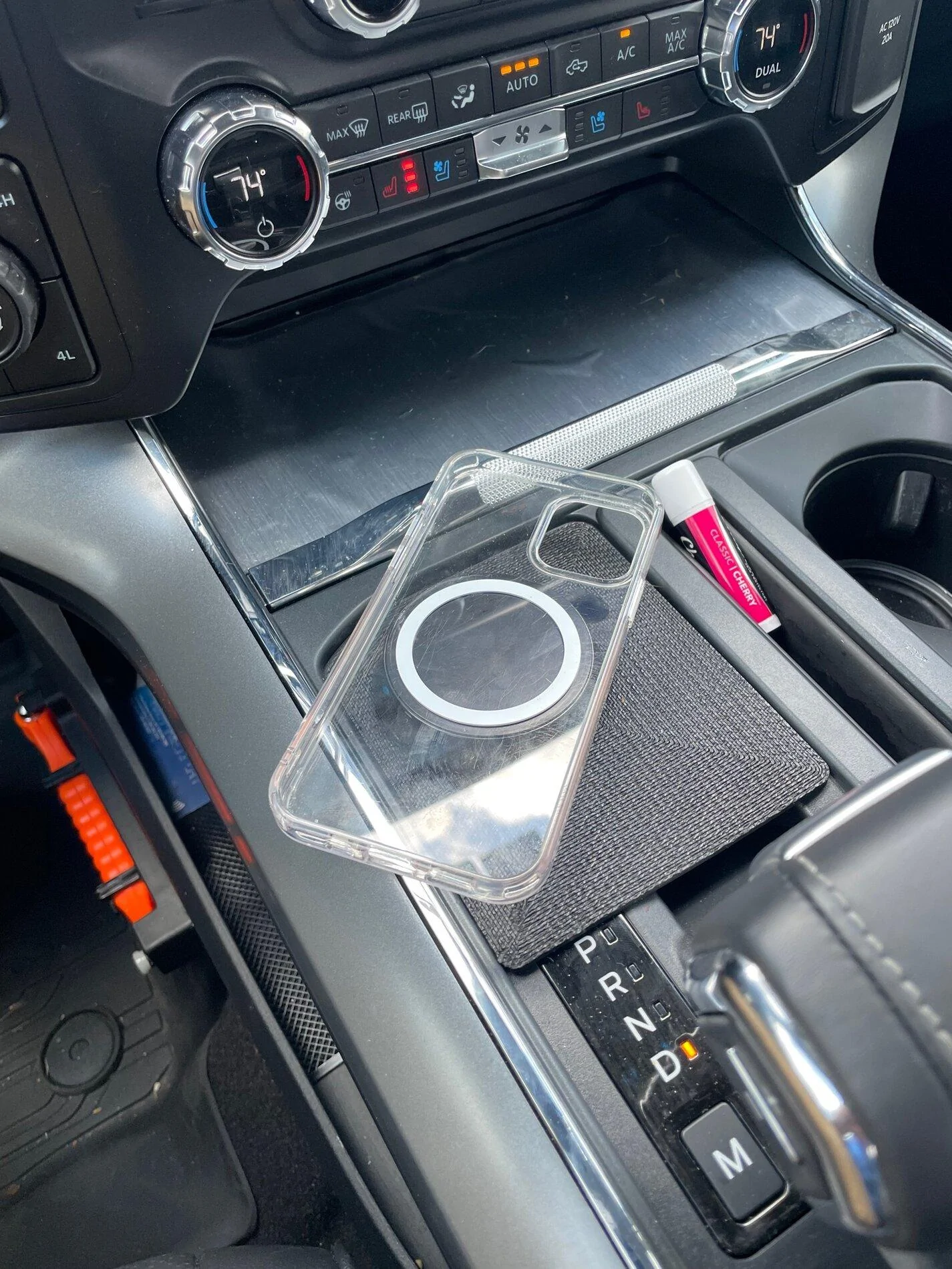

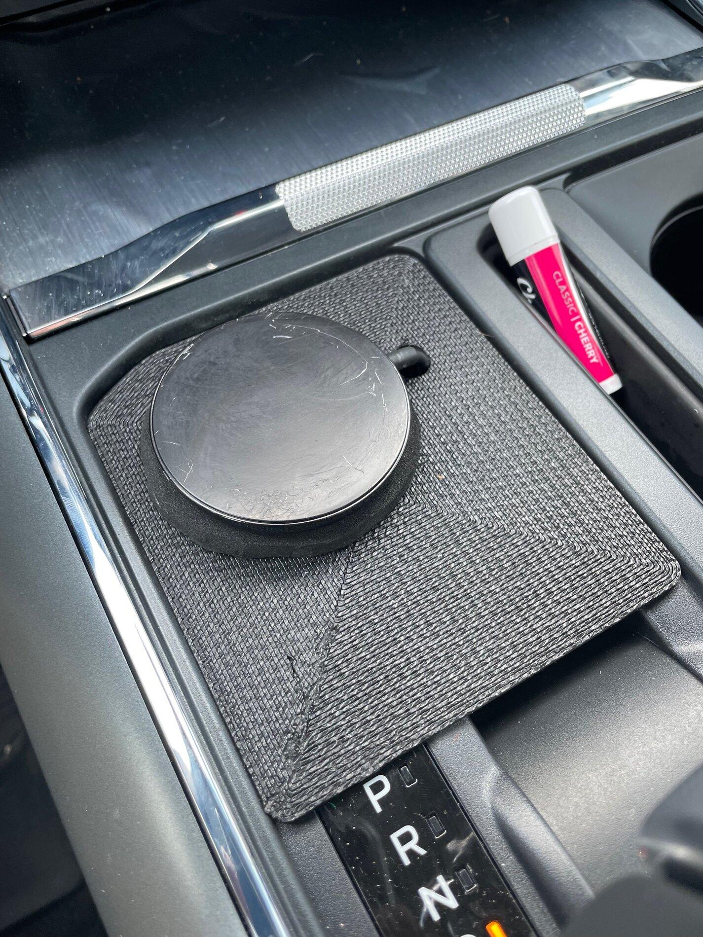

Thought I would share my solution in case it gives ideas to others. Since I don’t have interior work space, I never need to fold down my shifter. I also didn’t want my phone tucked away in the media bin or console because I will forget it all the time. I 3D printed a platter that slides into the shifter recess, then bolted a mag safe charger through it. The charger is powered from the media bin USB-C port.

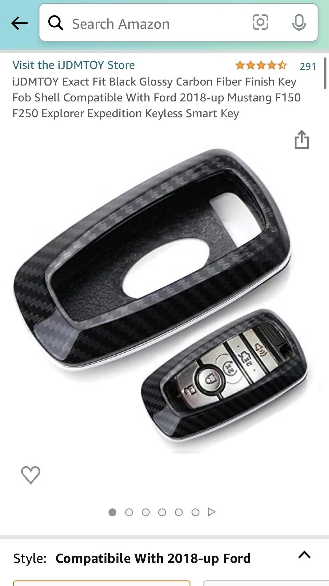

@Knickell hey, where did you get that key fob cover? I beem looking for a good one for ages

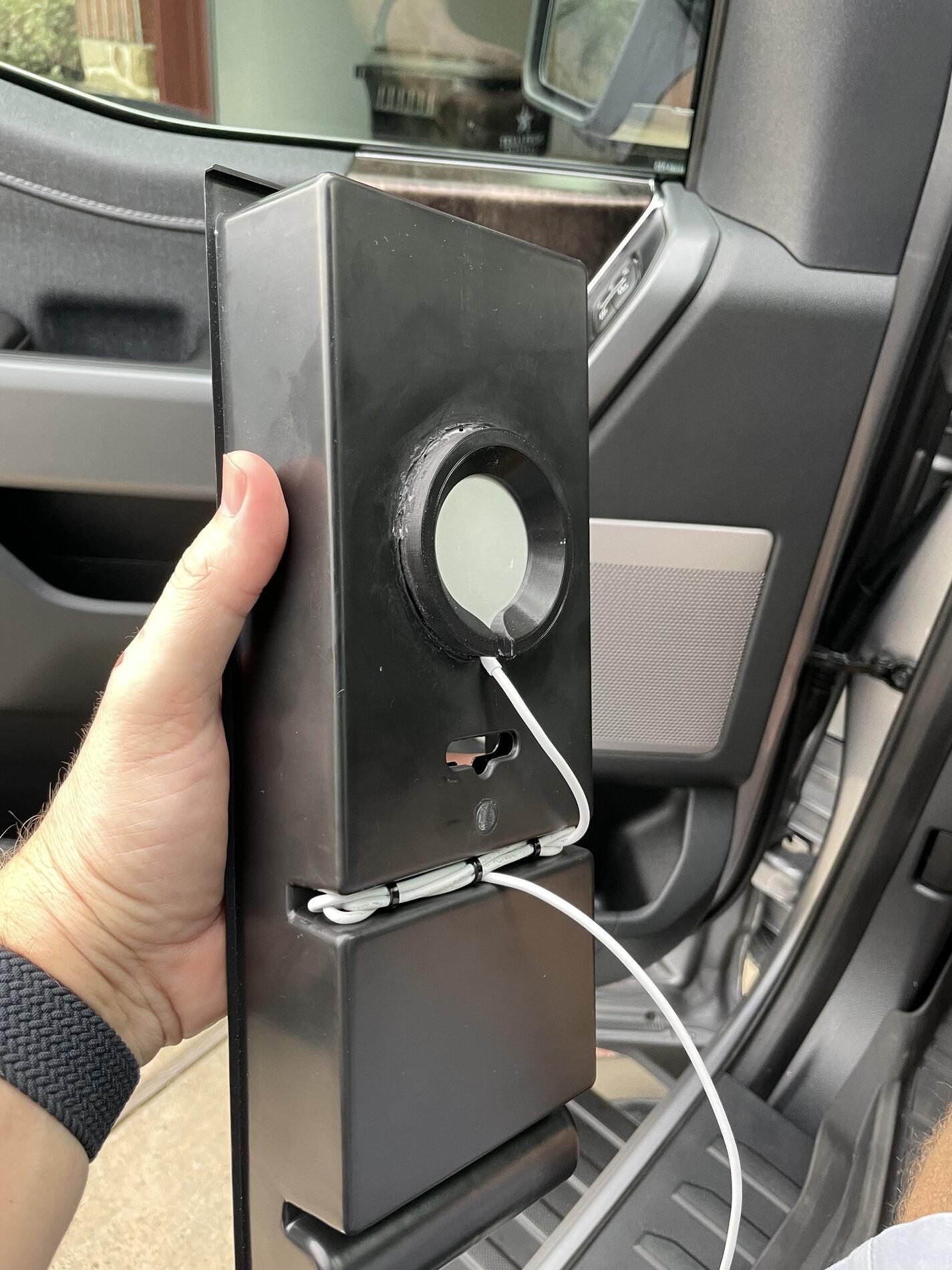

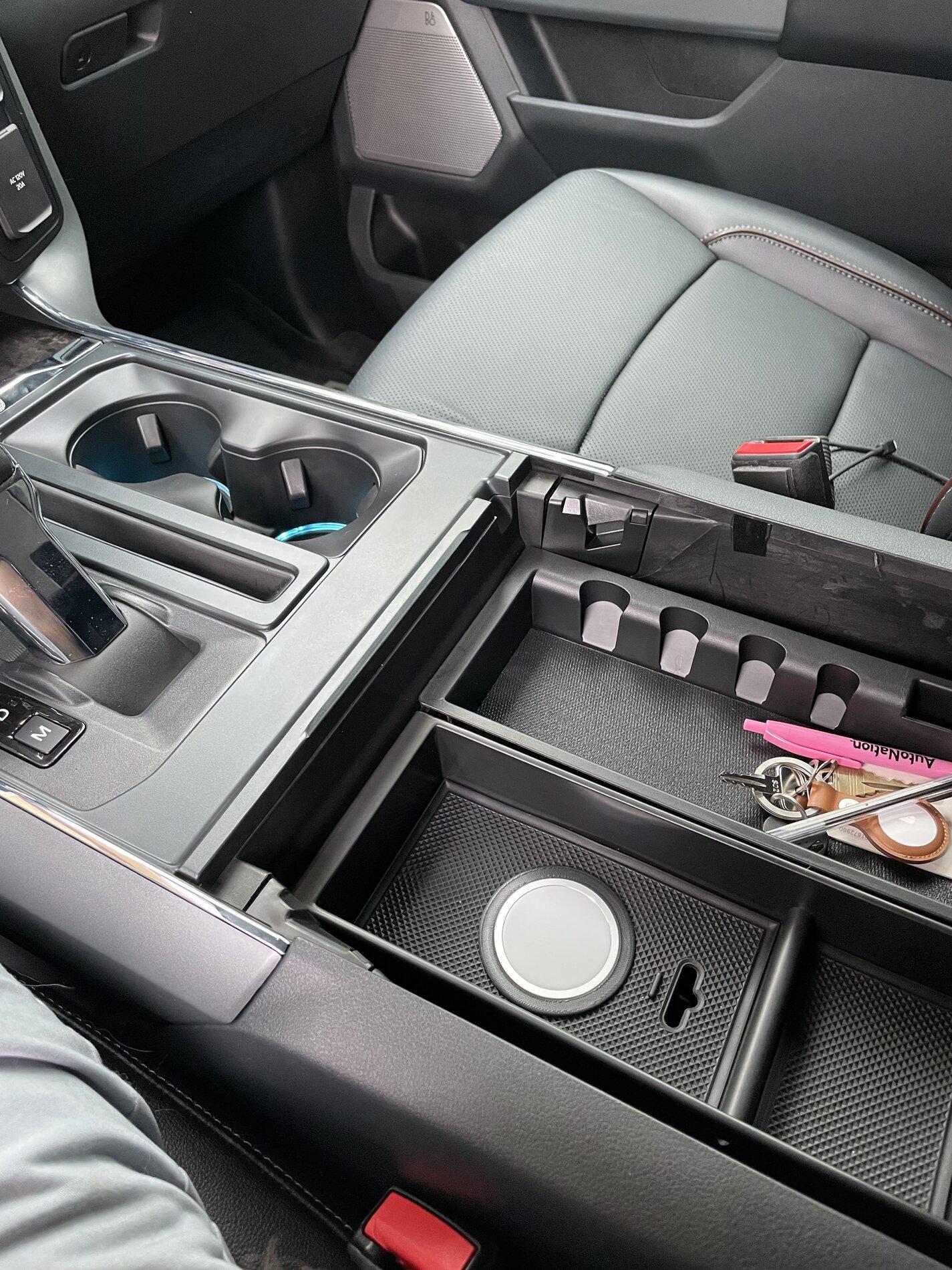

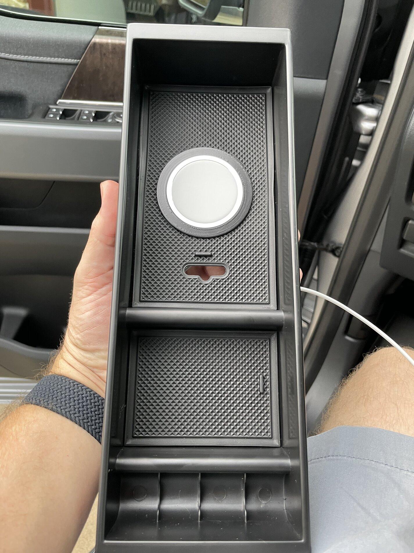

I just came up with a way to add MagSafe charger to the console. Same principle as the wireless charge you can get but that really didn’t work to good for me. I just bought a center console organizer, MagSafe charger, and an adapter to mount the MagSafe charger in from Etsy. Basically just drilled a 2.5 inch hole in the organizer, snapped the adapter in and put the charger in. I also installed a dedicated PD USB C charging socket that will allow for faster charging. Thinking I might get brave and do the same thing in the media compartment.

Looks good! Looks like you did intrude right way!
