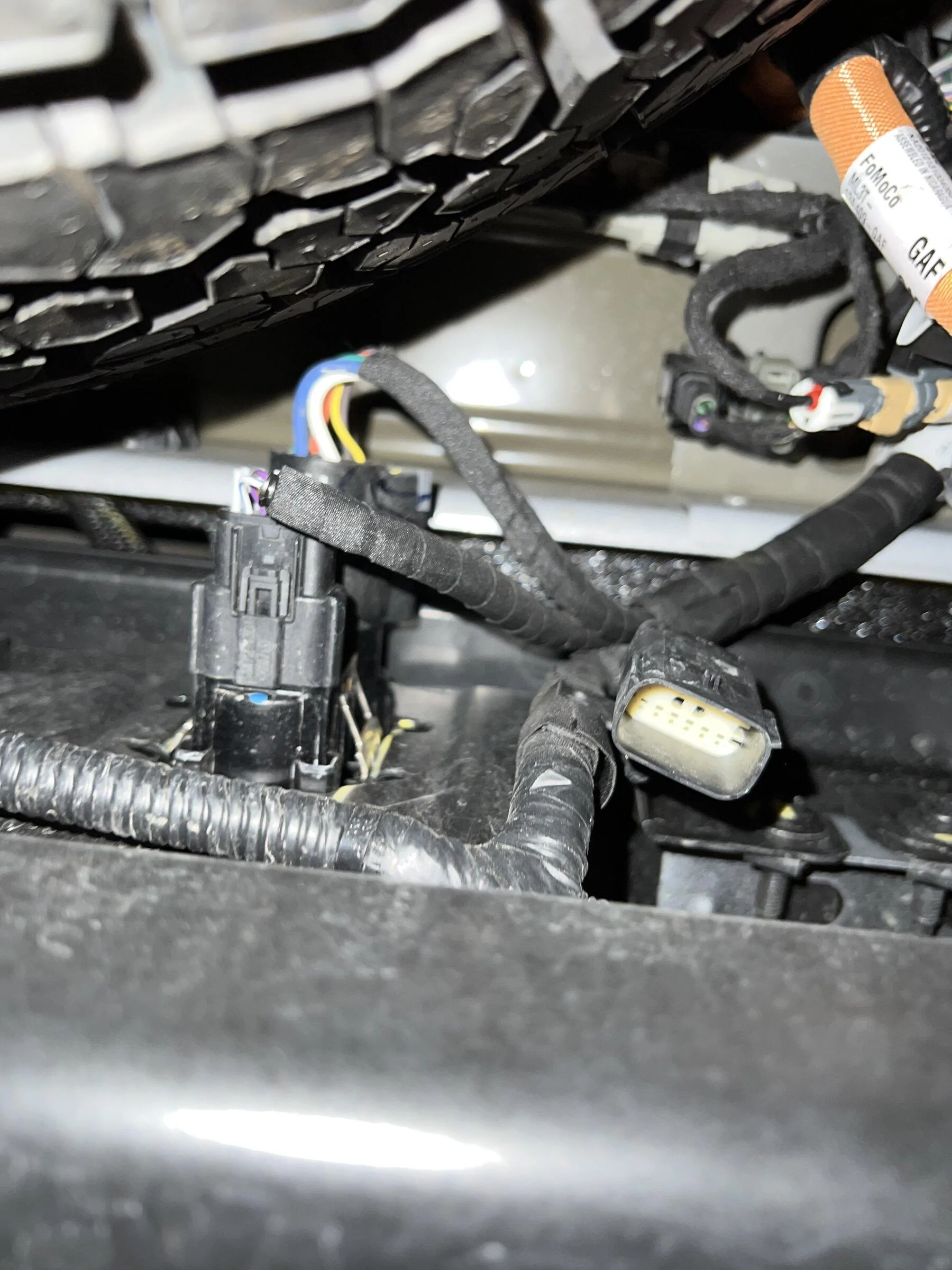

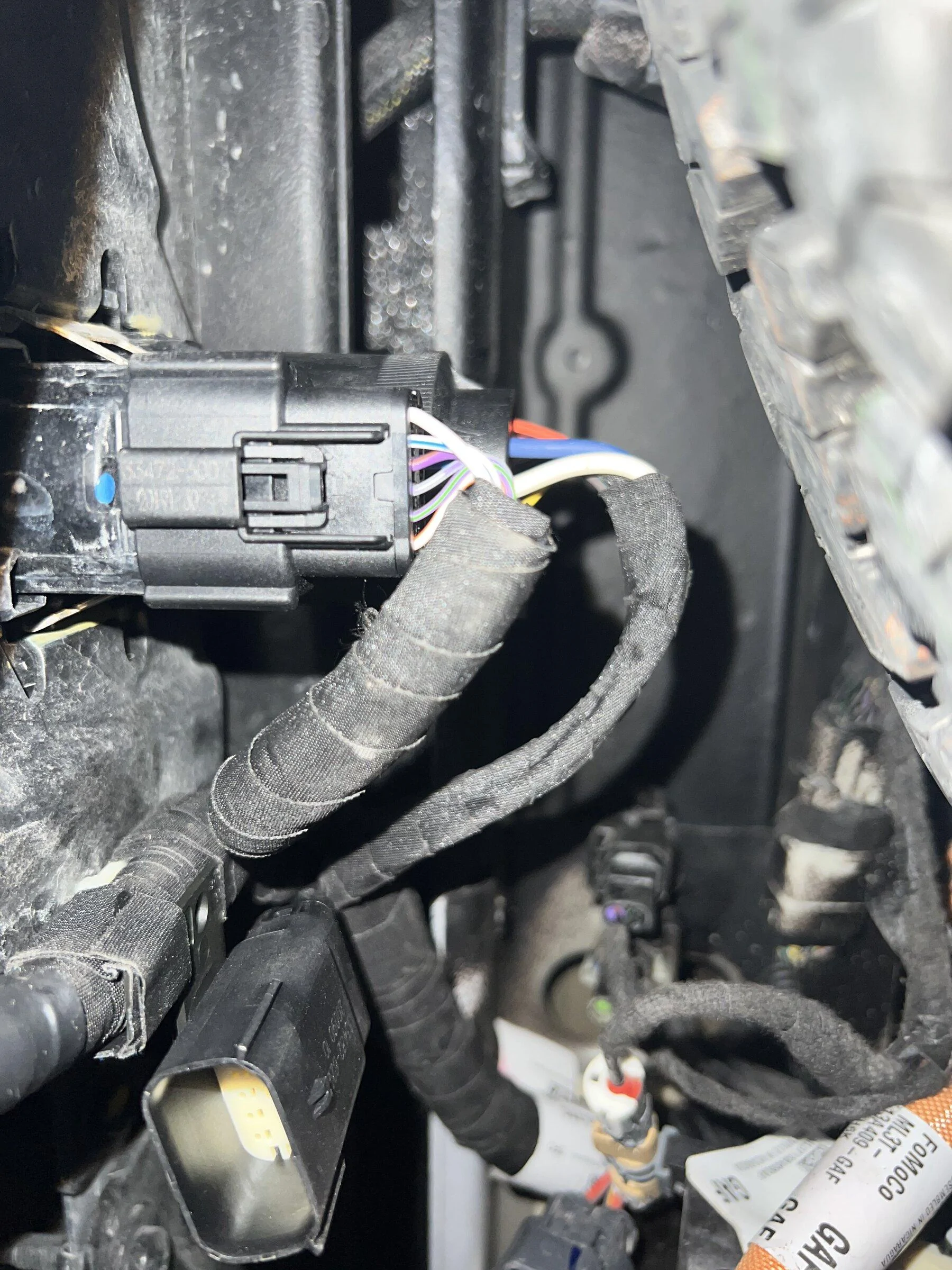

I think that I answered your question but just in case I didn’t, the following pictures side-by-side the “bus?” connector located by the spare tire. There are something like double the pins on the new connector. To be clear I don’t know what the actual pinout mapping per wire is, but IMO not worth time trying to build your own harness now that we can use oem supplied for $75-$150. I also just noticed one of those connectors is upside down relative to the other. I think this answers the question about whether ford went fully hdmi style digital and decode wire signal per device to share wires. They don’t and don’t appear to have any wireless protocol available for devices yet.

My question really was just on the 12 pin trailer "accessory" connector (the one below the normal 7 pin trailer lights connector). Where you plug in yaw sensor (if you have it) and where Trailer TPMS and Trailer Camera (as you verified on yours) connects.
The 2021 builds had 2 wires on the back side under the truck, and didn't seem to support anything but the Yaw Sensor.
You experimented with getting a F250 wiring harness for under the truck and it worked for you to support Trailer TPMS and Trailer Cam.
My 2022 has 8 wires as built. I believe (want to believe) that means my truck WILL support Trailer TPMS and Trailer Cam (and Yaw sensor if I wanted) as built, without me having to purchase/replace any wiring harness under the truck.
So my question to you was how many wires are populated in the F250 harness you used to plug into the back side of the truck 12 pin connector. I'm assuming 8, just like my factory built 2022 has.
If you already said that, I apologize as I missed it (reading manuals, forums, youtube videos I may be overloading my brains ability to retain!)

I crawled back under my 2022 and I definitely have 8 wires. The back of that connector has 2 horizontal rows of 6. All 6 on the bottom row are populated (see pic) and then 2 of the 6 on the top row (a black wire and a blue/orange striped wire).
