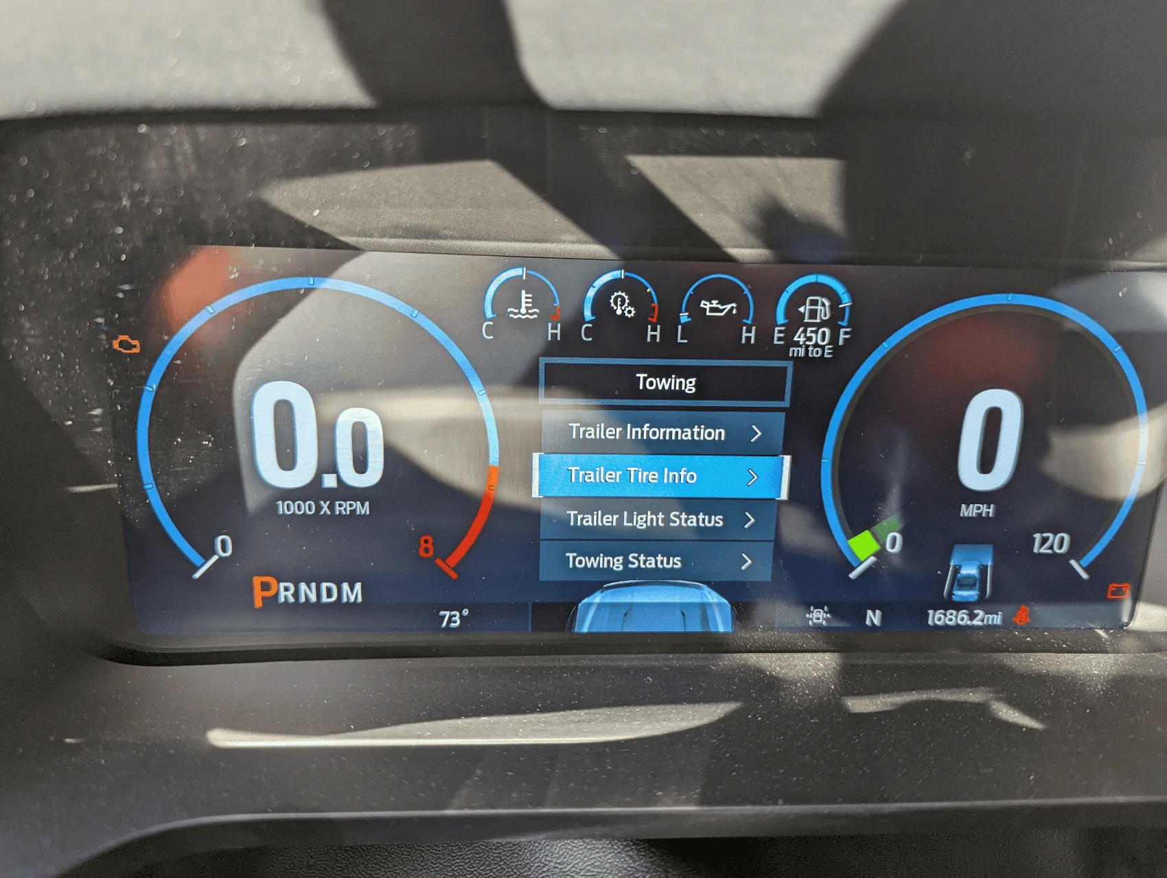

Where are the trailer tires shown in the dash menu? I have only seen the truck TPMS screen. I have a Platinum.
Towing / Trailer Tire Info

Huh. I don’t recall ever seeing that. I will go check - do you have to be connected to a trailer for it to show up?
Nope, no trailer connected. Here's the previous screen.

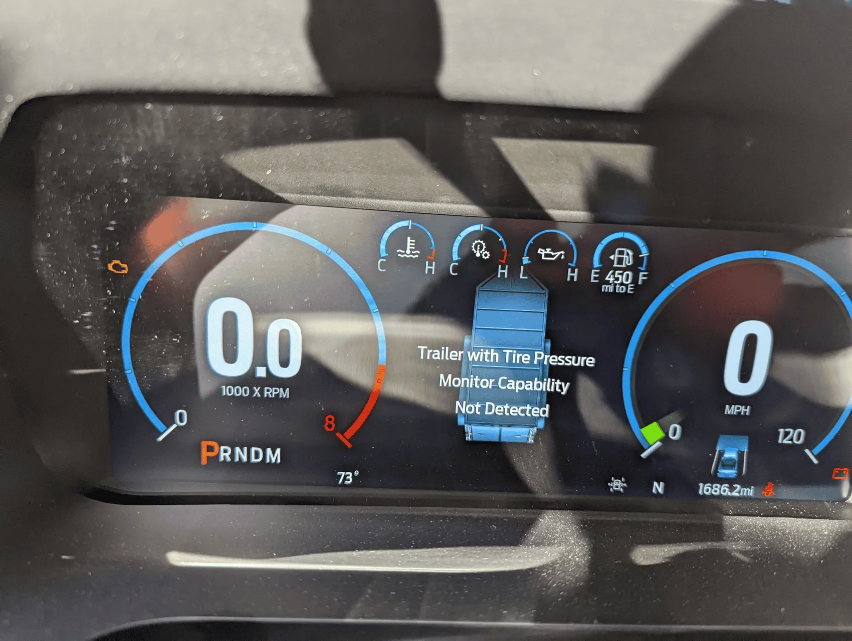

My XLT with mid level cluster has a screen for trailer TPMS but I get a similar message that such a trailer isn’t available.

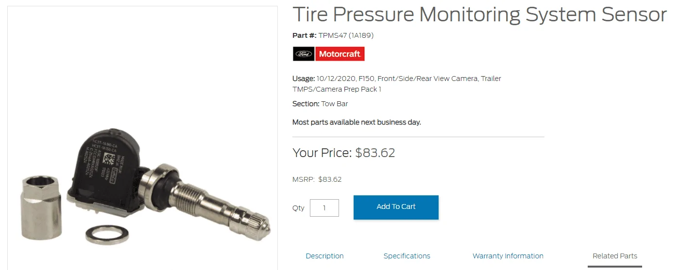

When I look up the part number found each cost about $84 but its unclear what, if any, of the related parts are required. I'll have to dig in a little deeper but am hoping this doesn't require the related parts since I am getting a tow package...$84x4 is already twice as much as my current TPMS. Also hoping there's no need for a signal booster connected to the trailer's battery like my current TPMS system requires.
Ford F-150 Lightning Do any F150's connect to TPMS on the trailer? 1639775010526
It all looks like the functionality is available. Would be interested to hear if anyone has it in operation.

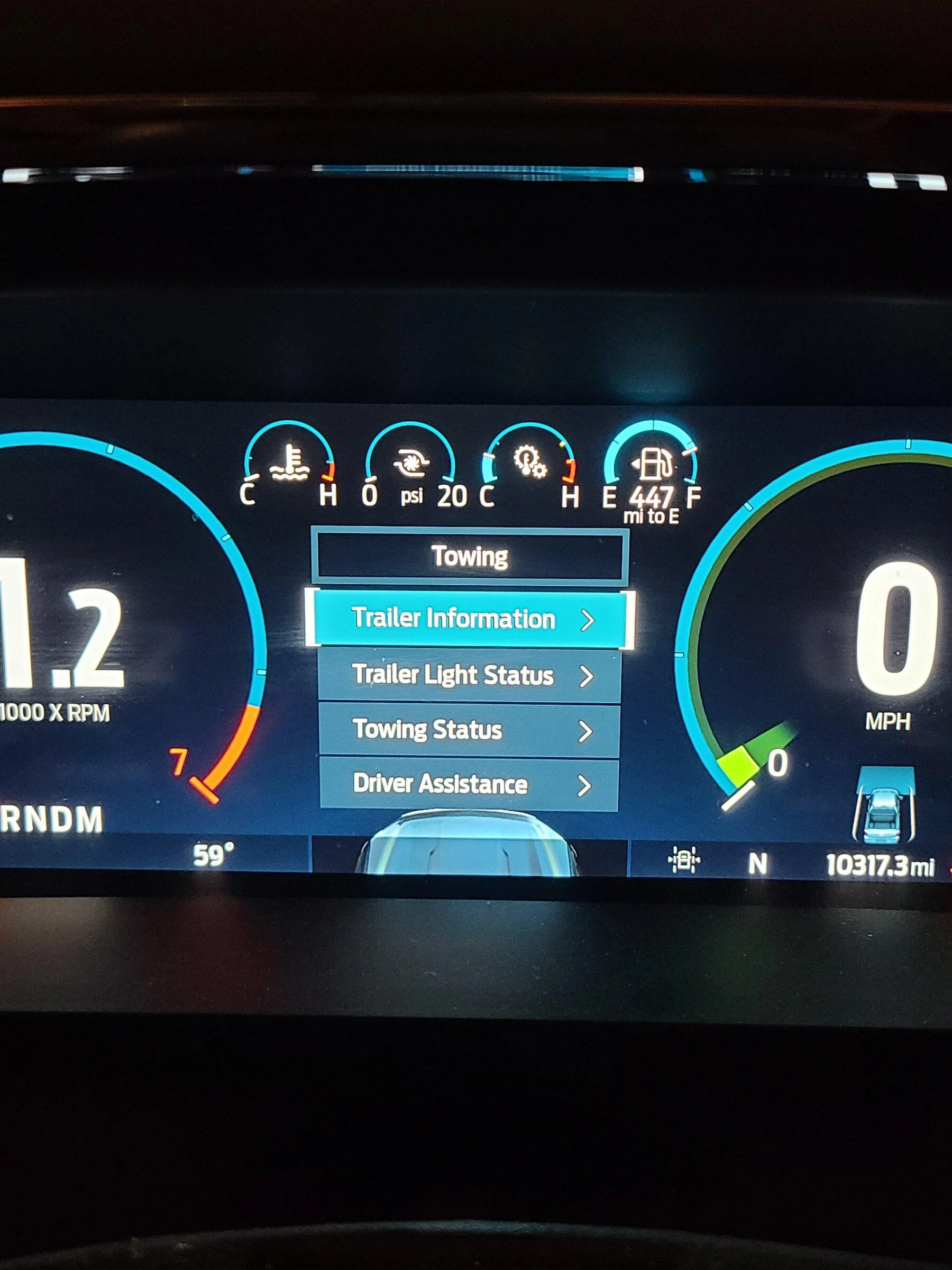

Wow! I most certainly do NOT have "Trailer Tire Info" in my towing menu, and I have towed a lot!
Ford F-150 Lightning Do any F150's connect to TPMS on the trailer? 20211217_132819
Regardless, I have my own TPMS with its own monitor so I am not too worried, just annoyed now I apparently don't have my dash software up to date!
