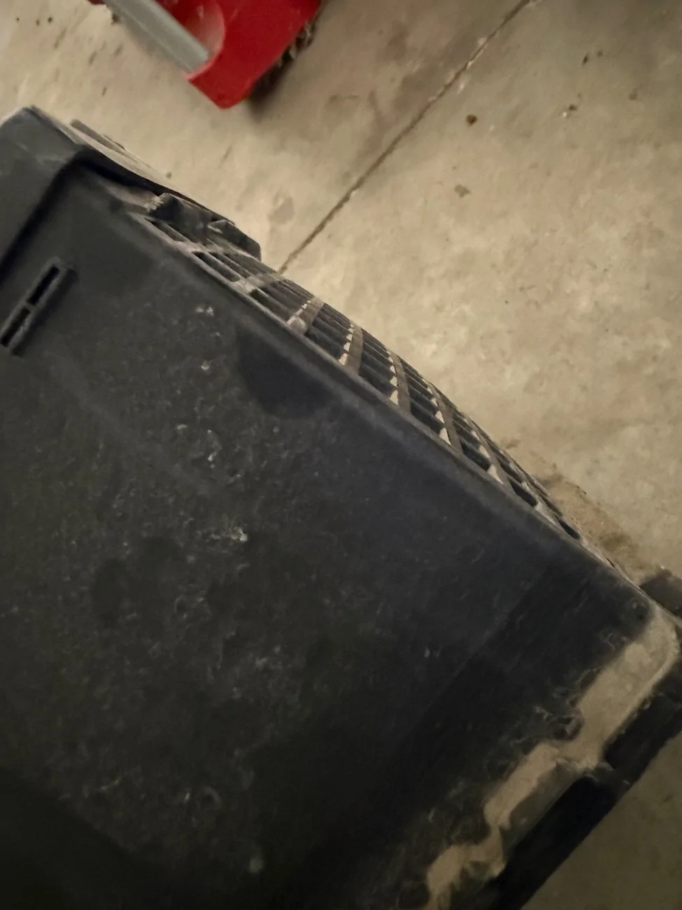

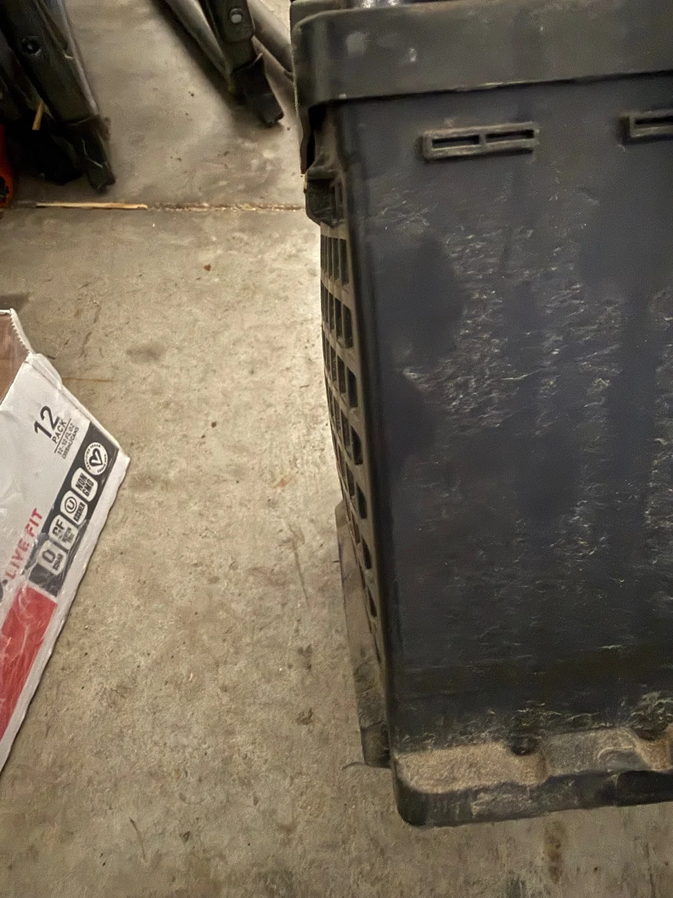

I bought a new Motorcraft BAGM-H3 in Jan 2026 (with a 11/25 mfr date) from RockAuto. This replaced the original from May 2022.
By April it was bulging on the sides and by May I was getting the usual 12V not charging issues. Frunk issues, alarm randomly going off, etc. Tested as BAD CELL today and working on a warranty return.
I was just going to go all in on the Diehard AGM H3-XEV with a little more capacity. Long story short, I ordered one for pick up and Advance Auto calls and says ours has a 12/24 date so we can only sell it as 'used' for $59.99 with a 90 day warranty.
I took my tester, headed down to AA, tested fine for a shelved battery. Put it on my Viking Digital charger/repairer and then installed.
Only part of a day but seems good and no bulging. We'll see if I got a deal but worth the try for $60 on a Lightning with 84K miles.
