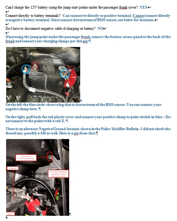

Has anyone had their 12 volt battery fail while getting the reprogramming recall performed at the dealership? My 2022 lariat lightning was being reprogrammed by the Tech at the Ford dealership, after 1st step of programming truck shut down totally due to the 12v Battery only having 8 cold cranking amps, instead of 330CCA. Did the programming kill the cells or does the battery only have a 34 month/39,500 mile lifespan?

Sounds like they can't read directions and didn't have a power supply hooked up. Those updates can pull 60 amps+ and the techs have a habit of not following procedures. Quite a few 12v have bit the dust.

There have been other scattered reports of techs mis-connecting to the battery and have havoc result.
From previous posts, they should either use the jump posts under a panel on the passenger side of the Frunk or like this (the blue circles not the red x's):
Ford F-150 Lightning 12 volt battery failure during recall where to connect neg for battery charger-info
