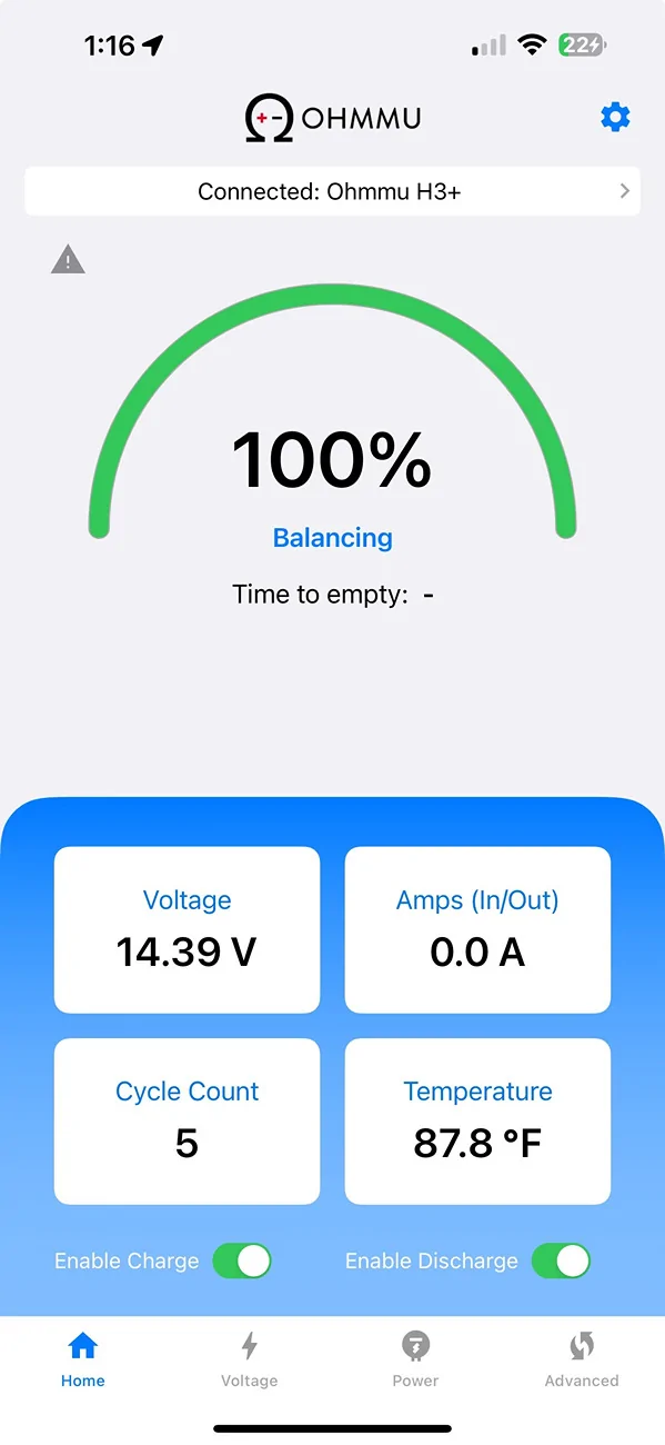

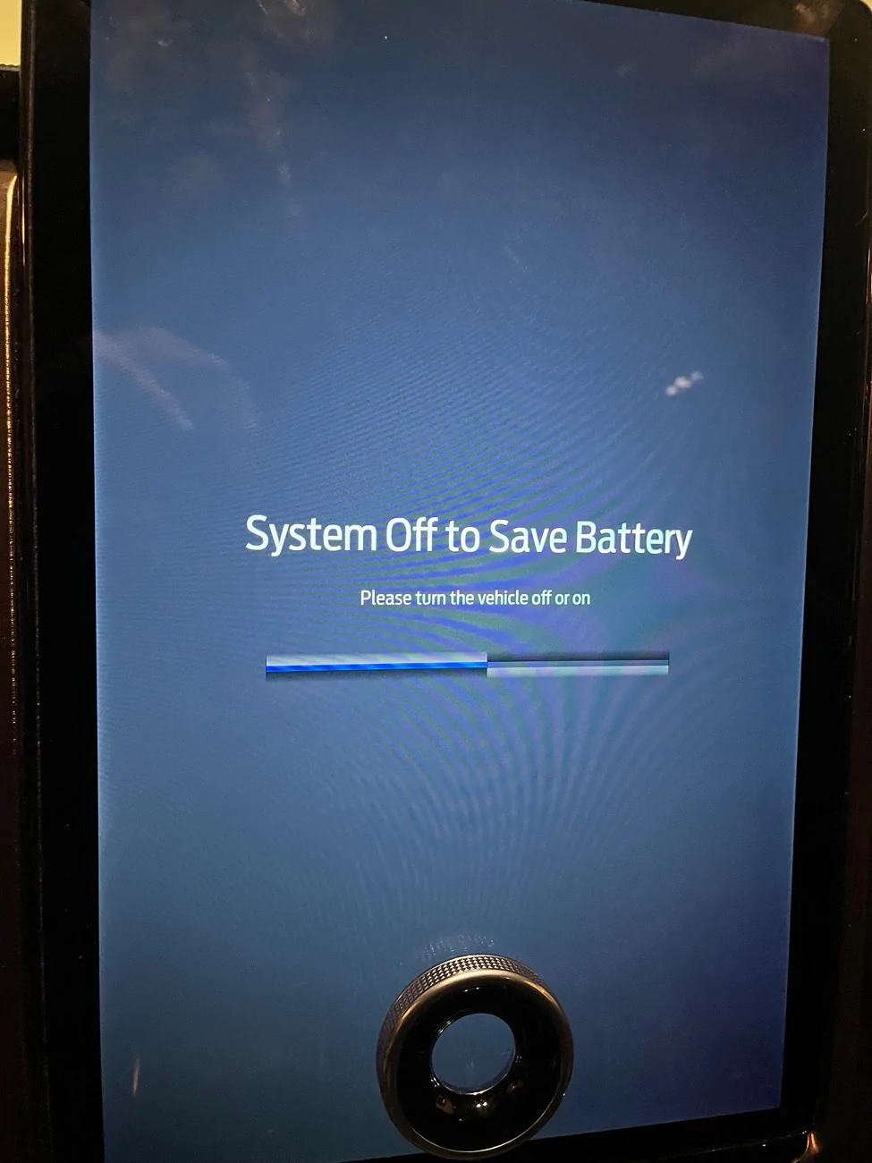

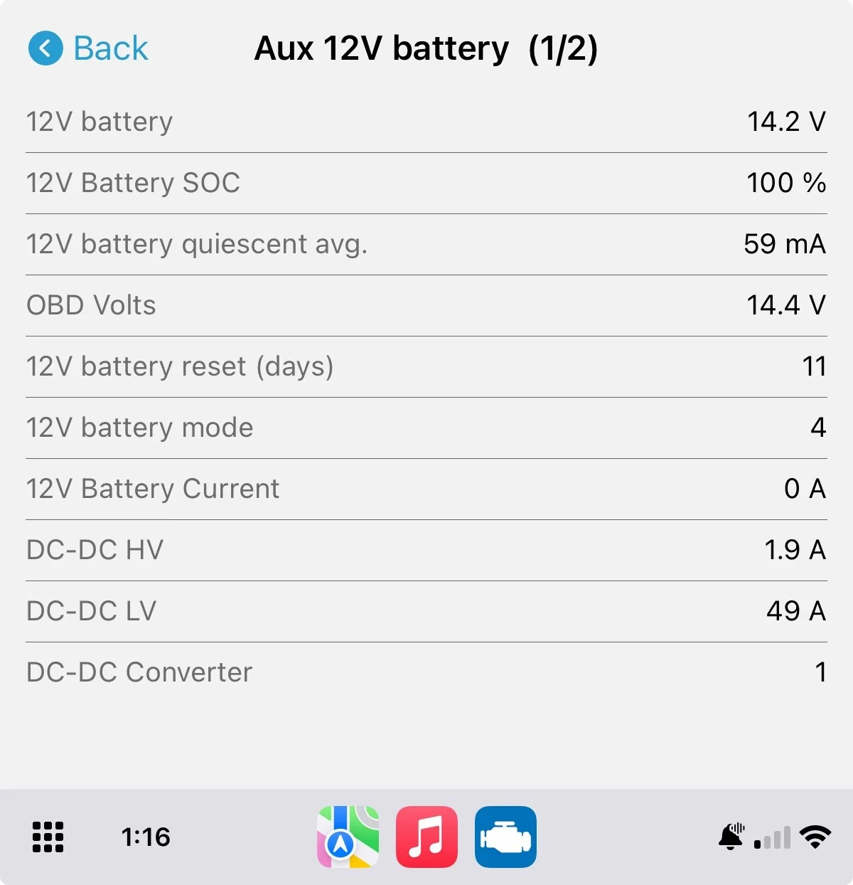

I was getting the weird sound issue and my interior lights weren't coming on when I opened the doors. My truck only gets short runs around town and sits for a week or two at a time between. So I figured better to just get the lithium battery for the increased capacity.
Just installed a Li-H3-BH today. While taking it out I noticed the OEM was 35Ah, but I couldn't find the capacity of the Ohmmu on their website. It says longer lasting, but what is the Li-H3-BH capacity?
I think the Ohmmu is rated at 40 Ah.
