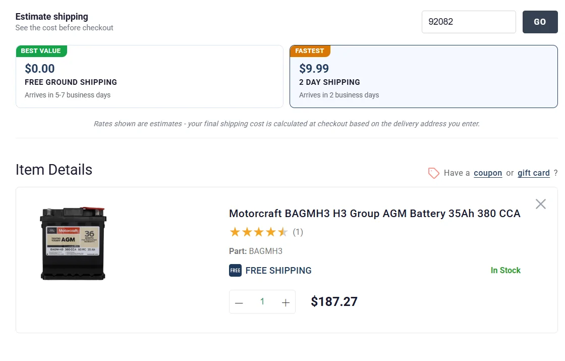

I quit buying Optima batteries for my on and off road vehicles... after they moved production to Mexico they just weren't the same and I was always replacing them. Found this Motorcraft AGM H3 online at a place called "AutoPlicity.com". Anyone have any previous experience with them?
Yep, same here. Used to be great - despite the higher cost. Stopped using them 15 years or so ago after a failure.
