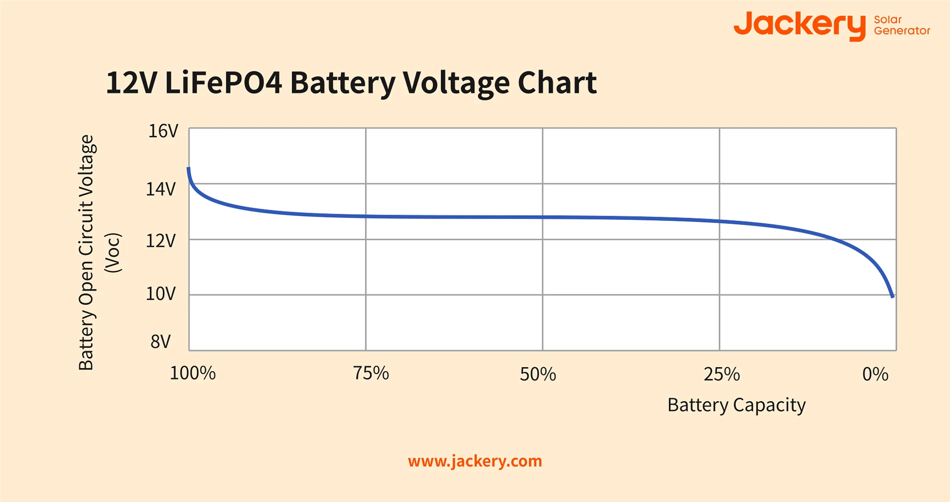

The voltages are close enough to not make a difference. The main difference being charge/discharge curves et al.
The top-end and bottom-end voltages are similar. But the voltage of a Lithium battery at 25% looks the same as the voltage of a Pb-A battery at 90%. So when the lithium battery is at 25% and is still providing a voltage similar to a 90% SoC AGM, the truck won’t think it needs to charge the battery.
Ford F-150 Lightning 12V battery replacement 12v_LiFePO4_battery_voltage_chart
Pretty flat discharge curve. I see your point now.
Glad the point made it somewhere.
A Li battery on an AGM BMS could easily be left in the 0% to 25% range. It is also likely never to reach full charge because a 100% SOC Li battery has a higher voltage than a 100% SOC AGM battery.
And because of the steep drop at the bottom end of the Li battery’s SOC curve, there could be very little warning that the Li battery is about to be dead. So a Li battery on a Pb-A BMS might only have ~25% of its Ah rating available for regular use. You might need a 70-140 Ah Li battery to get the same Ah of use as you would in the H3 in the Lightning.
Coulomb counting works much better for Li than for Pb-A and voltage measurements work much better for Pb-A than for Li (see your chart and the one I posted earlier). So the BMS charging strategy for the two batteries is likely different.
Again, this is assuming one just puts a random Li battery in place of the H3 AGM that came from the factory. If there’s a translation layer between the Li battery and the truck’s LVB BMS, that may mitigate this concern.
