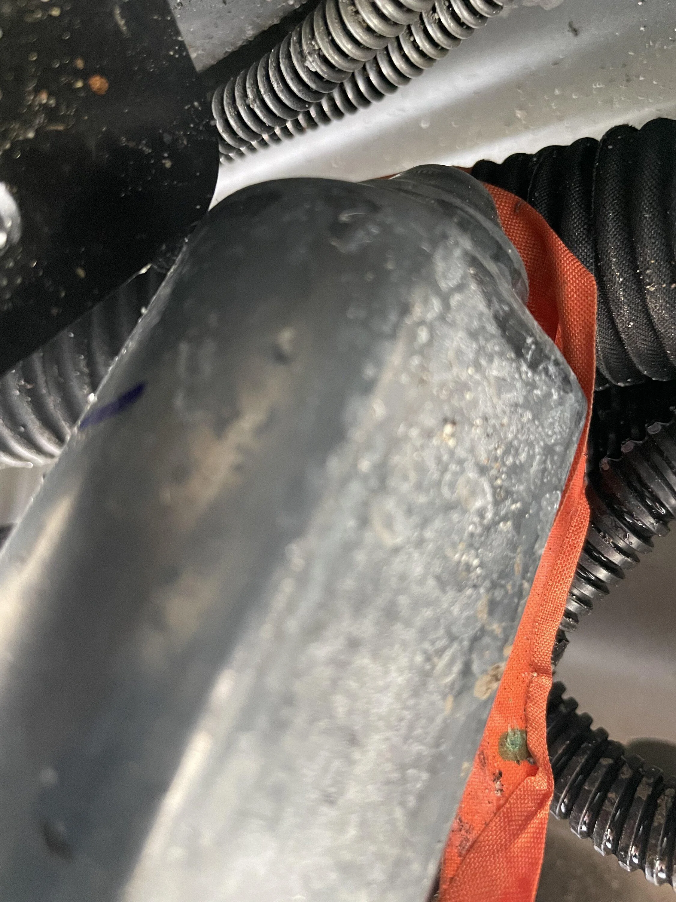

Truck looks great! Surprising results on the efficiency. Did you have any issues with the AMP step install? I installed the smart series and got rubbing on the front driver side with the step motor. I haven’t seen others with this issue though. (See picture)

As for the amp steps. They are the dual motor ones. I had to relocate the ABS module by drilling a new hole in the frame and also grind away a useless metal tab as well as push and zip tie the large HV line up about 1/4” to clear. Everything else was plug and play.
