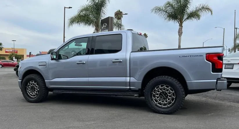

Motortrend tests range impact of off-road wheels and tires on Lightning XLT Extended Range.
Wheels are Raceline 955M Warp aluminum wheels (20x9 +18mm offset) and weight 33 pounds each.
Tires are Mickey Thompson Baja Boss A/T (extreme all-terrain category) in the factory stock size — 33x11.0 inches — weighing 47 pounds each.
Down Range: the Impact of Off-Road Wheels and Tires on the Ford F-150 Lightning
We find out how swapping aftermarket wheels and tires affects the Ford F-150 Lightning.
https://www.motortrend.com/reviews/2022-ford-f-150-lightning-wheels-and-tires/

Old thread but I never replace stock rims... except I really like these Raceline Warps on the L. These have a great look for this truck
