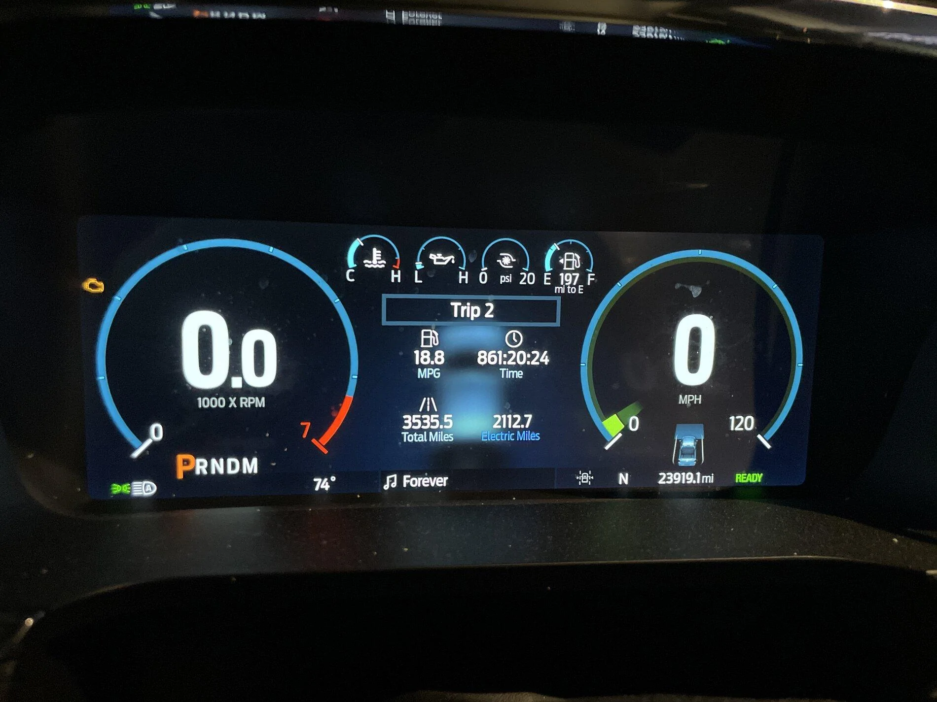

Can we enable digital temp readings on engine and transmission on 302A xlt trim with traditional speedometer and rpm gauges?
No, nothing to enable them on the mid-size 8" cluster has worked

I only have 6 of the 10 cards but the image he has is not using FORScan the way you have us doing it. I tried looking through the APIM sheet but couldn't find this or looked at it and didn't know it.
I would love to enable all 10 cards vs. my 6.
APIM 7D0-01-01 xxxx xxx* xx-- 4=ten presets, 0=six presets, 2=5 presets
APIM 7D0-01-03 xxxx xxxx xE-- enables Trip 1/2, Fuel Economy, Zone Lighting
if you search my APIM spreadsheet for "IOD" without quotes you'll see the cards that can be added.
Note: after making the changes above go into the wrench icon in FORScan and choose APIM reset and run that to make the changes visible immediately.

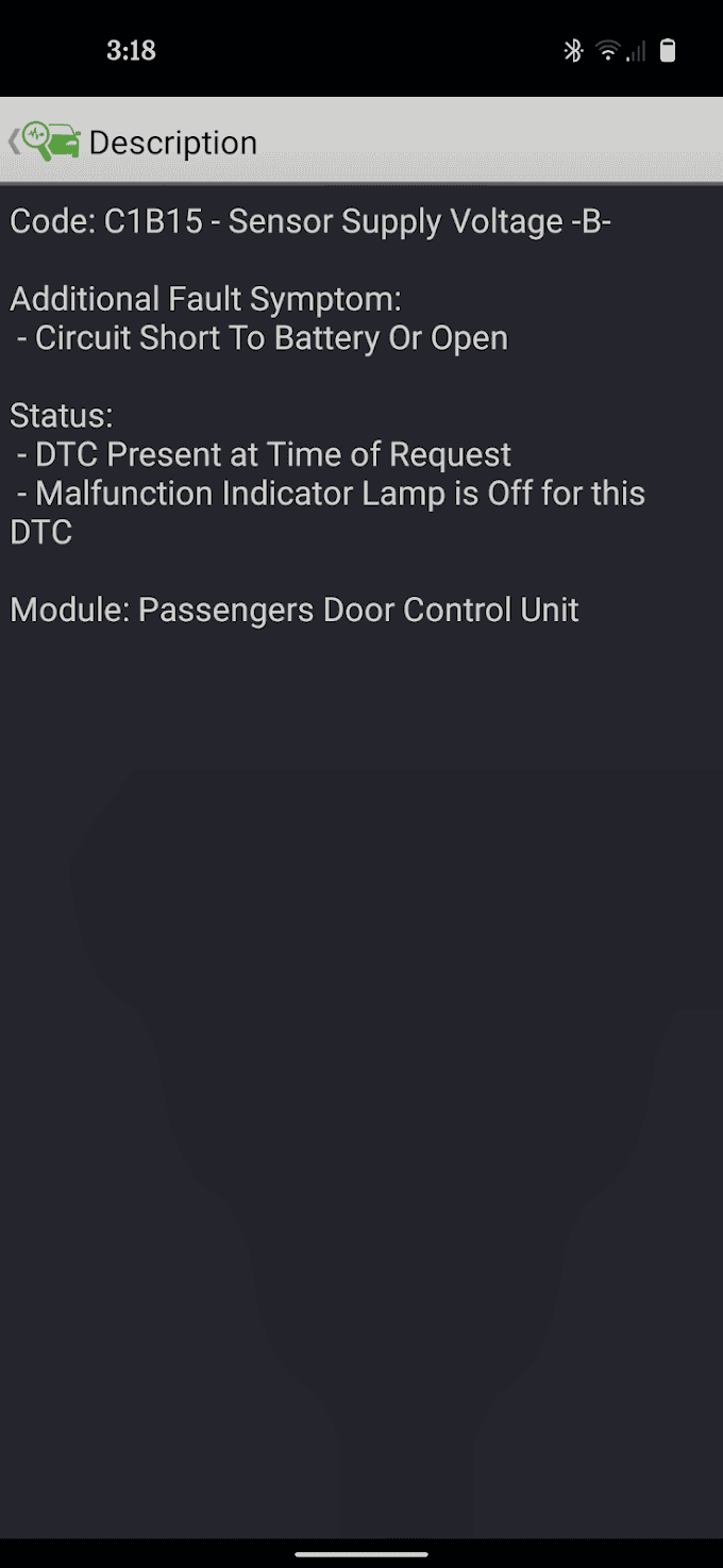

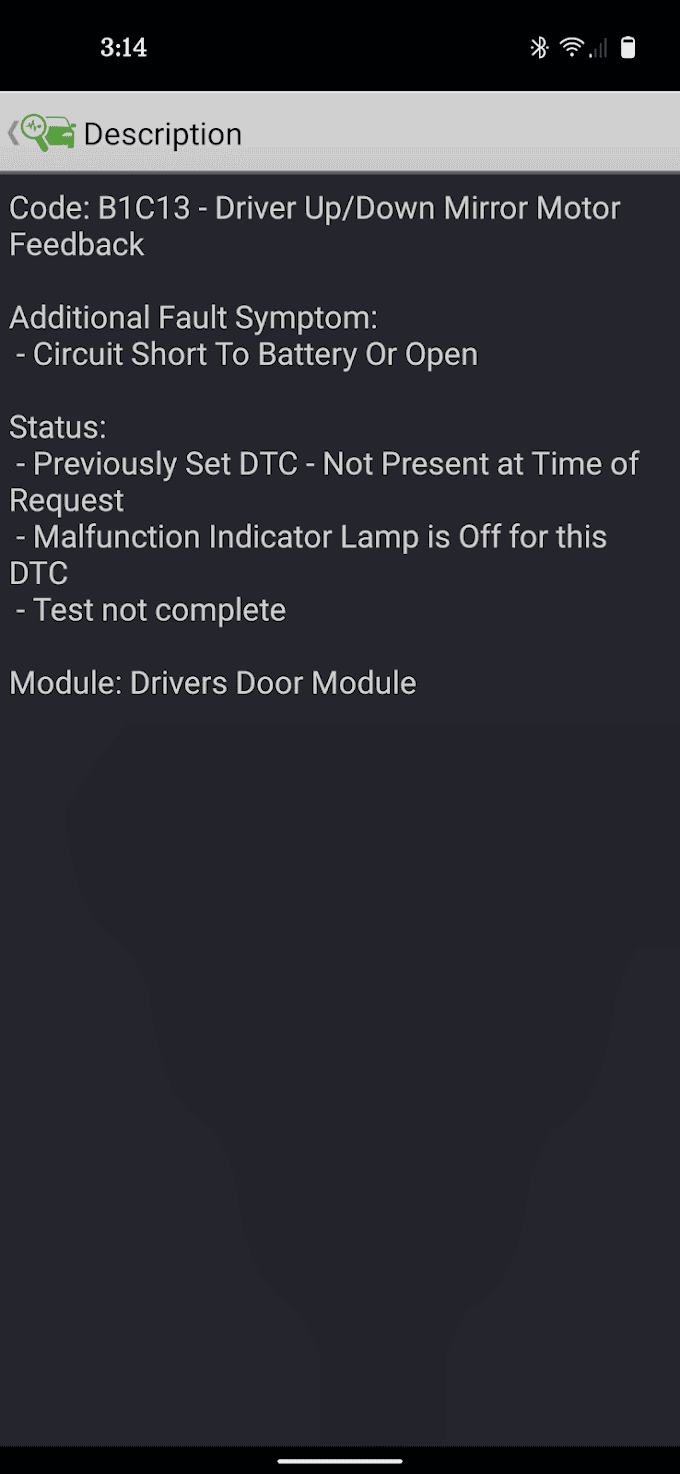

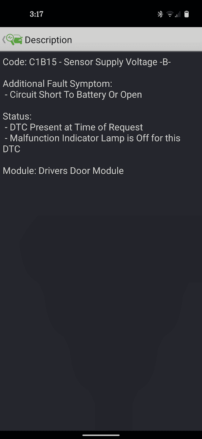

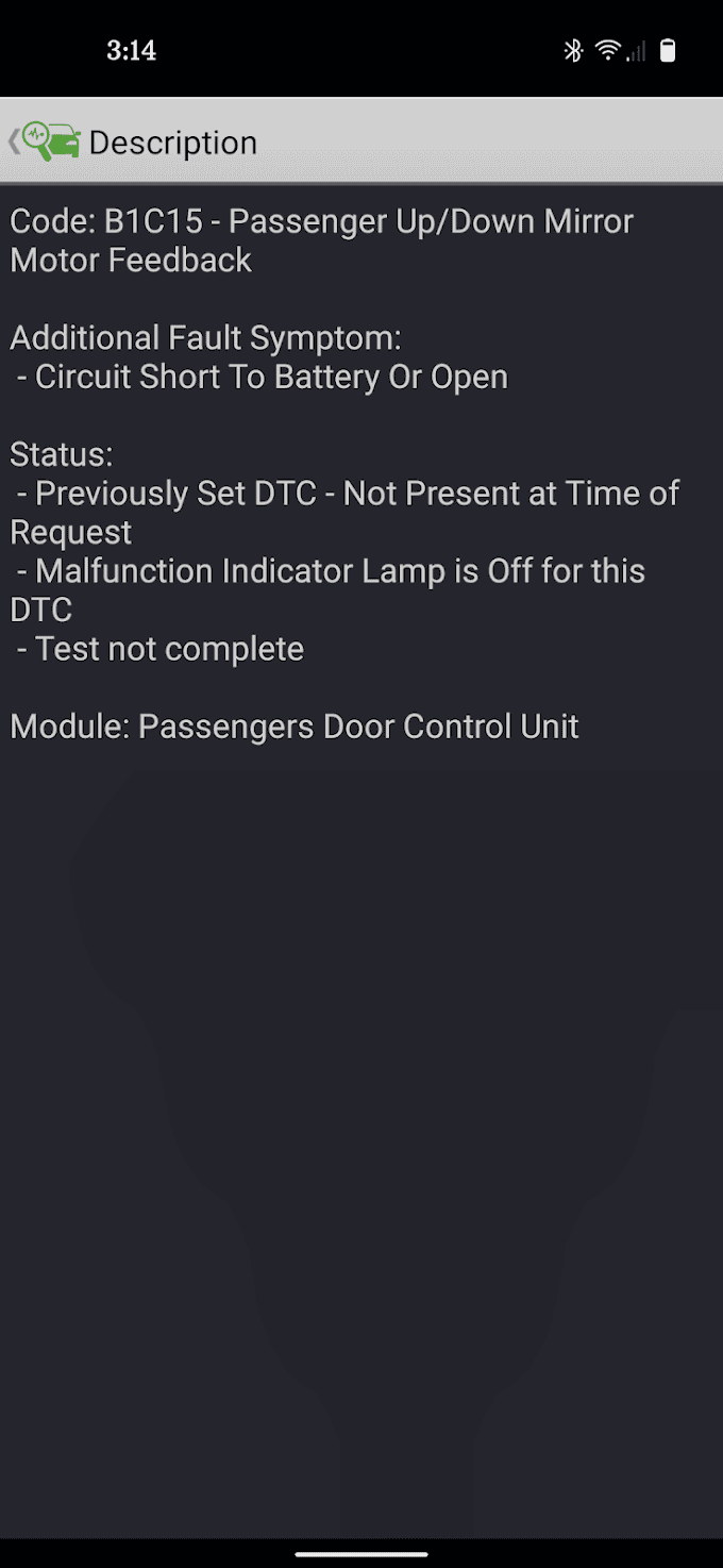

Hello again @Livnitup I replaced my Lariat high mirrors with OEM factory tow mirrors for the 2021. I got a hold of the ML3Z-17696-CA mirrors. However, upon install, BLIS and zone lighting work, but power adjust does not work correctly. It will only adjust left and up but not down and right. Same issue on passenger mirror as well.
Incidentally it was the exact same issue when I installed aftermarket 2018 tow mirrors on my 2021. I subsequently purchased the OEM ford 2021 mirrors but same issue.
Could this be related to a mirror unit re-sync/re-initialization issue? Can forscan help me reset the mirror controls?
Sentinel1201
Jun 5, 2021
188
DFW
2021 F150 Powerboost
Here are the error codes I pulled using forscan:
Ford F-150 Lightning 2021+ F-150 FORScan List / Database / Spreadsheet ? 8AB06DFA-6175-4117-8E92-1B83E06658DD
Ford F-150 Lightning 2021+ F-150 FORScan List / Database / Spreadsheet ? 289D1E95-412F-4CDA-831B-5B5A67BEA541
Ford F-150 Lightning 2021+ F-150 FORScan List / Database / Spreadsheet ? B9FE594C-A83E-47D6-9A61-277C937ABE76
Ford F-150 Lightning 2021+ F-150 FORScan List / Database / Spreadsheet ? B993F96F-9DD3-48A6-9FBB-1C8E9F06C4CC
Message me your VIN and I'll compare your DDM/PDM values to mine to see if there's something that needs to be changed for the tow mirrors.
