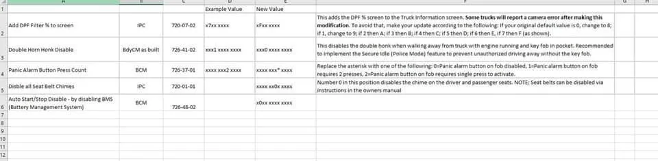

Used the same method as the last Gen and got the dpf sceen to show. Mine is 21 Platinum 3.0. No error codes yet.Message me your VIN so I can pull your asbuilt values and I'll give you some stuff to try

I got rid of that double horn honk. I can now get out of my truck and leave the air conditioning running for my dogs and gointo the store and come back out!Really want to disable the double honk, camera speed, and make the rear LED running lights on all the time like the front ones are (to match).
Have you ever played with the ACM at all?I've started adding FORScan spreadsheets here for anyone interested: https://bit.ly/3cJnYMS
Currently the newest version of FORScan can only change the BCM and 1/3 of the IPC (cluster) versions so when that changes I'll add the other modules as well.
My FORScan tutorial is here: https://docs.google.com/document/d/1-8dKaS_Spu4Zw4hV_CrKC4tLoP9G8yejqegF1wxIqxY/edit
