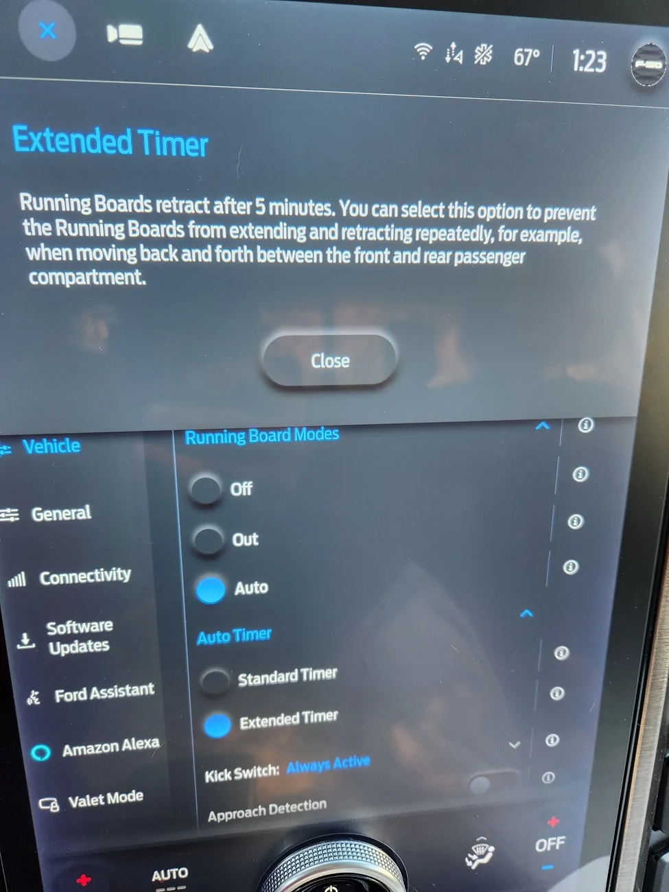

The only setting for the boards is Auto, Extended, Off (something like that) where you can tell them to always be extracted. Maybe what that RAM had set, or tell them to not respond at all.

Aww man, I guess I wasn't digging down far enough into the options. Thank you! I set it to extended and did a trial run of my usual passenger door --> close --> driver door and the boards remained out.
Thanks again for taking the time to put the picture up!
You can change the settings to stay deployed for 5min. That gets rid of the retract/deploy when for WAL.

np. That drove me crazy when I had the dealer update my BCM to enable WAL a while back. Now if they'd just give us a way to delay locking. Can't even walk around the truck without it locking most times.
