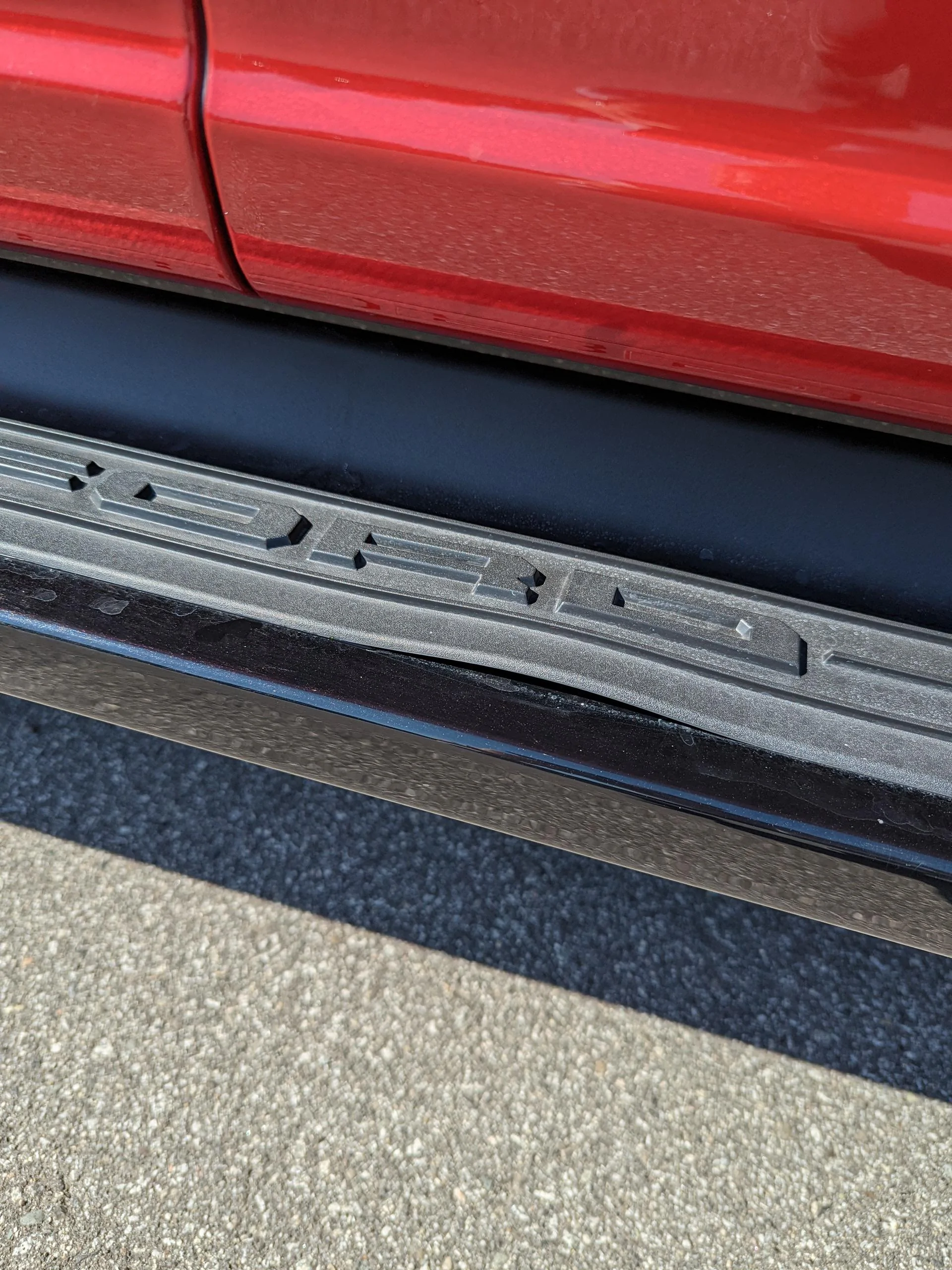

Same issue noted on delivery day. Passenger side so far.

Ok, so my dealer asked Ford about this and they suggested that if the dealer compared it to another unit and found the other unit to be similar, then it is normal. My dealer’s mannequin has extensive delaminating on both the passenger and driver’s side. Of course they didn’t find this ā€œnormalā€. I told them to compare it to the unit attached to the driver’s side of my truck (which is currently still intact). This they did and submitted an order for a new running board for my passenger side. Of course, the part is on back order, so we’ll see how long it takes to get repaired.

Pointed out my passenger’s side running board delaminating to my dealer back in August….still waiting on the replacement ??

I am the one who started this thread. I just received replacement running boards from the dealer and they are not delaminating at this point. It did take a while because apparently they were on back order for a while.
Good luck to all on getting replacements!

The replacement for my passenger’s side was on order for 3 mos….they arrived 3 weeks ago…scheduled for replacement just after the first of the year along with my charging port that occasionally errors out when DC fast charging……..

My dealer received the replacement running board about three weeks ago and I have an appointment in two days to have it installed. They are also going to look at the active air dam which keeps giving a fault and do the 10k routine maintenance. Hopefully the new running board holds up.

Just noticed my passenger side running board rubber top delaminating. Raising a bit in the center of the material.

I just noticed last week that mine are delaminating as well. Sure to get MUCH worse once winter starts and freezing water gets under there lifting them up more.

I have a 2022 XLT, delivered August 2022, and noticed my passenger side running boards are starting to delaminate. I’m at 25K miles and I ’ll show it to dealer when I go in this week for the battery CSPs… but dang these running boards are still an issue.

I am the first poster on this thread. Mine were replaced a year and a half ago and have been fine since. This is a known defect going way back and yours should be replaced with no argument.
