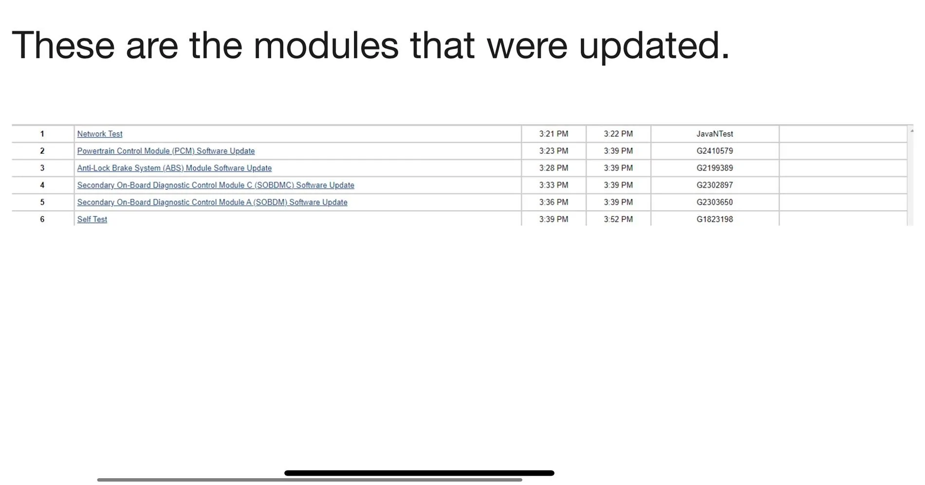

Just got the CSP update via Ford Mobile when I get home I will charge to see if I can add the target because supposedly this update fixes it
jamelski
Aug 11, 2024
211
316
Sacramento
2024 Lariat
anyone who is having the target charge issue this indeed fixes the problem you must charge wherever you want just for a few minutes like it should’ve always been unplugged. Give it a minute and FordPass will then allow you to set your target. @Ford Motor Company it worked ?. Hopefully anyone who has a dealer that does mobile it took maybe 20 minute software update from the tech.
