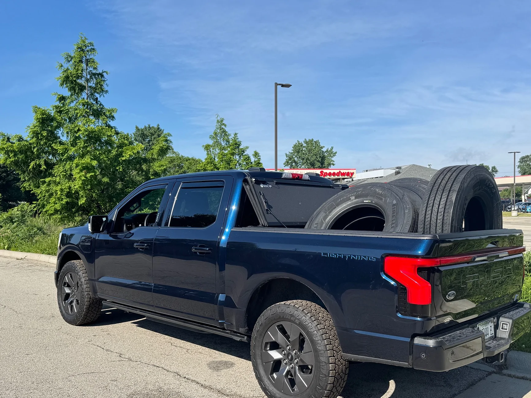

Last night got a notification from the Ford App that one of my tires had low pressure. Went down and looked for the issue (didn't see anything) and used the pump to pump it back up; it was about 15lbs down.
Went to the shop today to have them check it and plug it. Turns out it's the same tire that they plugged a couple months ago (nail from the dropoff area of the local Goodwill shop -- no good deed goes unpunished!).
They plugged it but said it's too close to the sidewall to be permanent. It's in between the first and second tread if I recall correctly.
He's telling me I need to replace all 4 tires. So, looking for recommendations. I've seen a number of posts here, so I'm using search to try and find the old(er) threads but figured I'd start a thread to get some additional input.

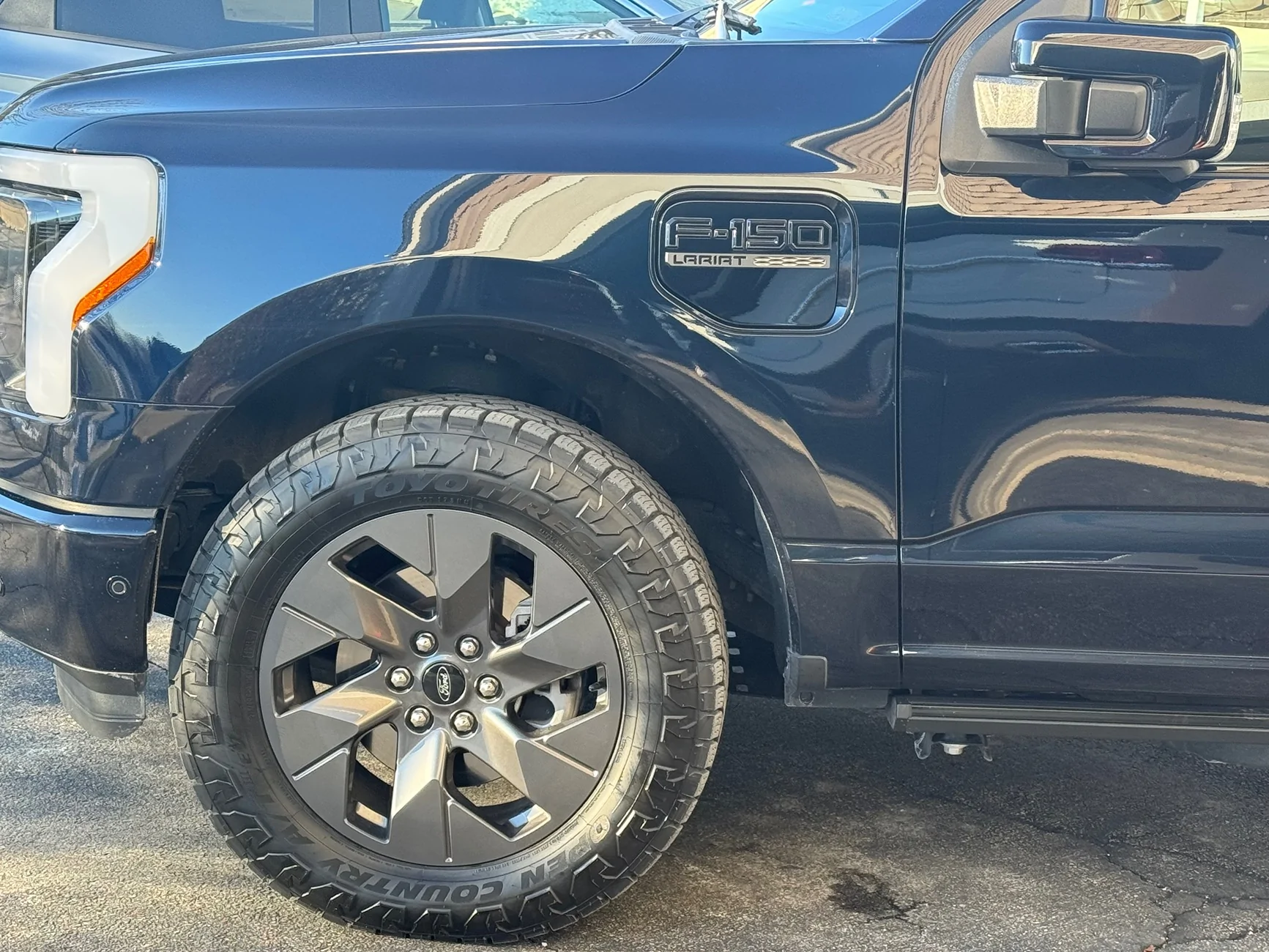

I went with Toyo Open Country A/T lll EV tire. 275/60R20. I have driven them about 10K on my 23 Lariet. I highly recommend these.
