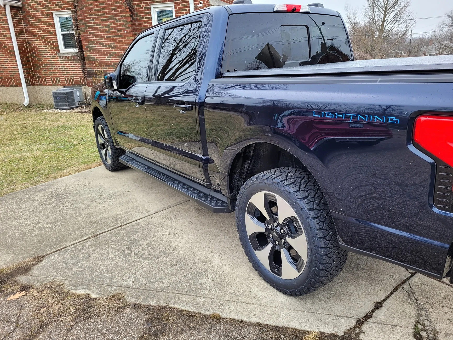

Love my K03s
Ford F-150 Lightning 2025 Lariat Tire Recommendations? New K03s1
