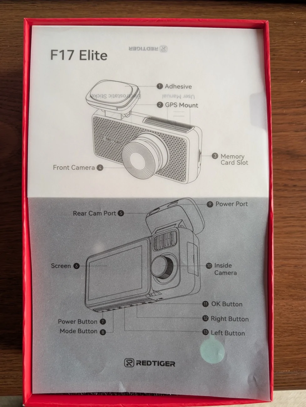

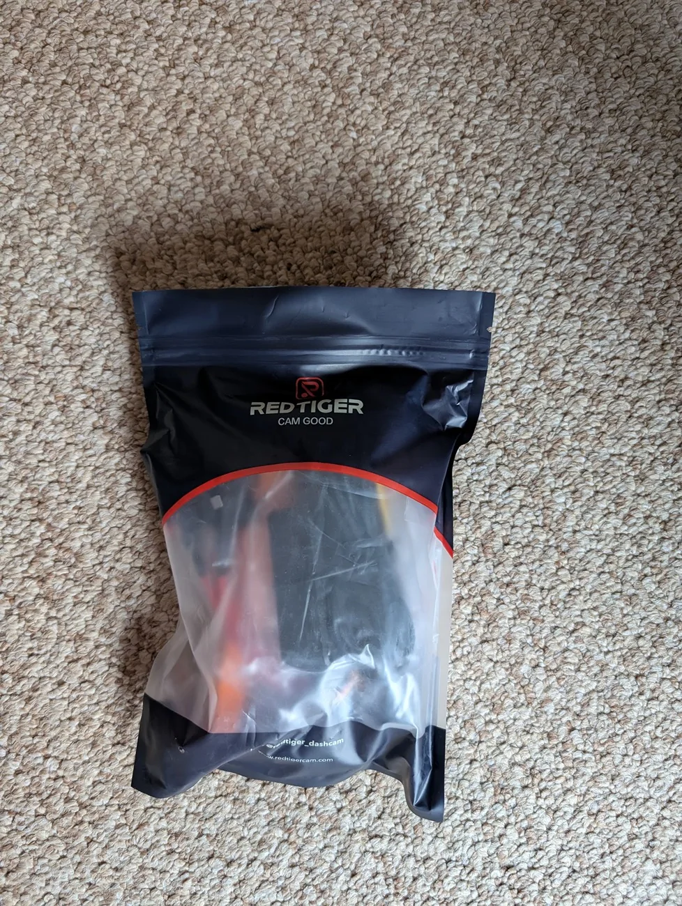

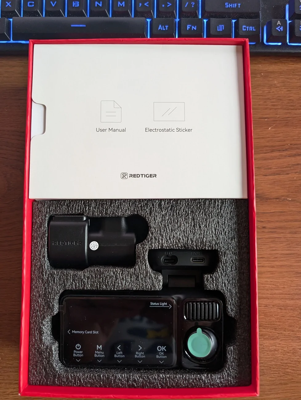

My camera arrived in a plastic pouch from RedTiger, delivered by FedEx. Opening the box you find a diagram sheet, and underneath it the camera along with parts boxes. They also included a separate package for the hardwiring of the camera.

I read through the 3 booklets that came with the products. The main User Manual is 24 pages of not much content. Installation instructions are 4 pages that lack much detail. First page told me to insert the memory card that was already inserted. The App Quick Book explains briefly how to use the app. The Multi-Size Type-C Hardwire Kit booklet says as a subtitle “How to install without vehicle fuse box manual”, which is quite confusing. I found a few references like this that seem to need some translation tweaking. Interesting, the version online is V1.0, mines is V2.0, and they added this confusing language, at least confusing to me.

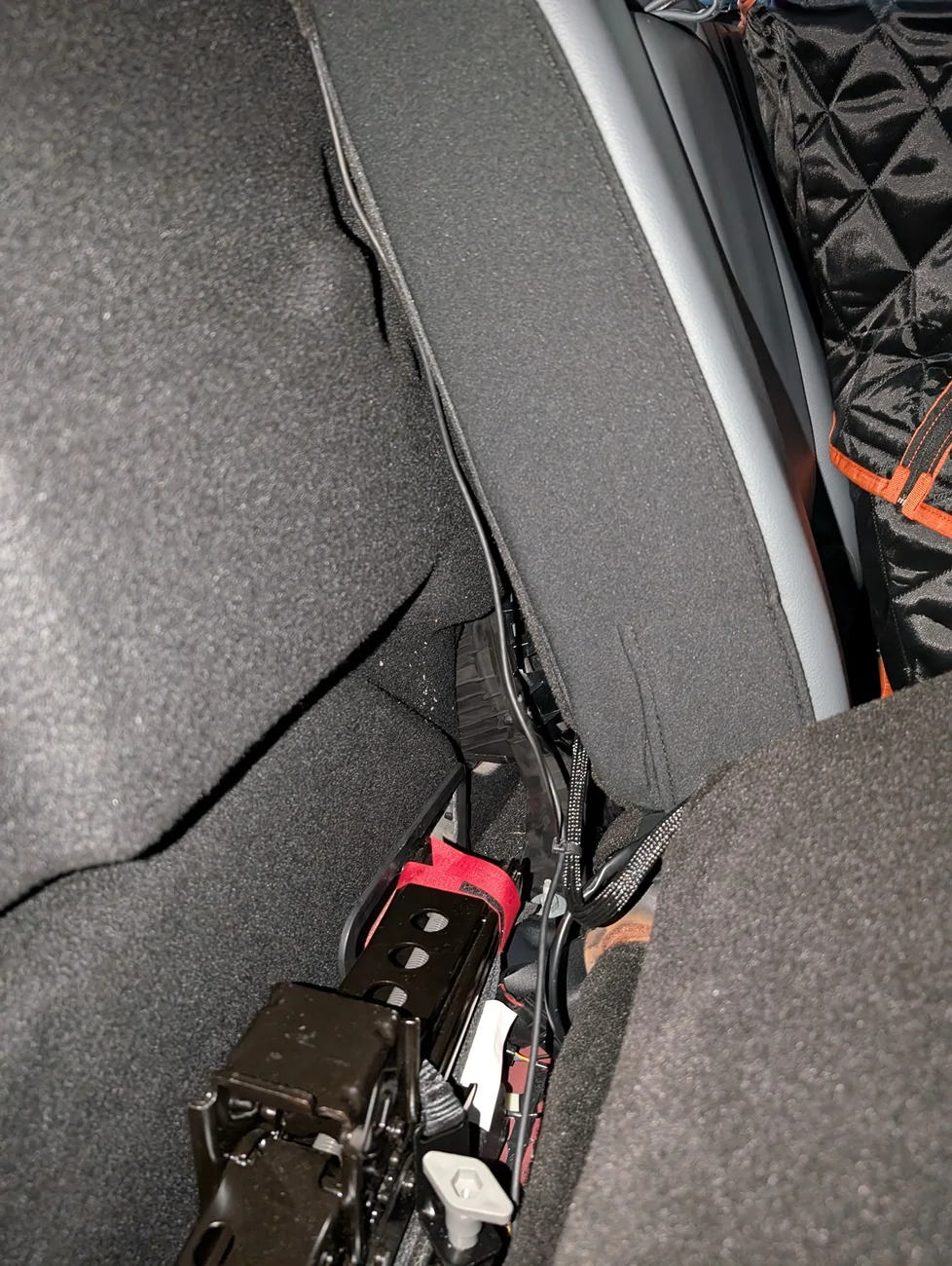

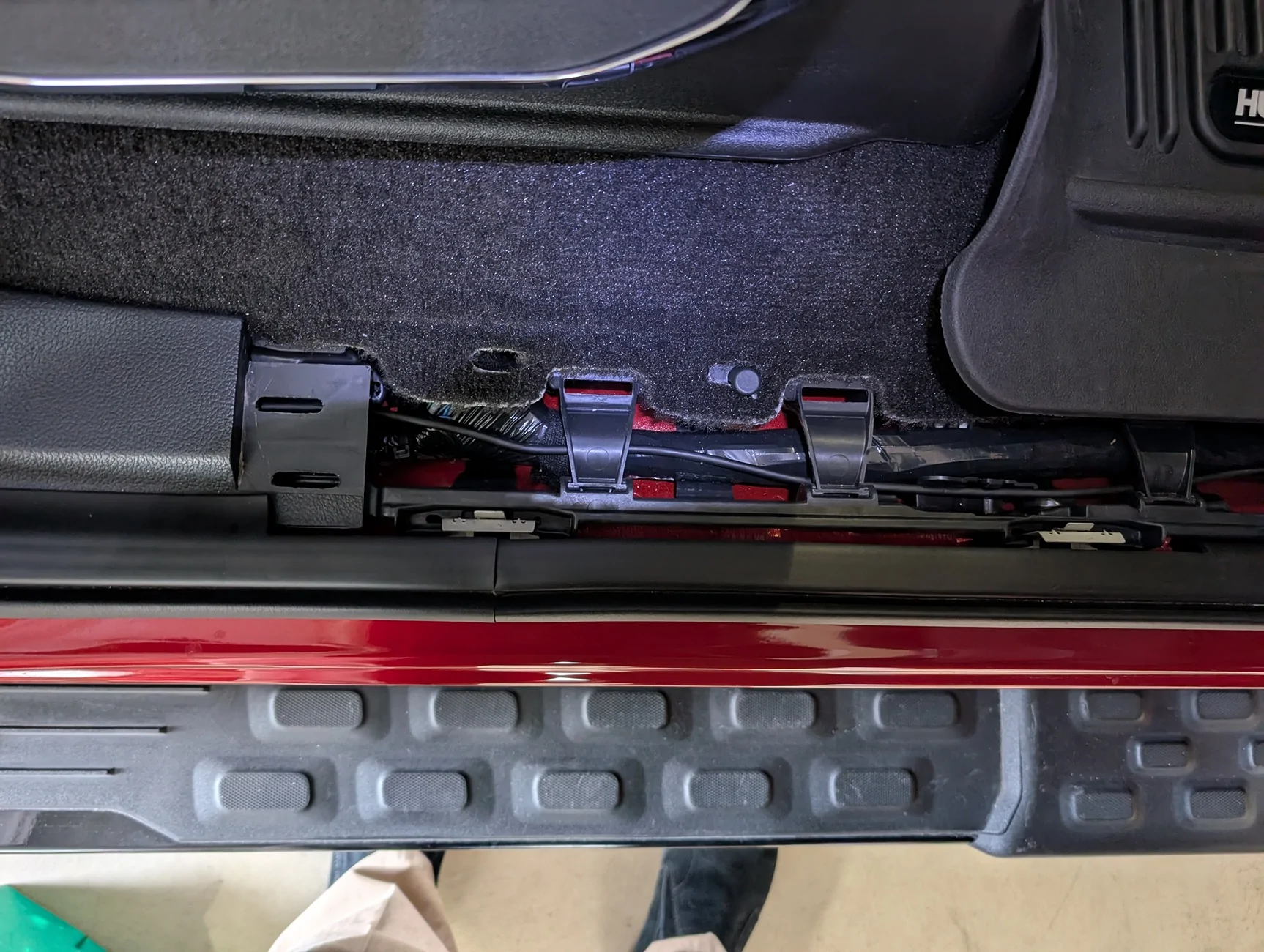

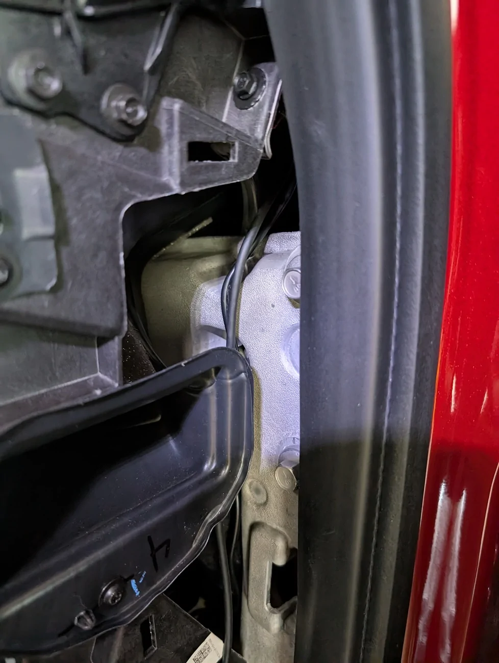

Now that I knew where the front camera is going, I needed to figure out how to run the wires. Up to the headliner was obvious, then across and down the a-pillar. I quickly decided that the back camera wire was going to run on the floor, not the headliner, because of the airbags installed plus the moonroof, and my desire to not lower the headliner because I doubted it would ever be the same. Note that the videos on the RedTiger site show the cable being installed in the edge of the a-pillar, and then the headliner, ignoring the reality that the airbags are behind there. IMO, this is dangerous.
I proceeded to remove the a-pillar cover, the side cover by the door, and the front door edge panel and rear door edge panels. I mounted the camera as we had decided, then plugged in the wires, noting that the wire for the hardwired system is a 90 degree angle, allowing closer placement to the headliner, but the one for the back camera is not. I noted this in feedback to the company. I ran the wires to the headliner, making sure to ziptie them to the wires behind the airbag. Down the a-pillar, then dropped down through the dash. The hardwire kit wire went towards the fusebox, the back camera wire went further down and then across the floor to the rear. I had measured and knew it would be close, and it was, in fact it could be 3 feet longer but I made it work. You need pry tools, the tiny orange tool they provide is good for stuffing but not prying.

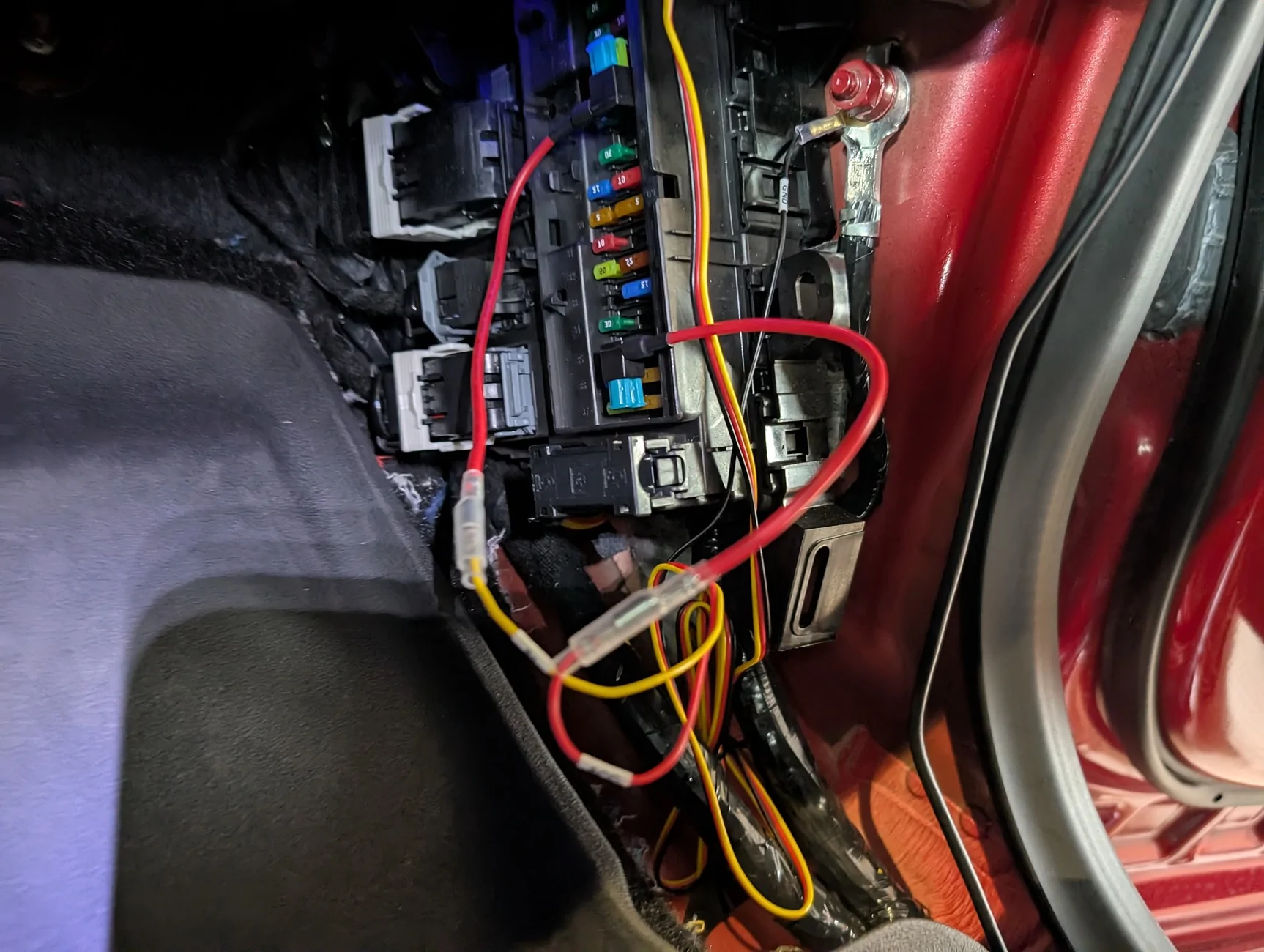

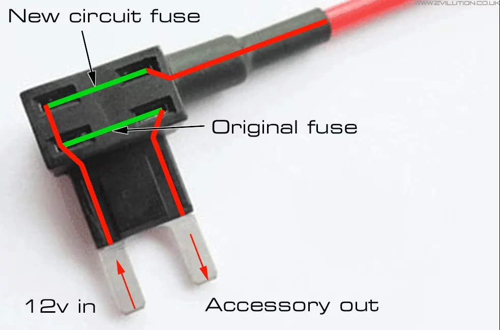

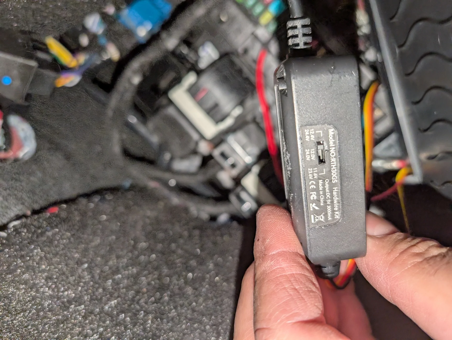

I went to work accessing the front fuse box. It’s a pain in the butt, but I had researched ahead of time what fuses I would likely use. Then I laid down with a poor headlamp on, trying to read the tiny numbers in black on a black background, holding the diagram next to me. Very comfortable. I had decided to use 17-18 for the switched fuse, and discovered it had 3 blades, which is a Micro3 fuse. Did my research and some Googling and discovered that Mach-Es and Lightnings use Micro3 for switched fuses. Well, the add-a-taps included (4 of them) did not include Micro3… More search and learned I could use a Micro2 tap and occupy the left and middle positions, leaving the righthand position open on these unused locations. But now I had to find an extra 15amp type2 fuse to take the second spot on the tap… . I used 4 for the always on fuse, as 5 was too tight a fit. I checked both power leads with a meter to ensure they had power (17-18 when the car was started by my wife, 4 always).
I didn’t bother following the guide that @RedTiger provides, since I had read the other threads and used a test meter. The voltage restricting device (they call it a “digital tube”) that they provide has 3 settings – 11.6V, 12.0V, and 12.4V. I set it on 12.4V. Right now my camera is set to activate, when parked, only when enough G-Forces are noted.
Ford F-150 Lightning RedTiger F17 Elite Dashcam Review PXL_20251201_192227121.MP
I didn’t spend a lot of time attaching wires to things because it was very uncomfortable down there. They have nowhere to go.

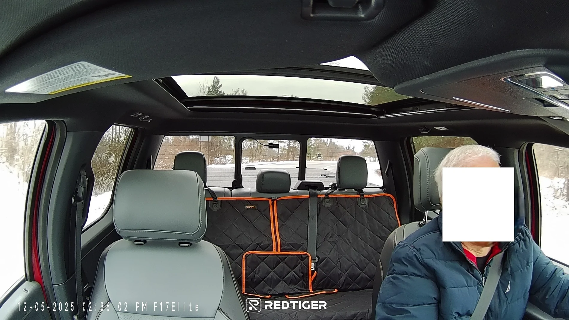

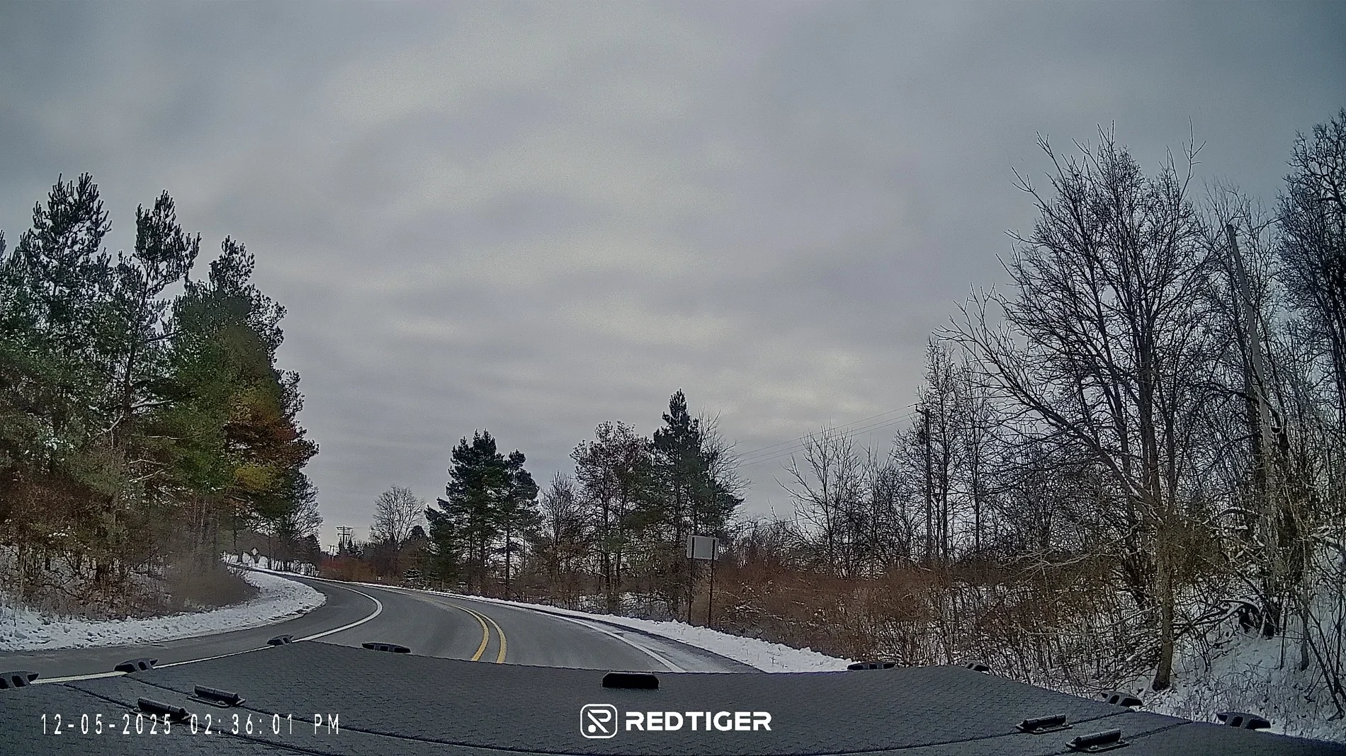

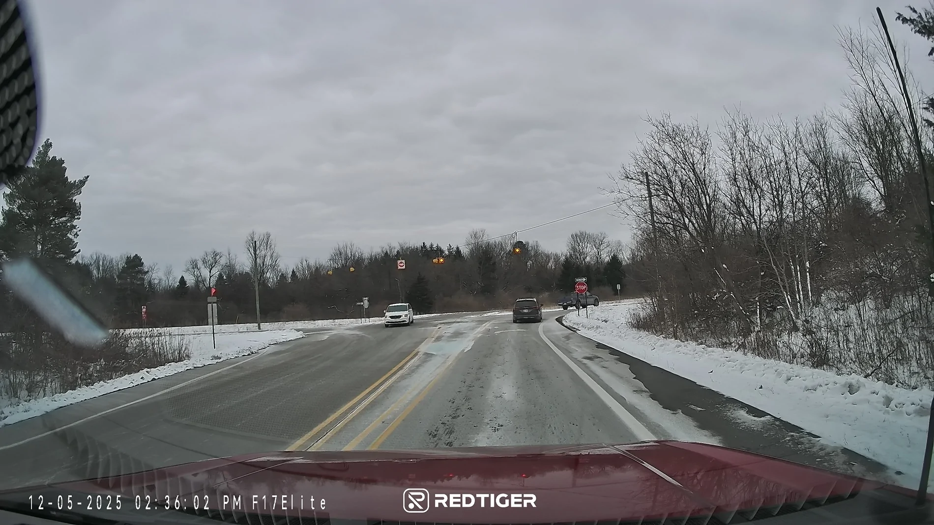

Below are pictures from each view, day and night. See if you can catch the shot that has a little issue with it...
Ford F-150 Lightning RedTiger F17 Elite Dashcam Review Front shot Lightning day
Ford F-150 Lightning RedTiger F17 Elite Dashcam Review Front shot Lightning night
Ford F-150 Lightning RedTiger F17 Elite Dashcam Review Rear shot Lightning day
Ford F-150 Lightning RedTiger F17 Elite Dashcam Review Rear shot Lightning night
Ford F-150 Lightning RedTiger F17 Elite Dashcam Review Inside shot Lightning day
Ford F-150 Lightning RedTiger F17 Elite Dashcam Review Inside shot Lightning night
