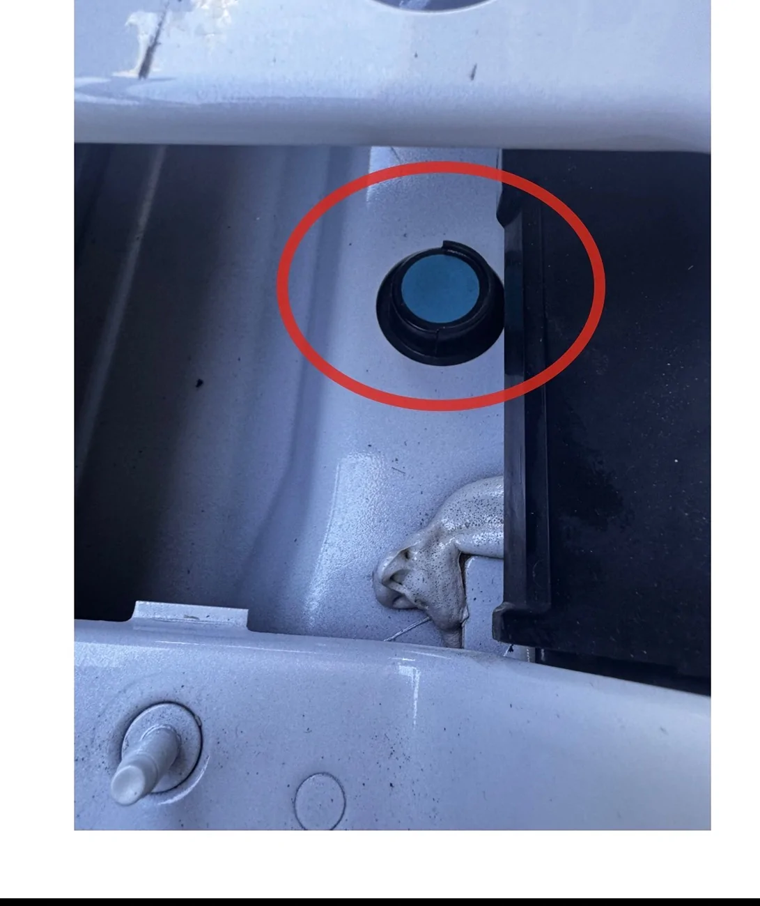

Is this the push pin for the correct light bar installation?
Ford F-150 Lightning 3rd rear light bar has water and reverse lights blinking IMG_1438
