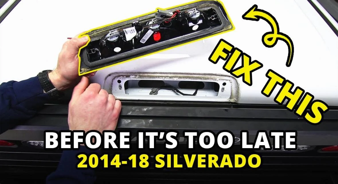

Man that is a bummer, Chevy had the same problem for several years until they got it right.
Get a warranty it will differently be better paying an $100 deductible, rather than a $900 fine for light being on the…?
That's a different lightbar, and Ford had that same issue for years (I had it on my 2013). This is the lightbar on the tailgate.
