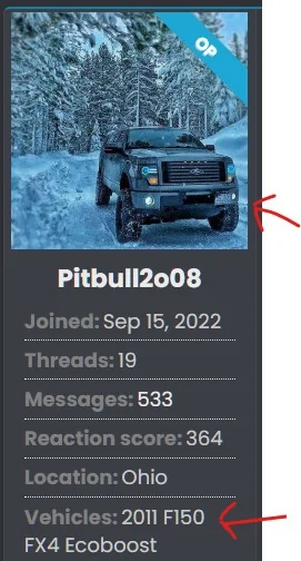

Because you haven't updated your profile and avatar from your old/other truck. It's paying you back for neglect. :bandit:
Seriously though, after you get it replaced, find the lowest part that's semi hidden and drill a small hole for moisture to run out instead of shorting out.
my signature and profile are up to date.

This part dude.
Yeah that’s one of them. It says vehicles, plural. Both should be on there. Not sure why it matters, my sig is up to date.
What ever floats your boat.
