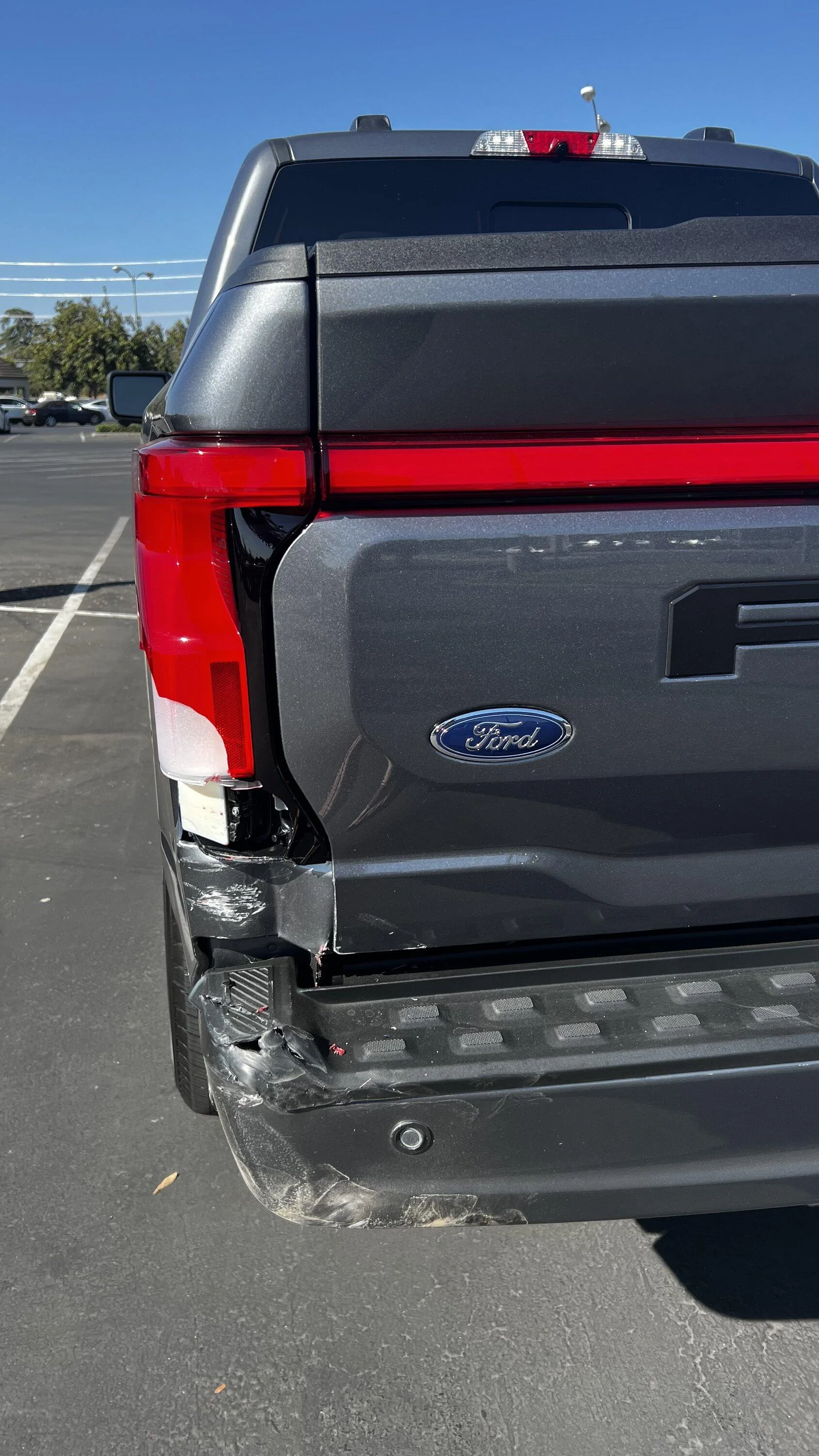

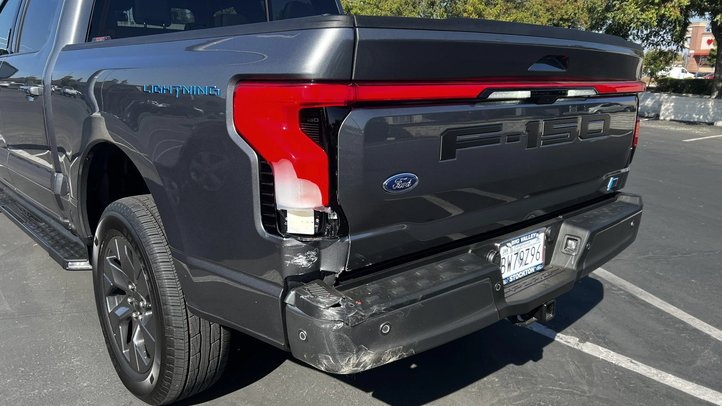

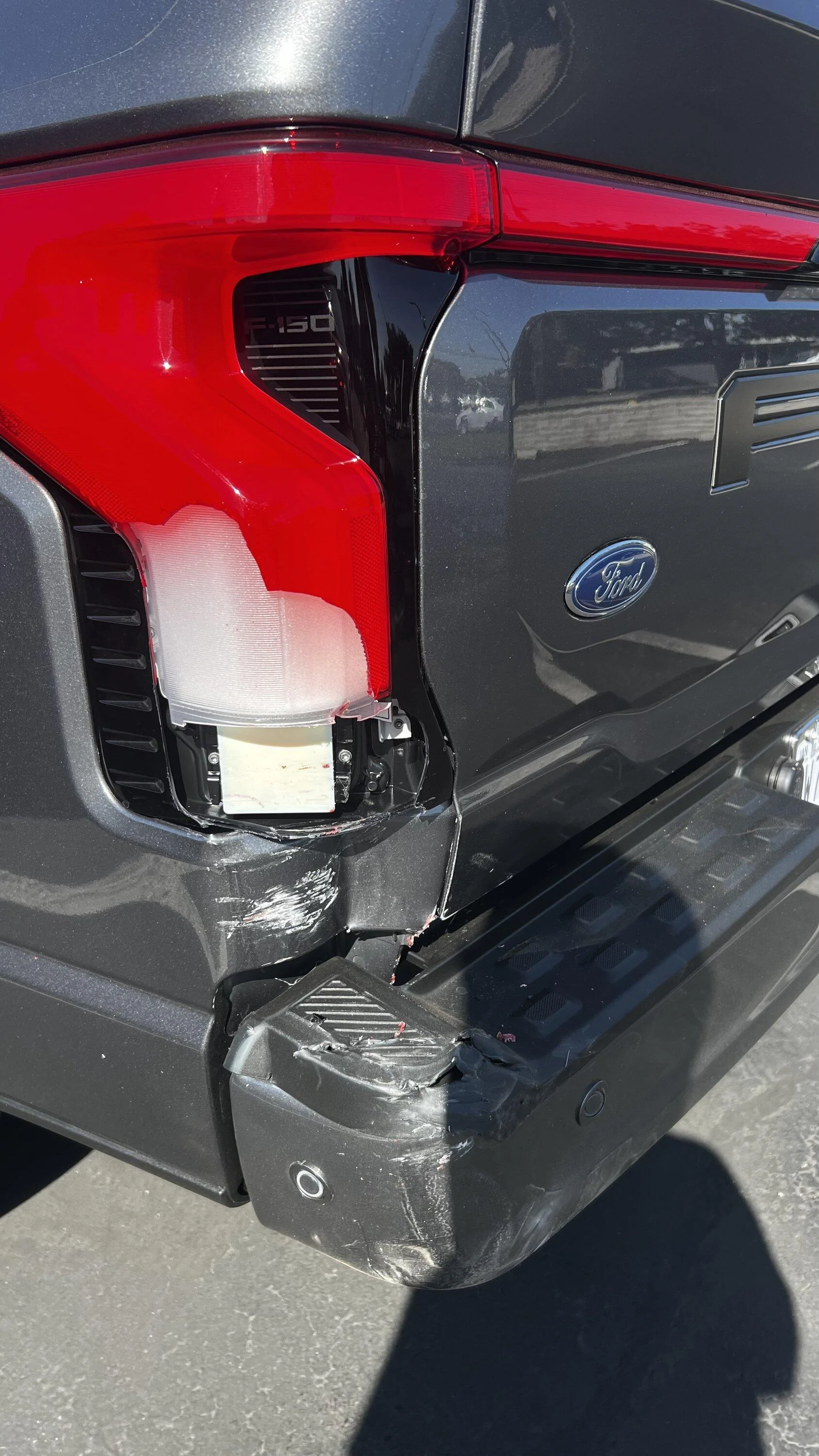

Could have been worse but still devastating. Picked it up on Tuesday afternoon and right around 200 miles on her. ?
Stopped in a right hand turn lane and person wasn’t paying attention. Probably new bumper and light and some body work to panel under the taillight and tailgate.
Tailgate still goes up and down but rubs metal/metal in the bent corner.
Should I get it repaired at the dealership or find a highly rated shop?

I see this going one of two ways. Either they can pull the damage out and TIG weld the tear in the bodyside under the taillight, or you're looking at all of the rivets on that bodyside being drilled out and the whole panel being replaced.
I would definitely make sure whomever does the work is certified by Ford to do aluminum work.

Voting for highly rated shop. They will reach out to dealer/ford if needed.
