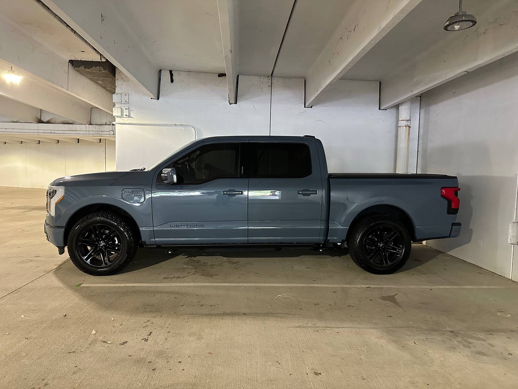

No worries. Here it is with Black wheels, running board delete, and ideal ICON height.
