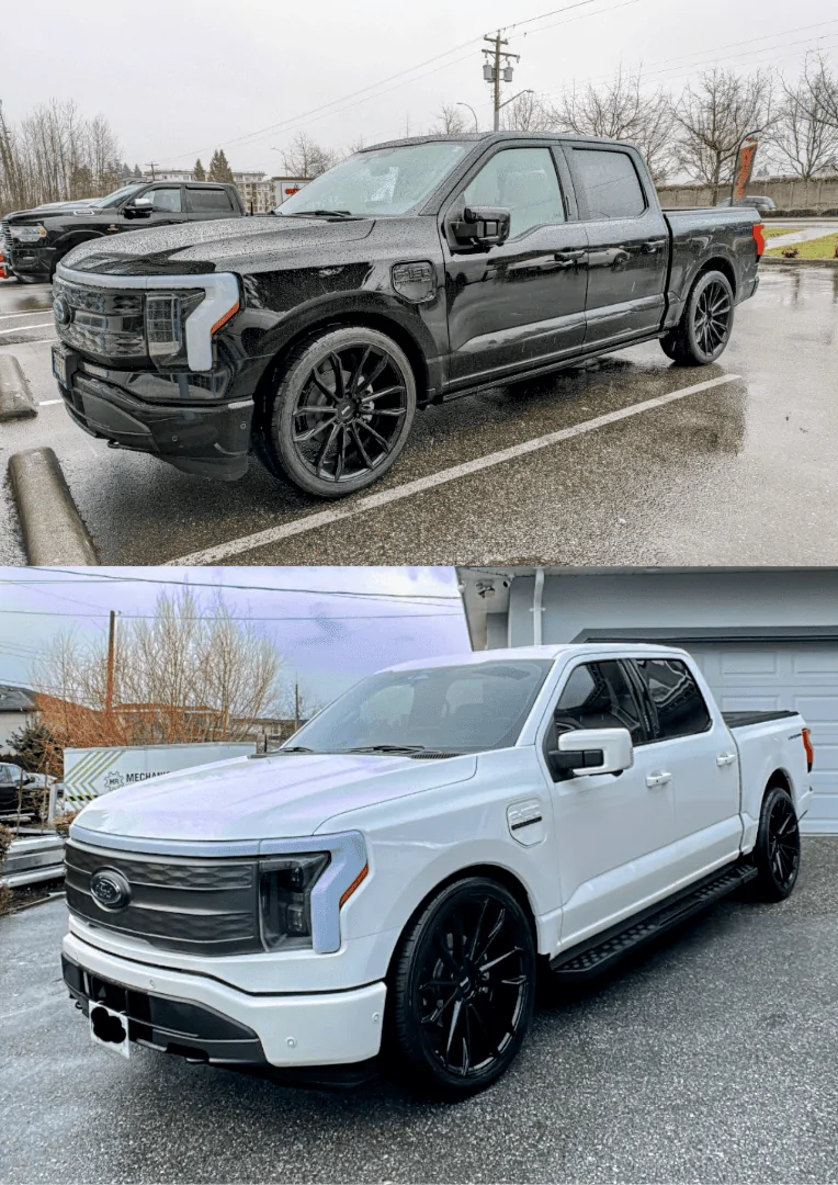

Belltech makes a direct fit strut for a 2013 f150 that utilizes the factory spring and fits the rear of our lightnings for 1-3" drop. I used them on my lightning for a while and ride was same as stock. Recently switched to a different setup to get even lower though. As of yesterday swapped all the parts from the white truck to the black platinum.

Do you have a link to the belltech part or part #?

Damn man that looks super clean. Any parts or install info? I'd love to mirror the look.
I've got belltech 25027 on the front and for the rear I've got "ride tech shockwave hq" air struts with a "wireless one" ride height control kit

Your black truck pictured is lowered how much?
