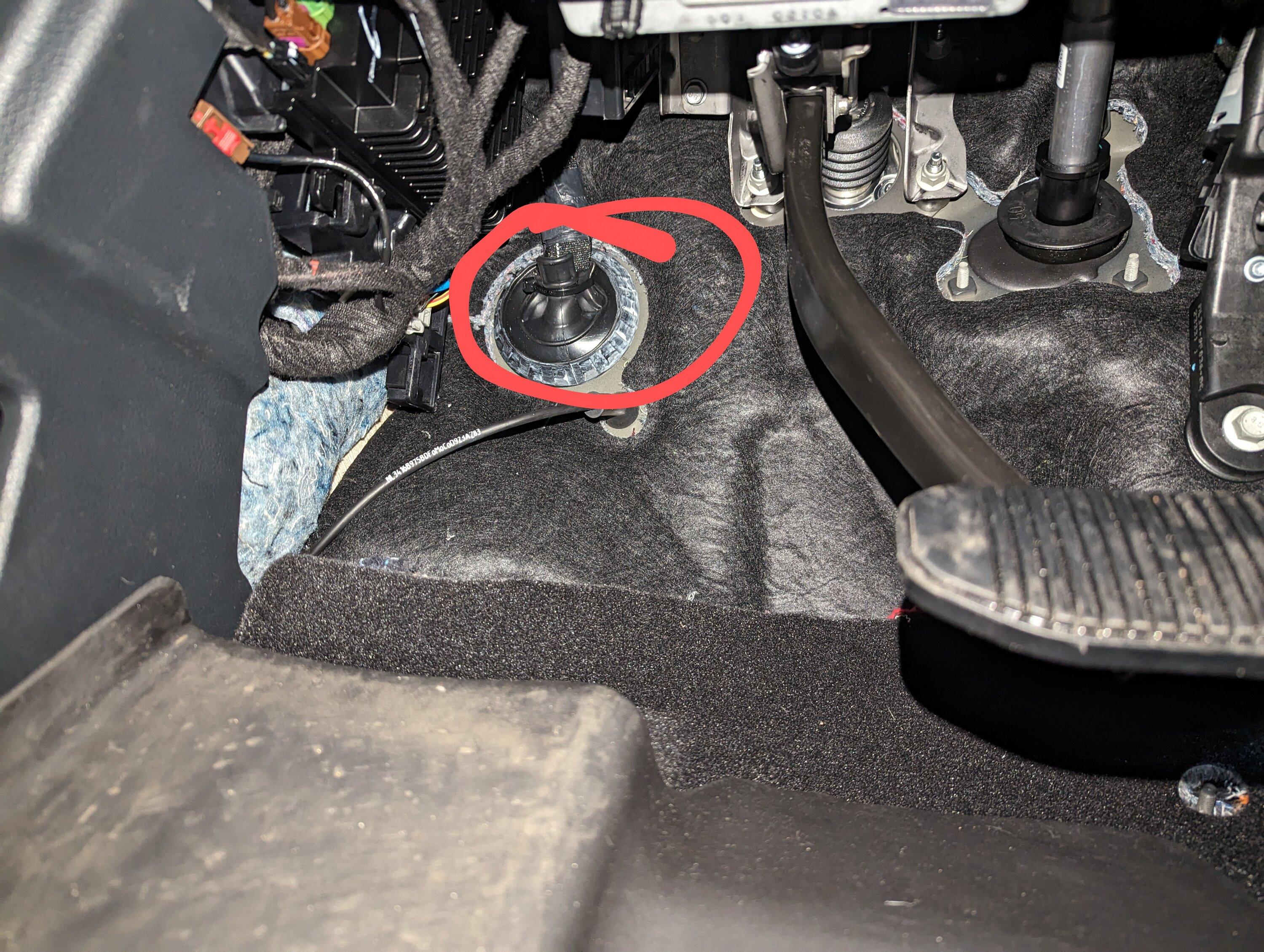

You could also use the access port in the floor under the drivers side foot well.

I used the small gromet the emergency hood cable passes through the firewall. I poked a small hole in it along side the cable.
