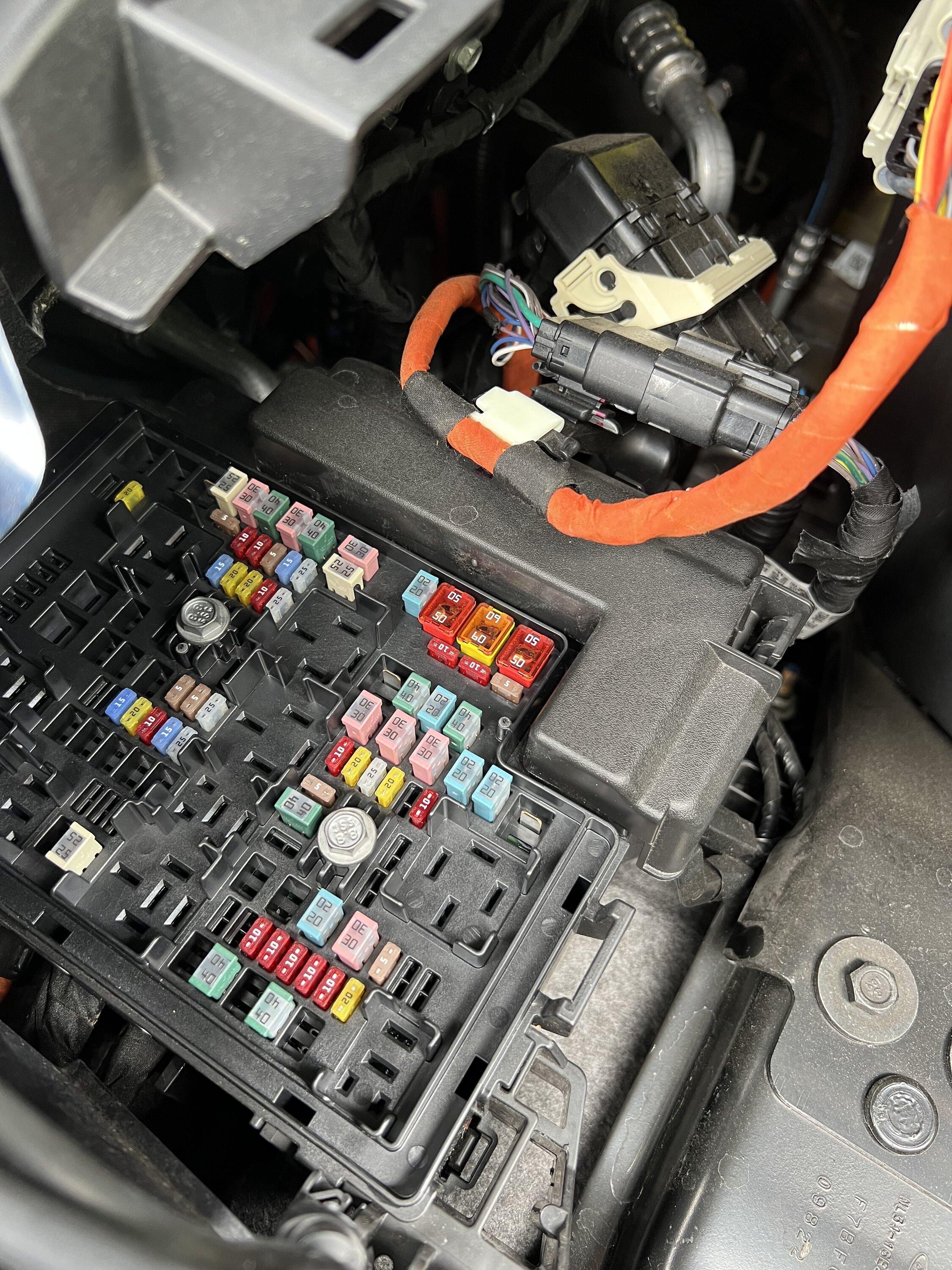

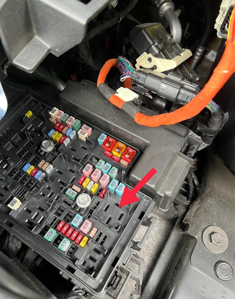

So we have a Retrax Powertrax tonneau and it comes with a 12V tap for the 12V battery.

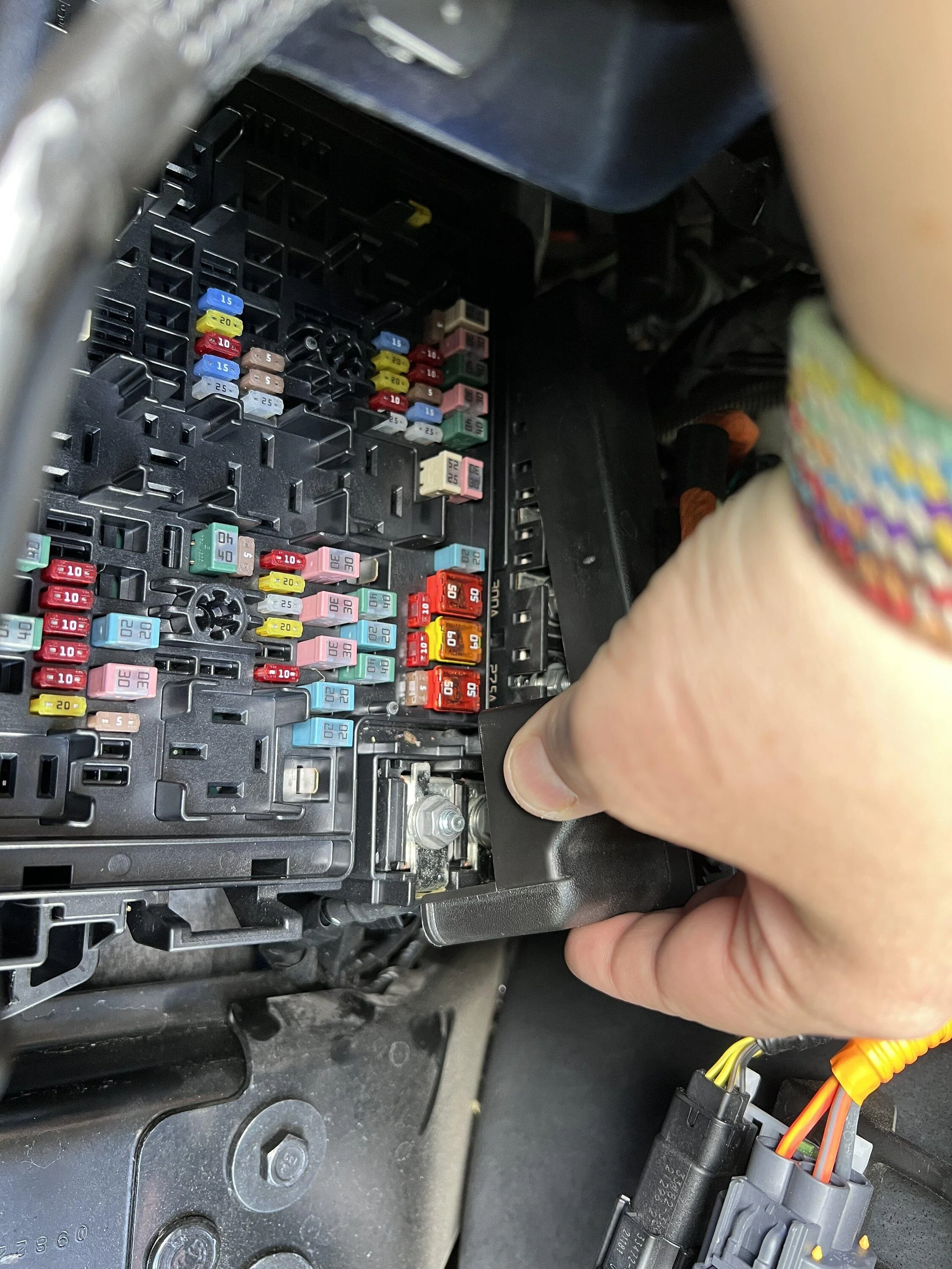

I’ve never been a fan of taking things directly from the battery and instead like to go through the stock fuse box. Except when I accessed it under the hood, I’m not 100% sure how to access the underside to wire a new line into a free space in the box.
There’s some pretty beefy 275 and 300 amp DC lines connected on the far side of the box, and even with the relevant bolts removed I can’t see how I could lift the fuse bed up to access wiring underneath.
Thoughts?

As to the fuse tap - I could just pull 12V from one of the 12V taps in the box… but the cover wouldn’t fit quite as nicely.
I’d hoped to get a 12V switched supply rather than an always on, but meh.

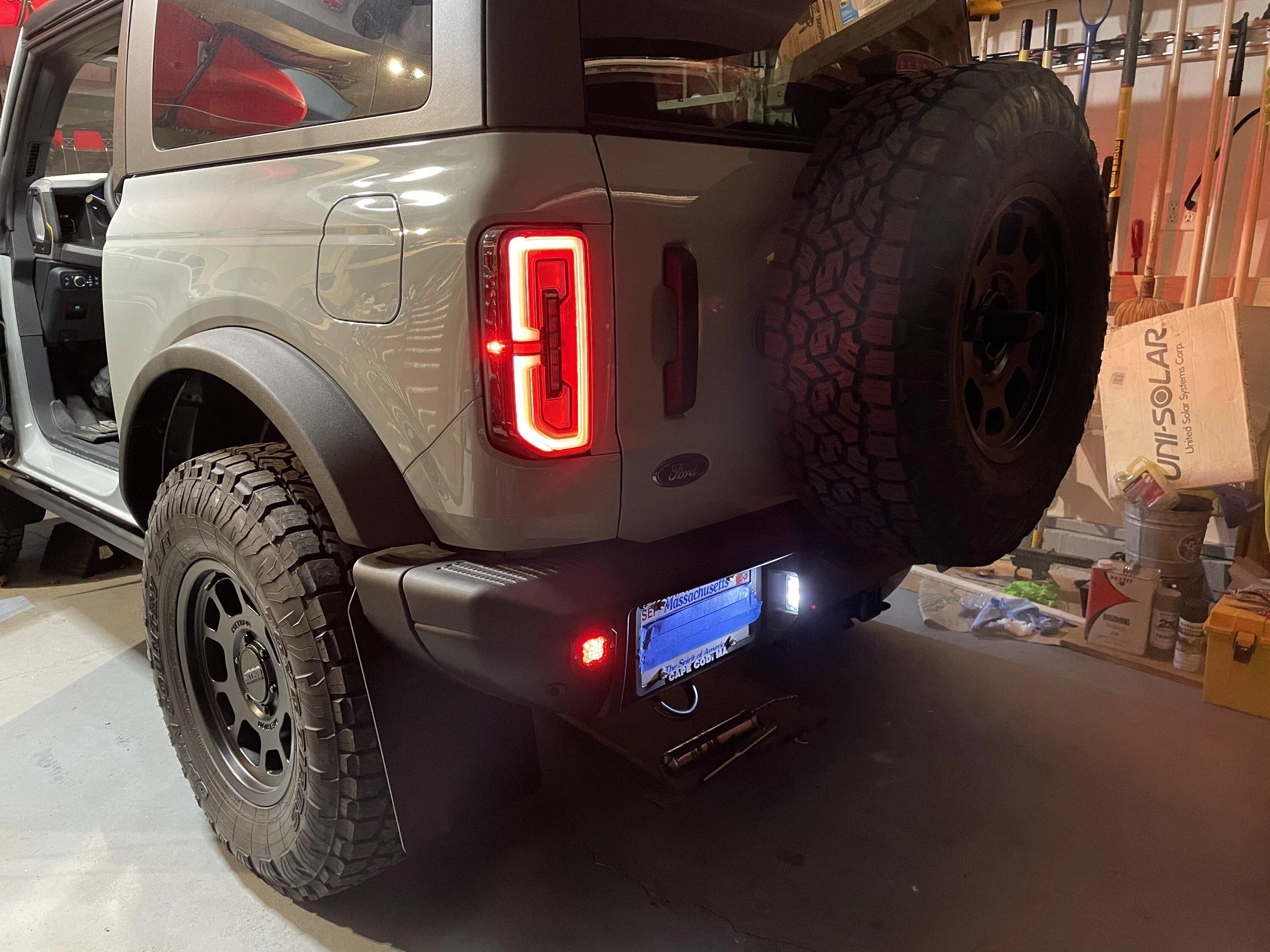

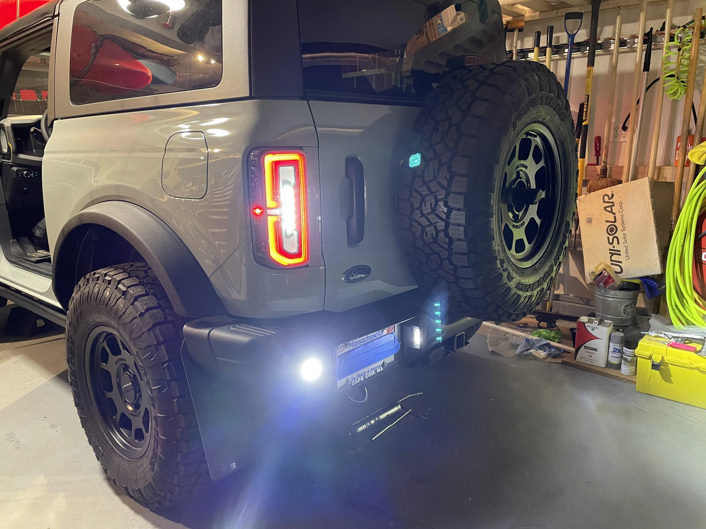

What about pulling power from the 7 pin trailer harness? You can get an adapter to tap into so you don’t have to cut any truck wiring. I’m not certain is the 12v is hot all the time on the Ford. I used the Hotshot harness to wire the backup lights on my Bronco, I also tapped into the running light wire on the adapter for the backlighting.
https://hotshotoffroad.com/collections/custom-products/products/universal-hitchpod-s1-harness
https://www.putco.com/product/blade-quick-connect-harness/
