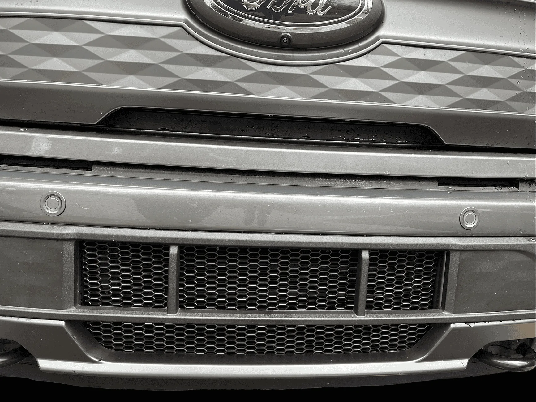

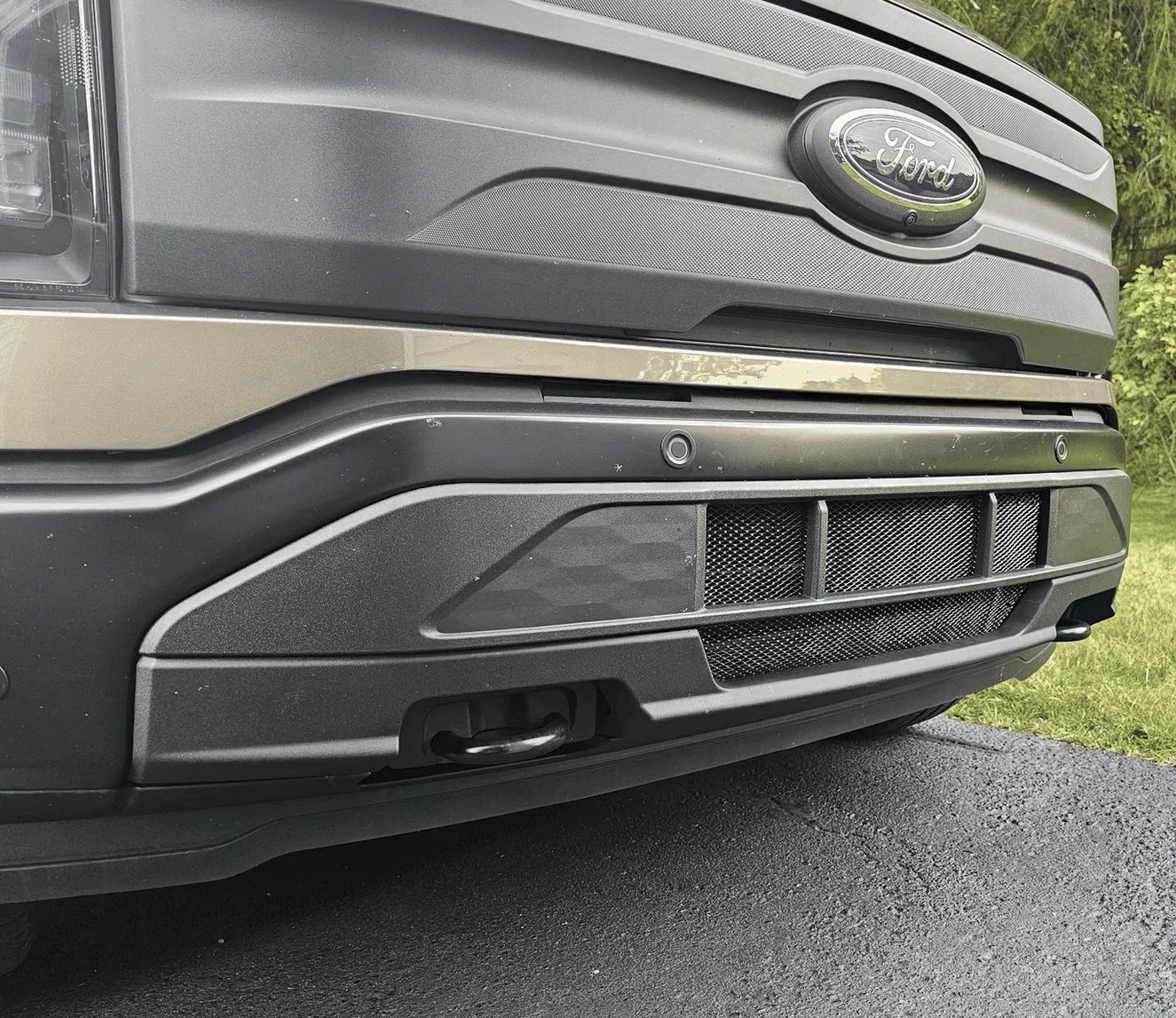

Just did it with the expanded aluminum mesh, which is conveniently now on sale for Prime Day for just $12. Came out pretty well for just a few bucks. Sized at 21.5x8" with slight reliefs on the bottom corners, slotted into the surrounding bezel so it's quite rigid all around. Just make sure you put the zip ties through the grill first otherwise you'll be fishing the tails out through the holes with a dental pick.

Ya, I removed the whole section that covers up that intake. just half a dozen clips to pop, then tailored fit the piece to fit, w/o any zip ties,,,, peace of mind,,,,

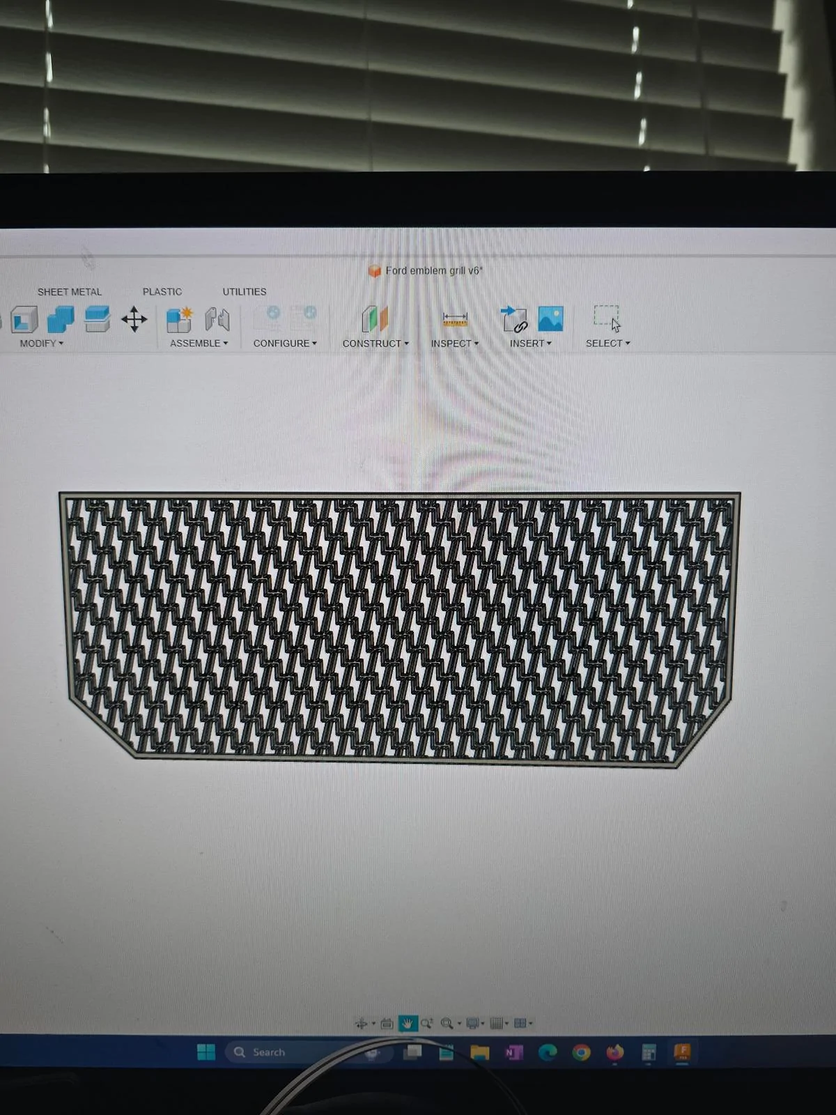

So a while ago I got some mesh online, I liked it but now I think I can be that cheesy guy that makes a custom one. May do some resizing and playing with the size but I think I have maxed out my work laptop for its memory.
Post the file, please, if you want to share.

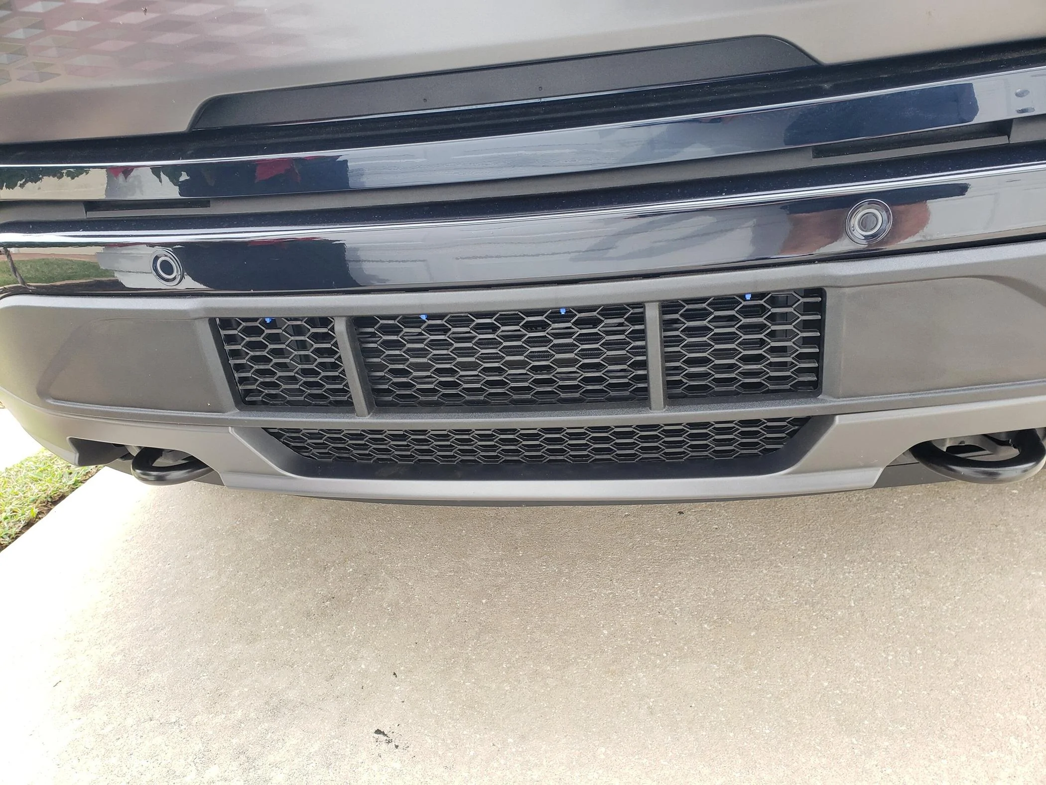

I just added the grill to mine. I ended up picking one of the plastic ones from Amazon for $36. It is 47"x16" overall with a 11mmx30mm honeycomb . I trimmed it to 21.5"x8" and clipped the bottom corners some. Used 4 zip ties and it fit right in there. I like the look of the plastic honeycomb pattern because it matches the patterns in the lightning grill. You can get the same plastic ones off of eBay for around $28 if you want to save a little. Based on the overall dimensions, you could make 4 grills out of it. If you have any local lightning buddies, you could split the cost. FYI, these are not ABS according to the reviews regardless of the advertising. However, they are more flexible than ABS which makes them easier to maneuver into place.
