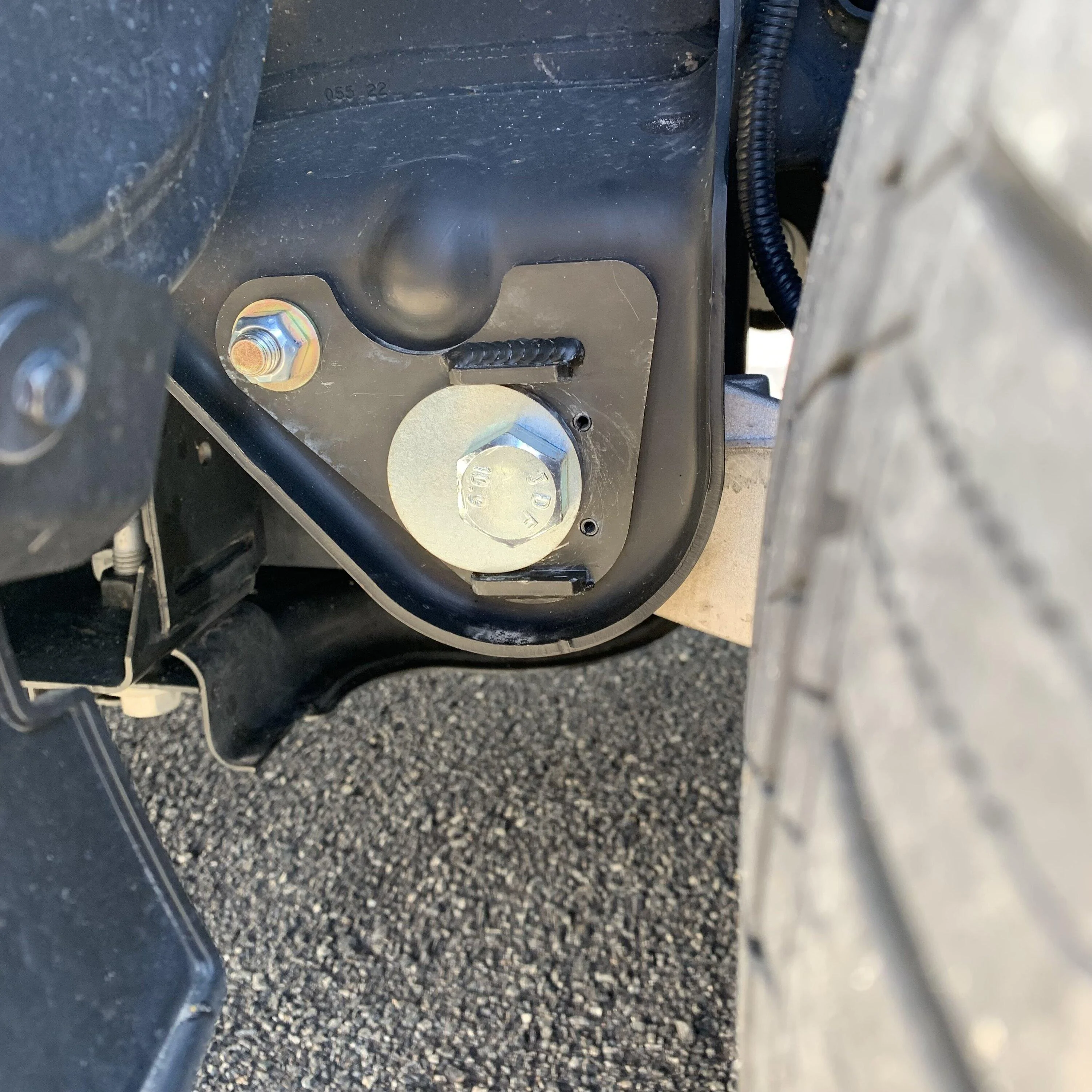

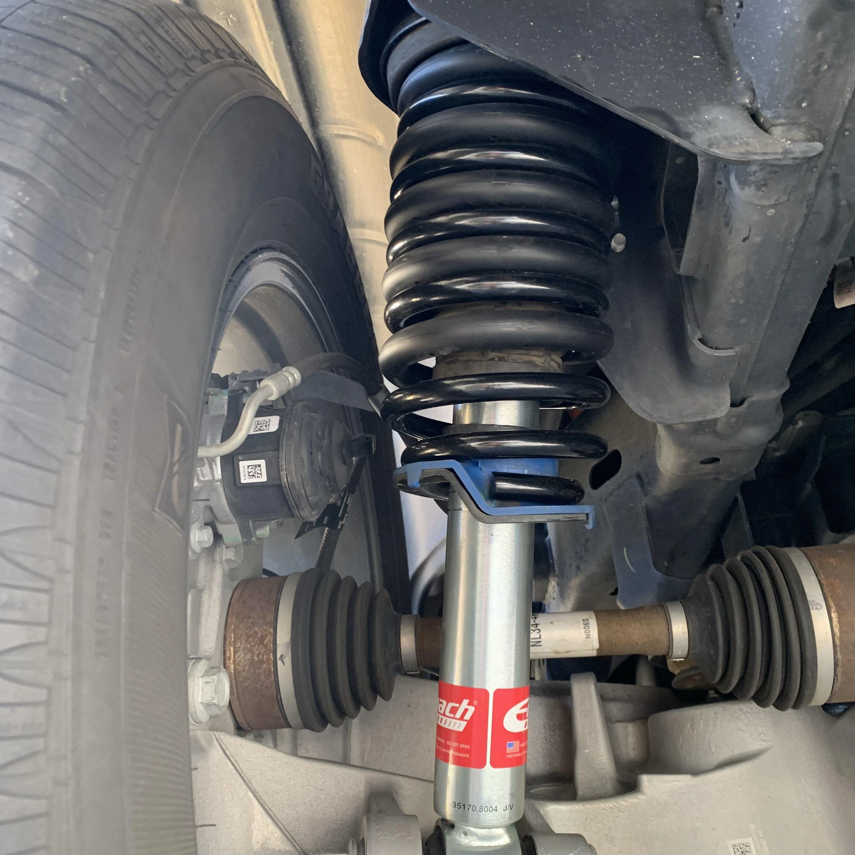

Well I finally got it all done. The camber kit was a lot better putting on the other side, when I learned from my mistakes on the first side. The first time I disconnected the strut. The other side I just loosened the bolt for the strut and left it connected. It made it much easier to get the arm back into place this way. As far as ride quality......It's not as soft as stock. The stock struts are soft while the Eibach struts are much more firm. The stock springs are thicker than the Eibach springs, and the Eibach springs are almost fully compressed at their ride height on the vehicle. Ain't no way that the Eibach springs have more spring rate than the stock springs in my opinion. While I got the drop that I wanted, I think I'm going to cut a coil off the stock springs and see how they ride with the Eibach struts. In the meantime, here are some pics as it sits currently.

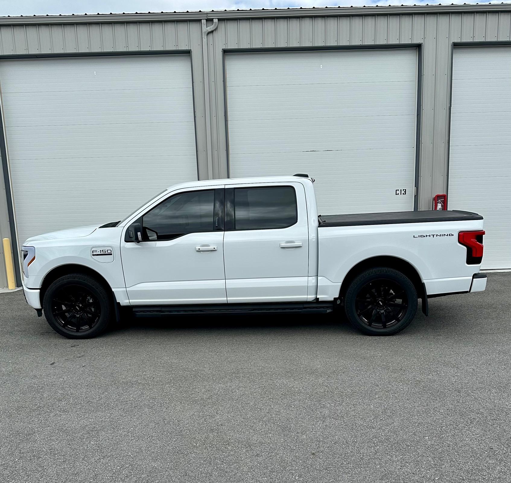

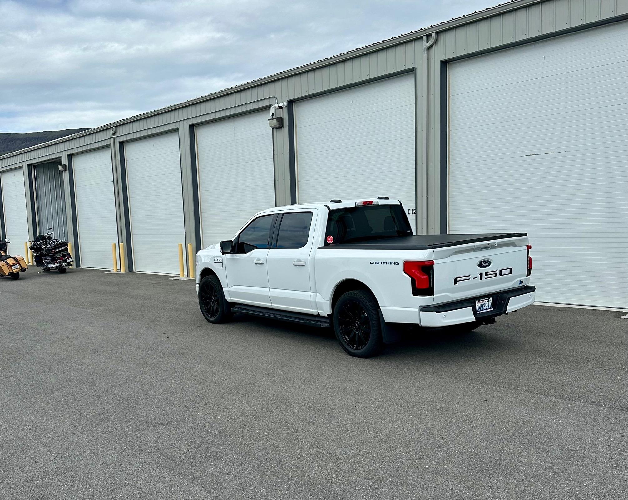

I posted in the wrong thread. Before & After Shots. Installed Eibach lowering springs, shocks and recommended camber kit.
Looks great! What tonneau cover is that?
