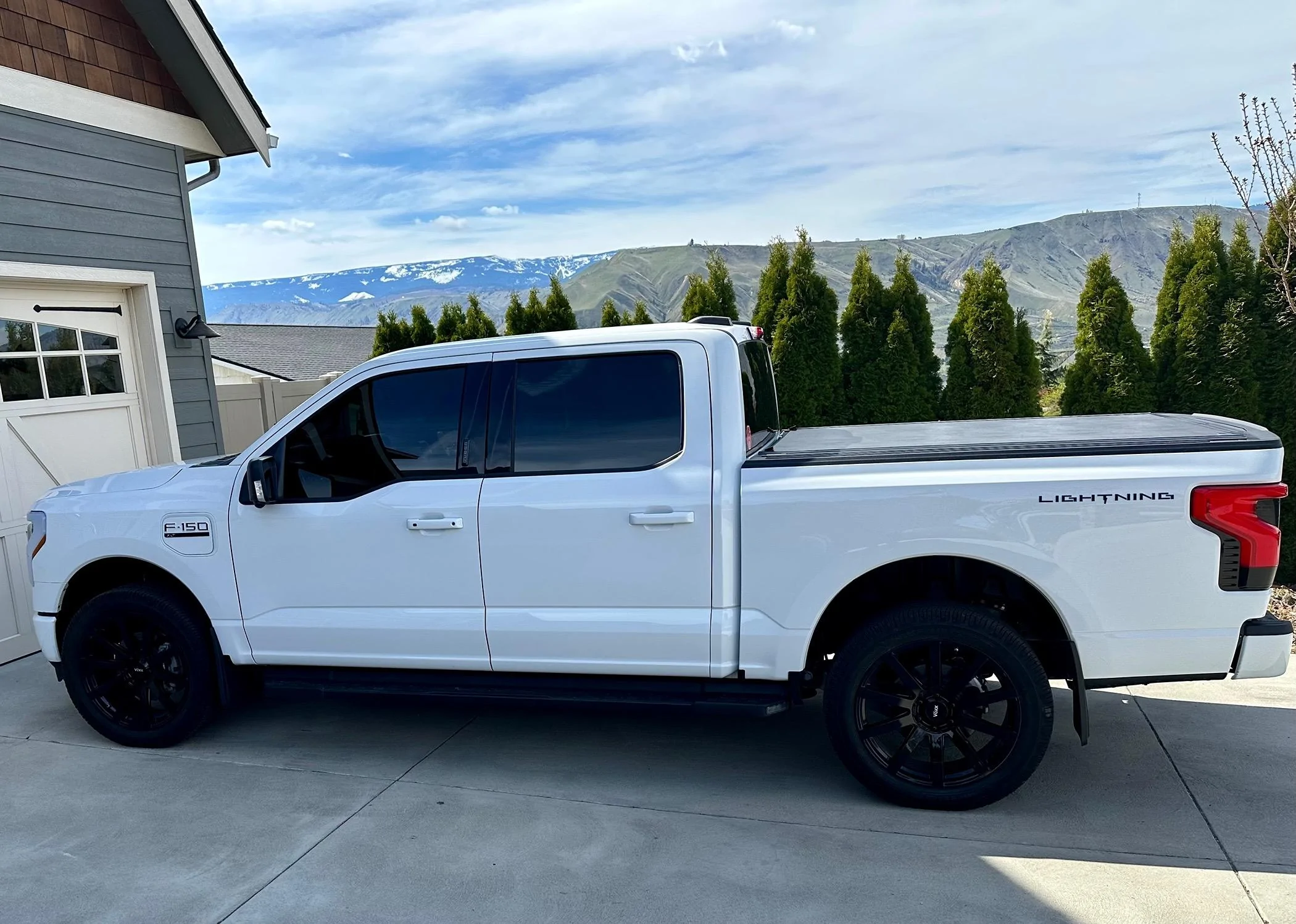

I did the Eibach springs, shocks and Icon camber kit. I love it and the truck performs very well. For example, I hauled 2400 lbs in the bed only 4 times this past weekend, no issue and didnt sit too lazy when loaded. The best part is the truck will still go 0 to 60 really fast (no downshifting and so on) and you cant tell there is a load. Here is a pic of me pulling off a little roof while loaded.

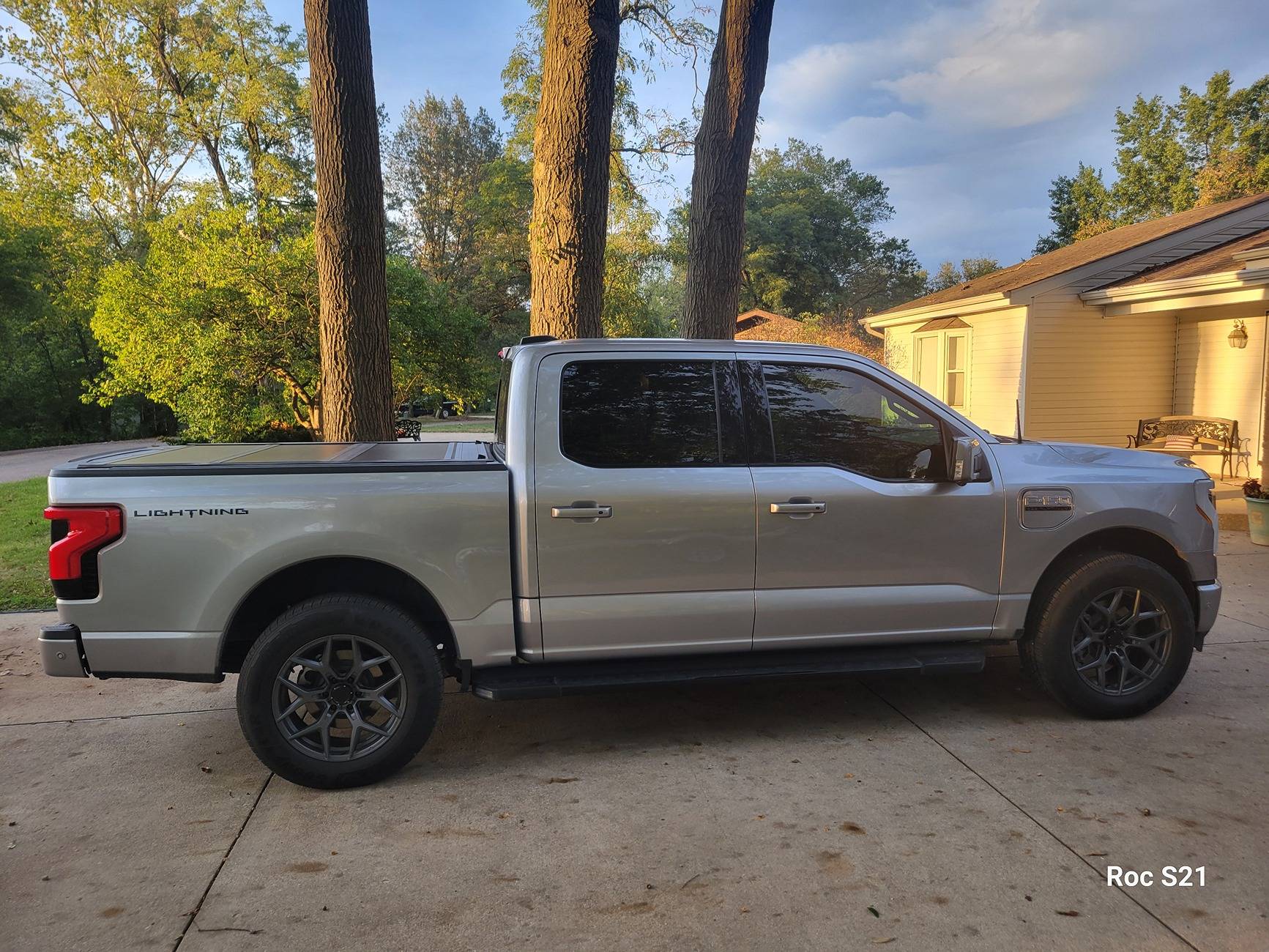

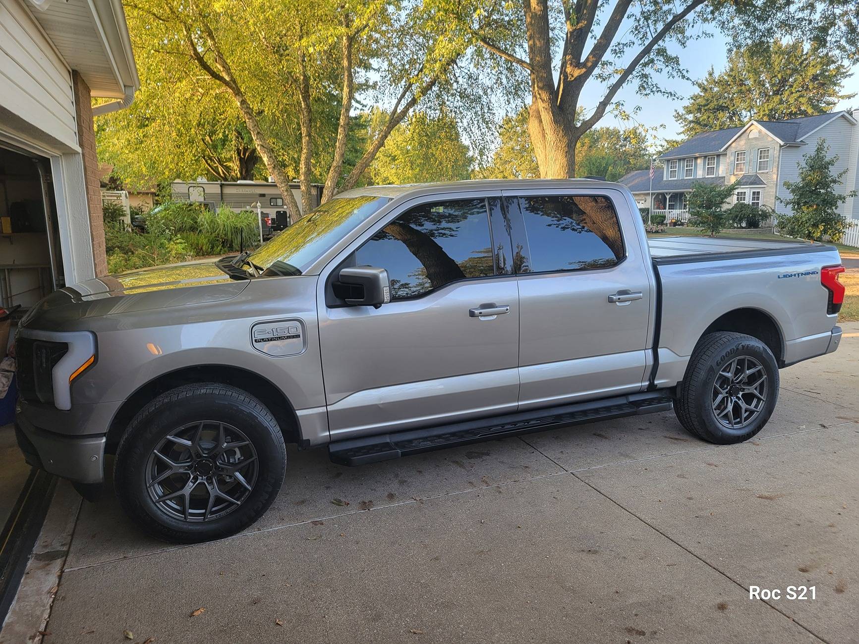

So, with the McGaughy lowering rear spring mount. It dropped the rear 1.5 inches. Better, but I think just a little more would be nice! Went to get an alignment today. Some shops are still not able to do the Lightning! NTB you listening? Just eyeballing Camber should be ok. Toe appears in a little more. Have another appointment Tomorrow. Top pic is after.
