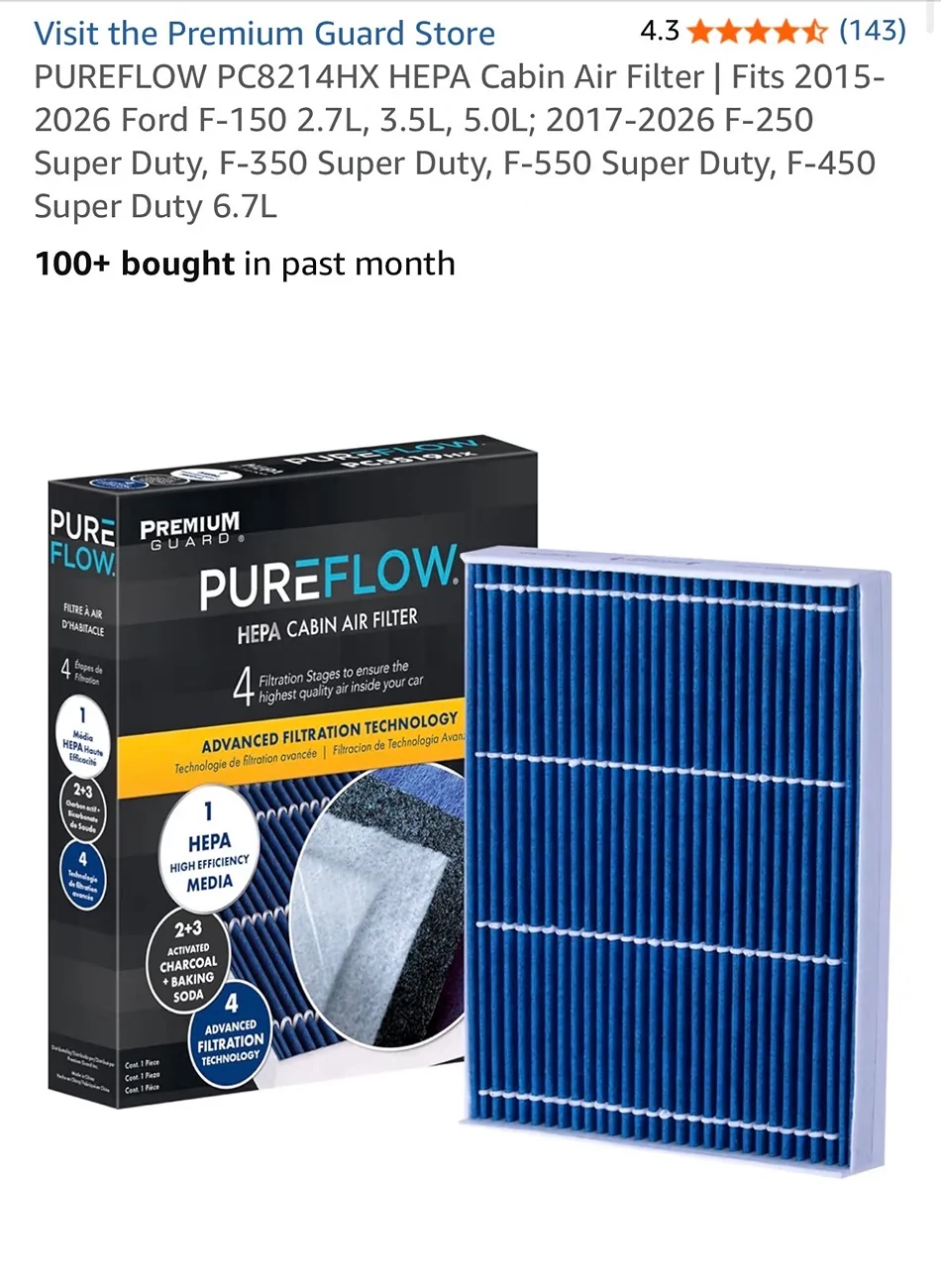

SOLVED!
Around the same time I had the truck in for the software update recall, I had also replaced the cabin air filter. Naturally, I bought what seemed like the best filtration available. Turns out this filter is too restrictive for the auto control to work properly, verified by a long drive last night in 95 degree temps with my normal setting of 74 degrees, fan speed max set on two segments. Failed to adequately cool until I removed the filter then it was almost too cold running without filter. This is the one I bought that I’ll now be replacing.

As an alternative that isn't as restrictive, but still filters well: Motorcraft FPP92. I used the filter above and while it works very well, it is too restrictive as the OP found out. The FPP92 (I got mine from Rockauto) is a little bit more restrictive than stock, but less than the one above.
Here's a Ford.com link.

ChatGPT says:
What you observed is very plausible from an HVAC engineering perspective. The climate control system itself probably wasn't "broken"—it was operating with airflow conditions outside what it was designed for.

The sequence you described is consistent with an airflow restriction caused by the replacement filter:
The software update was likely coincidental.
Replacing the cabin filter with a much more restrictive HEPA filter reduced blower airflow.
The automatic climate control algorithm continued to command cooling based on expected airflow, but the reduced air volume limited heat removal from the cabin.
Removing the filter restored airflow, allowing the system to transfer heat efficiently again, making the cabin cool quickly and even feel "too cold" until the controller adjusted.
From an engineering standpoint, the symptom wasn't that the automatic climate control "failed"; rather, its control strategy was operating outside its expected airflow envelope because the cabin filter imposed a much higher pressure drop than the system was designed for.

Had the same issue with the same filter. Motorcraft FPP92 solved my problem although it doesnt filter quite as well (occasionally smells make it in) but the improved airflow is worth it to me.
