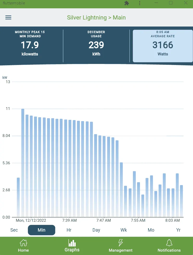

The cost @27/c-kwh to pre condition the truck this morning
Energy draw by the minute this morning 7:27 to 8:06, departure is at 8:15am

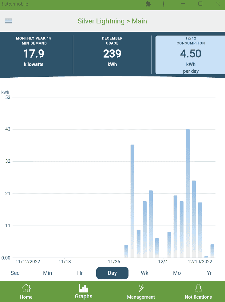

By the day

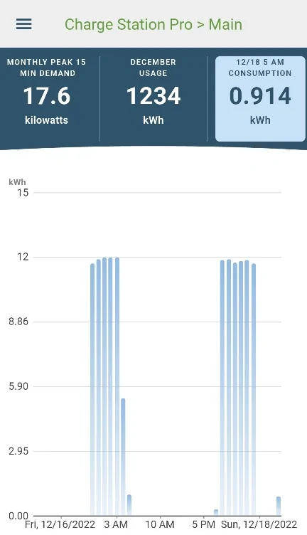

Hey @TaxmanHog - what is that app you’re using to track? Is it something most people use here?
That is the app for his Emporia Charger, and also Emporia home monitoring system.
This is the device I am using to monitor the branch circuit feeds to my FCSP.
https://shop.emporiaenergy.com/products/gen-2-emporia-vue-whole-home-energy-monitor
I'm using its main circuit monitoring clamps because of the large diameter of the conductors.
I am not using the smaller circuit monitoring clamps on my garages separate service, the other branch circuits are just for lighting, door lifts and the resistive space heater in my motorcycle workshop.
