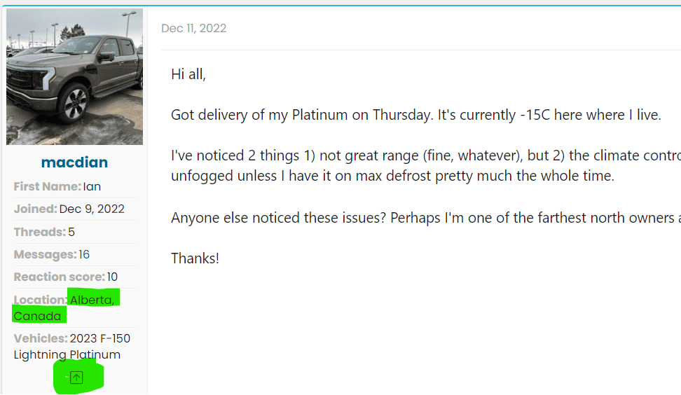

The OP is in Canada, fun fact, by default the user profile details are hidden, but can be shown by click the chevron below the name.

Also, it was clear that I had said -15C - which -15F if definitely cold.
