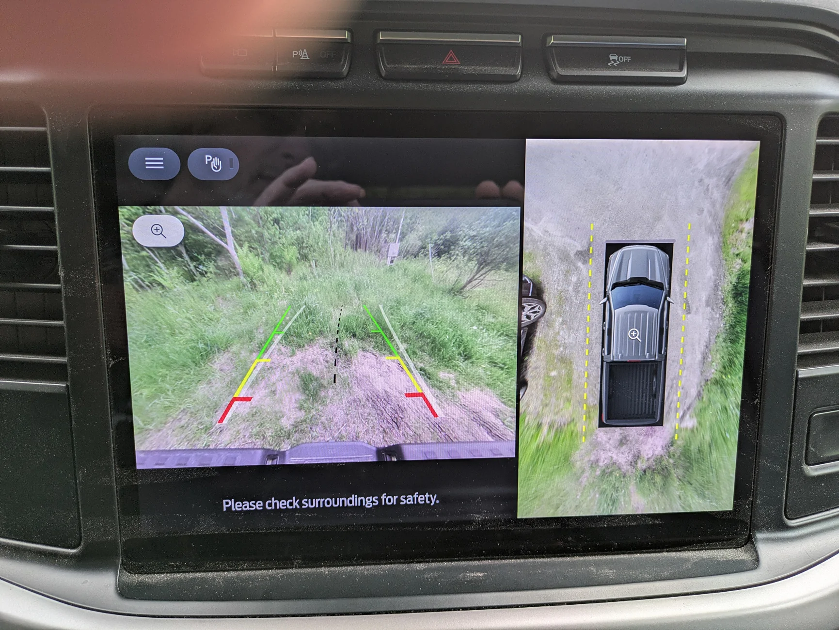

I believe it is the resolution that I have an issue with. My best analogy is that our trucks cameras look like when you put your Windows PC into safe-mode.
Just this week I got into a Chevy Colorado work truck and upon seeing the rear camera, my first thought was "why doesnt my Lightning image look that good"? Either there are different versions/revisions out there or some people see an image and do not discern quality vs just any ole working image.
Regardless, I would gladly pay for upgraded versions of the main front and rear cameras if there were offerings out there. (ie.) If 24/25 year models have better cameras than the 22/23...it is possible that this is a 15" screen resolution problem and not the cameras themselves.

Take it to the dealer - especially if you are under warranty.
That even looks funky in daylight...could be a dirty or damaged camera lens?

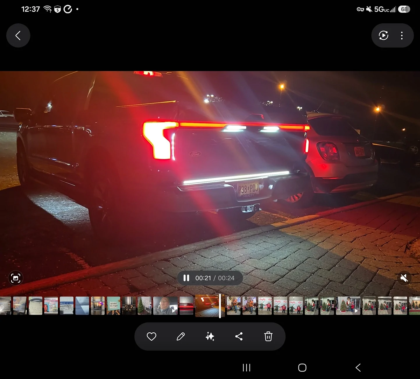

- I have found over many miles in all kinds of weather that the rear camera lens does get dirty quickly, and especially on snowy or rainy days. It might have something to do with the rolling air turbulence right behind the tailgate which will transport crud onto the rear camera lens. To counteract this effect, I A). gently coated the lens with whatever I used to coat my outside door mirror glass, which tends to bead & rapidly shed road crud and droplets, and B). I got into the habit on yucky days to finger-wipe the rear camera lens as I get into the truck. Both actions help to mitigate the camera lens crud although they do not completely eliminate it's buildup.
- I also found that the taillight-integrated reverse lights are too dim, and too high, and too far apart to give good nighttime illumination when backing up. This I solved by the Diode Dynamics' reverse hitch backup / brake / running insert light. The DD hitch light's reverse white light beam gives a great center white light cone, and of course the greatly increased reverse light illumination makes the nighttime reverse camera picture far clearer and and more usable on the Sync screen.

The XLT’s lack the rear light bar which might be the difference. My Lariat is pretty good as long as the camera is clean. (Backing up after driving salt covered roads is a hassle.) Tesla cameras used to be awful until someone at Tesla figured out how to recalibrate the firmware and software to make it 10x better. Ford’s implementation is somewhere in between. I second making sure your backup lights are functioning and the camera lens is clean.
