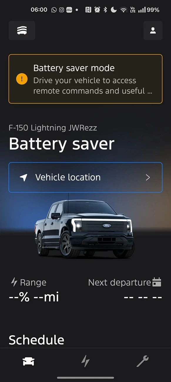

I went to start the heat from the app this morning. I couldn't do anything because it was in Battery Saver Mode. I had driven the truck a couple times during the day. We had a bunch of snow, and temps dipped into the teens, but the snow wasn't bad. I plugged it into my level two charger at 7pm or so. HVB was at around 80%. All research I've done leads me to believe this shouldn't have happened. The LVB was healthy last I checked. I went outside to start it and nothing was showing on the dash regarding the Battery Saver Mode. It started and I turned the heat on manually. 10 minutes later I was in the truck driving to work. No issues. I'm thinking the app was a fluke. I should've shut it down and opened it again. Any one else ever have a similar issue?
