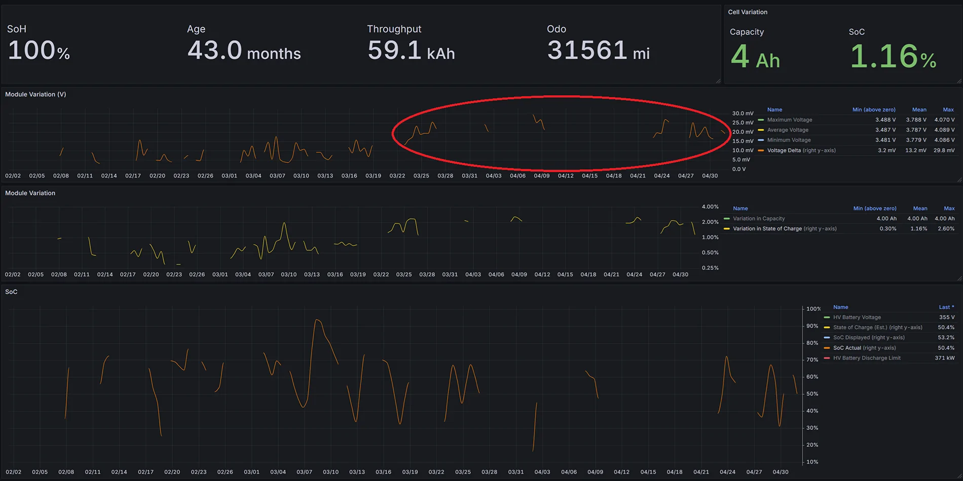

Hopefully this isn't a sign of what's to come, but my module variations made a significant shift for the worse a bit over a month ago...
Sorry my eyes have trouble reading the small features and numbers on your graph, what is the module variation quantity in volts - it looks like the numbers on the right say there is a 3.2mV delta?
I believe that is a good number. :)
Not sure what the threshold is for 'trouble' - I read somewhere it'd be around 40mV to 50mV delta.
Some small cell voltage variations can just indicate the limitations of our passive balancing, which happens during charging and even some time after charging they say, and the delta may vary from charge to charge.
I think if your delta continued to get larger rapidly approaching the 40mV-50mV threshold, that would be an indication of a failing cell or cells.
With over 3 years and 31k miles 3.2mV is not bad I think...but maybe others with similar mileage can weigh in and give us some more data points?
It used to be between 3-15mV but as of a month ago it's between 15-30mV.
The FDRS battery report said:
Exceeds .030 volt threshold from average, Cell:
I ran that report in January so there was no deviation to speak of, but if I notice it going over 30mV I'll probably run another one just to see what it looks like.
:sadface:
Yes, doubling to 30mV and approaching the threshold is concerning.
I wonder what the threshold is for Ford to do a module replacement, or do you just have to wait for the failure messages?

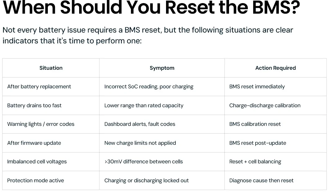

If the BMS really needs re-calibration/reset, because of drift or whatever, there should be tell-tales signs.
Ford F-150 Lightning Battery SOH - bragging rights or bullshit? when to reset bms
There are several methods I have read about for reset/recalibration/rebalancing.
NOTE: I have not verified these methods so attempt them at your own risk.
One methods says, first charge to 100% and let it sit there for some period of time still plugged in, a couple of hours at least. Then you discharge down to a safe low level like 20% and let it sit for several hours - that's a lot of driving, more than I usually do. Then you charge back up to 100%.
Another method is to take it down to 10% and let it sit there for some time with the truck ON in ACC mode, then charge to 100% and drive around a to let the BMS relearn the battery level.
The HVBMS might also be reset using an OBD tool and FORscan or FDRS according to internet sources.
There is also a battery pack re-balancing procedure accessible in FORscan or FDRS according to internet sources.
But I think that since cell balancing occurs during charging, and takes time (because the discharge current of the stronger cells through resistance to match the weaker cells has to be limited), a slow charge to 80% or 90% ought to be good enough to achieve good balancing results in theory.

Now, IF I saw a greater than 30mV delta, I'd probably try on of the methods above.
