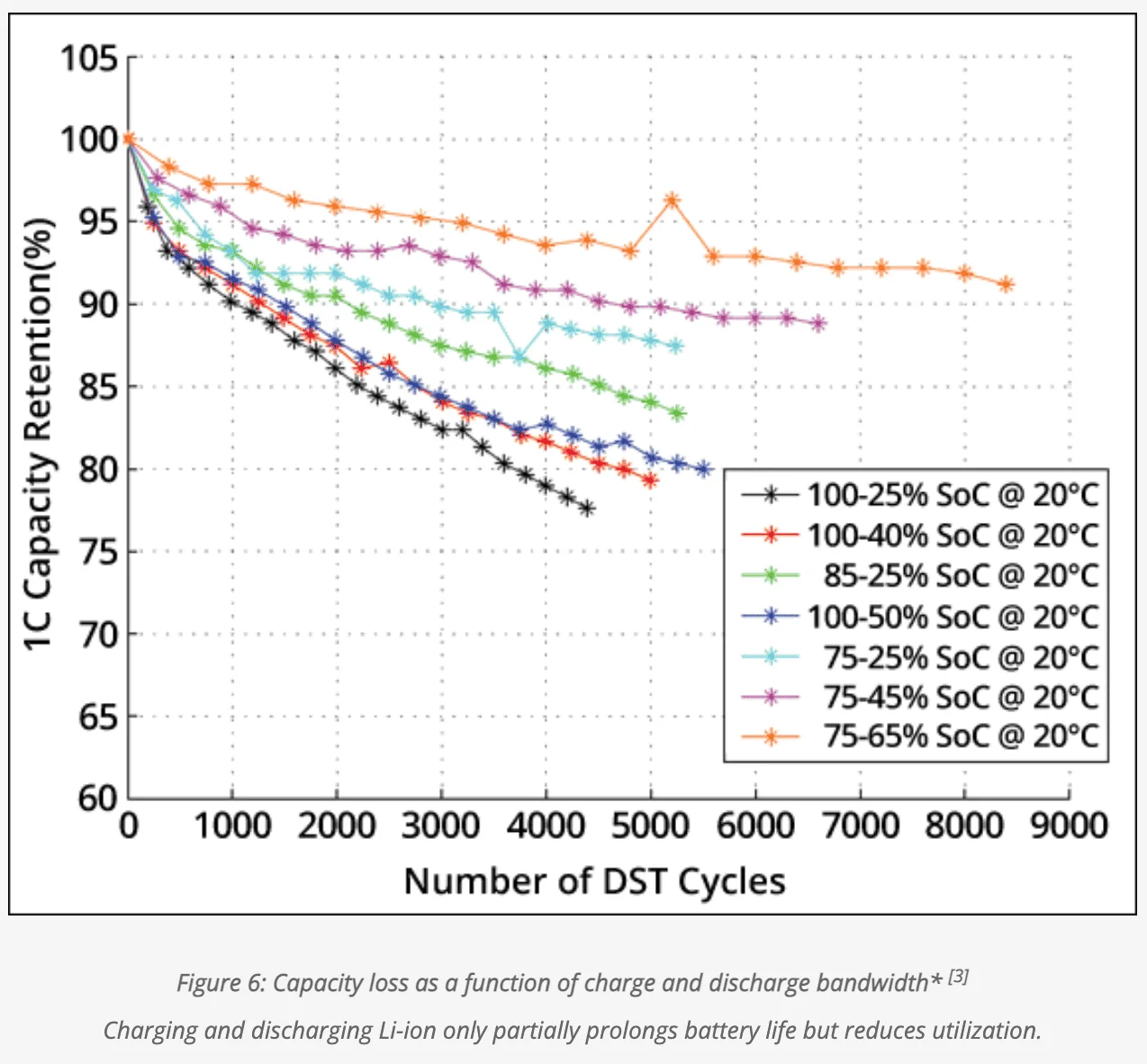

If you have pointers to studies that can answer that question, it will be helpful.
This chart is published at https://batteryuniversity.com/article/bu-808-how-to-prolong-lithium-based-batteries
This study using 1C charge and discharge speeds included two at 10% DoD, two with 50%, two with 60%, and one with 75%. This report indicates the closer you stay centered at 50% and away from 100% is best. Also, MickyAO reported staying above 20%, especially at higher temperatures is a good plan.

Thanks. This study like any other I have seen compares different cases at fixed DOD+SOC which does not address my question. My question involves comparing degradation between variable and fixed. For example for the following cases:
1 - Fixed DOD (20%) variable SOC (EX: 30-50, 40-60, 50-70)
2 - Fixed DOD (20%) Fixed SOC (40-60)
3 - Fixed DOD (40%) Fixed SOC (30-70)
Of course this being all cases having the same cycle.
Basically I am curious when it comes to cracking, do the little buggers in number 1 crack as bad as number 3 or as good as number 2.
The article you are referencing uses a variable SOC, not fixed. They are attempting to determine if we're the cycling happens degrades battery life (it does).
Within the LFP video they also discuss the point of DOD vs SOC. They explicitly did 100%-0% and 4x as many 25% discharges at different SOC. This was done to ensure the total number of cycles is the same, but to determine if big discharges are better or worse than multiple small discharges.
I would try the videos and studies again because I think the information you are looking for is there.

I don't think we are on the same page regarding my question. Would you mind sharing the time stamp for the video where you believe it answer's my question? Or copy and paste of the part of the article that does that?
To be clear by variable, I mean moving DOD from one SOC range to another for the same battery.
in the example I listed, number 1 would be something like doing
30%-50% and 50%-30% 100 times
Then do 40%-60% and 60% to 40% 100 times
Then do 50%-70% and 70%-50% 100 times all on the same battery
for case number 2 do 40%-60% and 60% to 40% 300 times
for case number 3 do 30%-70% and 70% to 30% 150 times
Then compare degradation. I didn't see anything like this in neither the study you refer to nor the videos. If I missed it, please share exactly where. I understand the references to batteries not liking higher SOC/voltage so 50%-70% may not be as good as 40%-60% but aside from a minor impact, that is an entirely different issue. I am trying to see when it comes to cracking, if the battery sees the first case really as 40% DOD (the same as third case) because the outer boundary of the range is the same. or it sees is like 20% DOD because most of inflation and deflation of electronic balloon happens withing 20%.
If you see an answer to that, please be more specific.
The LFP video discusses 25-0, 50-25, 75-50, 100-75, and 100-0 and covering the same number of complete cycles. I quickly scanned the NMC video and i believe he had similar information, although not exactly the same numbers, however i did jump through that one quickly.
That covers both DOD and SOC. I don't have the timestamps handy, sorry.
Edit: The lfp videos used different percents than I quoted above. You really have to read the studies and watch both videos.
