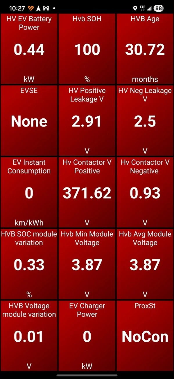

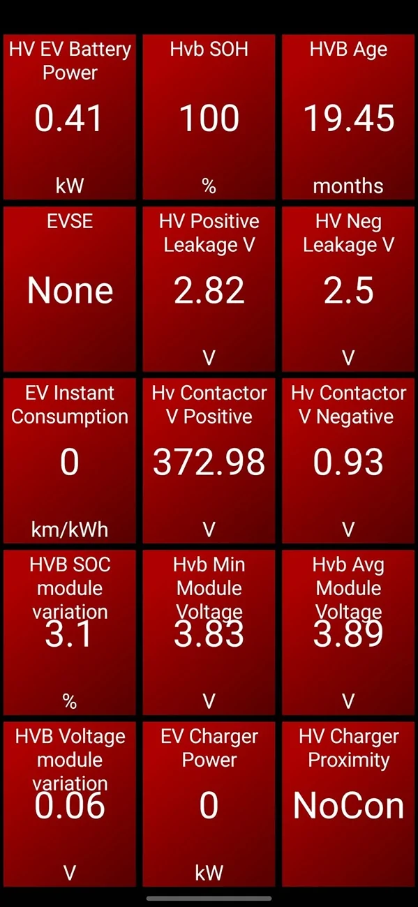

I am currently in the process of having one module replaced. Before it went into the shop Car Scanner was showing 100% for the battery state of health. So I don't think it reliably tells you anything about the health of the HVB.
I ended up having two modules replaced. I love the truck but IMO HVB SOH doesn't reliably tell you anything about the health of the HVB.
HVB SOC module variation is what told me that one or more modules were bad. The first image is when the truck went in for repair back then and the second is from last week.
Ford F-150 Lightning Battery SOH - bragging rights or bullshit? Bad
Ford F-150 Lightning Battery SOH - bragging rights or bullshit? Good

Ideally the SOH tells you something about battery capacity degradation.
But it does not tell you about bad modules failing unless and until there is a huge drop in SOH.
Other module failure indications should show up before the BMS tells you you SOH has dropped significantly.
One or a few bad cells in a module is not going to change the 'capacity' of the battery that much so the SOH will not show that the module is in trouble.
As noted above the voltage different especially under load is the indication to look for.
From my experience reading about the Leaf battery, the best way to get a sense of the battery's well-being (avoid calling it 'health') is to monitor the voltages and delta in a dynamic test, that is when driving and especially accelerating. That is when problems can't hide.
There are ways to spoof the battery scan readings senn with LeafSpy for example, or any scanner, which unscrupulous Leaf sellers know about, but they fail with an acceleration test.
