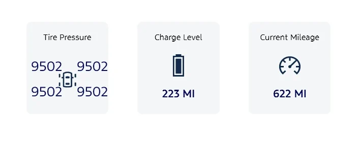

Ford F-150 Lightning BCM Updates, APIM Updates and Walk Away Lock Feature tire pressure - OMG
According to the Ford Account Vehicle Dashboard...
A few bugs in the system, a HAL 9000?

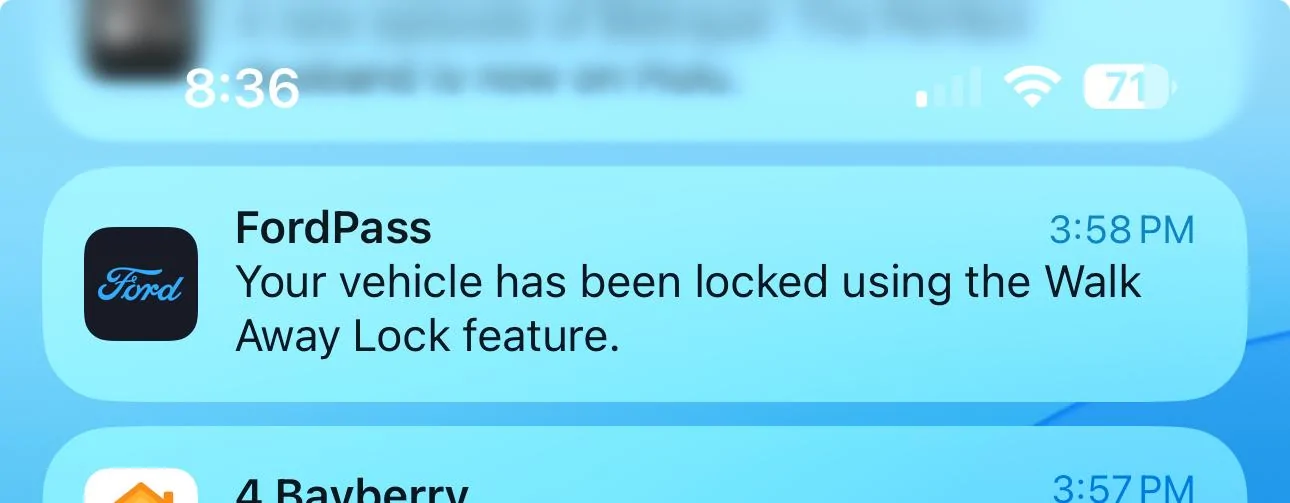

Can anyone here show me they have auto lock on walk away, in their Lightning? Anyone?
ChrisCon
Jan 7, 2022
517
962
The Hamptons, NY
Are we sure that's on a lightning? I haven't heard one person speak of this, other than wishes....
- it's from my my phone on my truck . Private message me your phone number and I will text you a video of me with my truck (in the Hamptons , lol @ATXORIGINAL if that's what you were joking about before ) and my phone and you can watch me walk away from my truck in real time and the truck lock and the alert come up on my phone. I don't have the toggle on my center stack because o haven't had the UI update yet that enables the toggle as @MikeG mentioned in a previous post.
maverick129
Jul 8, 2023
63
52
2018 Expedition
I do. I took my truck in for some recall work and the dealer updated something. The toggle isn’t in sync, but it works well with PAAK. A feature I really wanted and glad I have it
