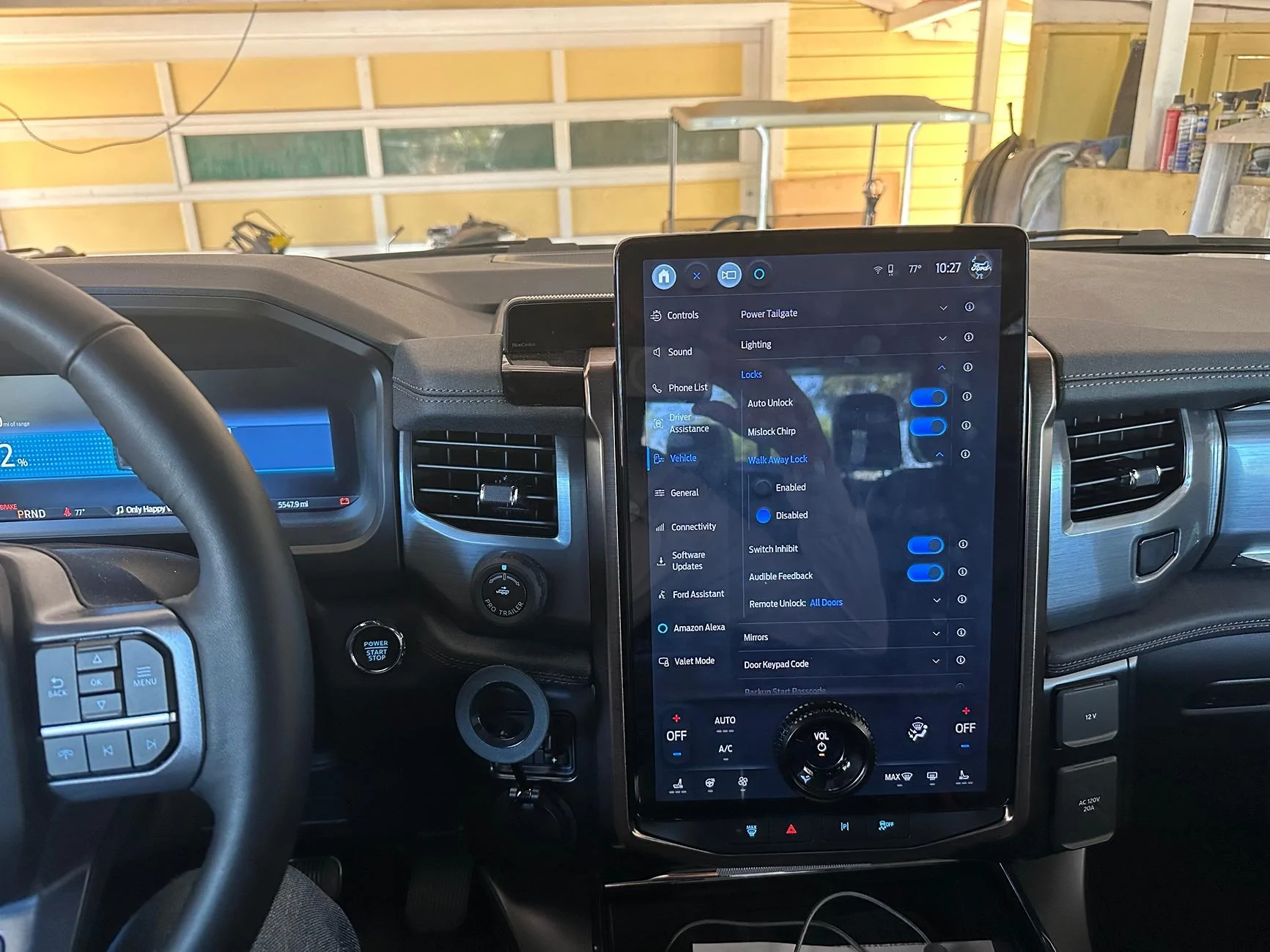

Show me an F-150 Lightning screen with this option, and I'll take it back. Not Fordpass for an unnamed vehicle. Until then, I'll say I haven't seen it confirmed yet.
I have the update but disabled WAL as it was annoying to always need to unlock the truck. Where I live I'm not worried about needing to lock my vehicles.

Thank you. I now stand corrected.
And apparently you never clicked the link I provided to the post where I described how to add the toggles to the Sync lock section and posted the screenshot with it shown there, from back in May.

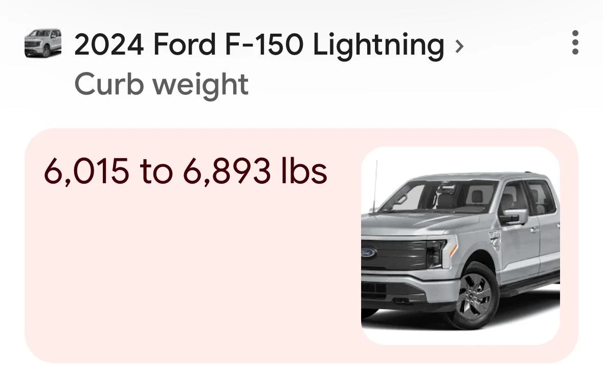

I think the 107 MPH limit has more to do with the rating of the tires than ford just wanting to babysit your top speed. 107mph seems reasonable to me in a 8000 lb truck
LOL at 8,000lbs. ??‍♂

Note from overly educated person: Since it's the kinetic energy of the vehicle that's going to turn everything into hamburger during a sudden stop, and the kinetic energy is proportional to 1/2mv^2, I'd worry about the speed more than the weight. At 107 mph, hamburger is in the making whether you're traveling in a vehicle weighing 2,000 lbs or 8,000 lbs since the kinetic energy to be dissipated is only directly proportional to the mass but more dramatically proportional to the velocity squared, e.g., four times as much force is involved stopping a vehicle traveling at 40 mph vs. 20 mph, etc. 25 times as much g force stopping a vehicle traveling at 100 mph vs. 20 mph.

Thank you for helping make my point. Splitting hairs over the 1000 pounds empty vs loaded isnt much.
