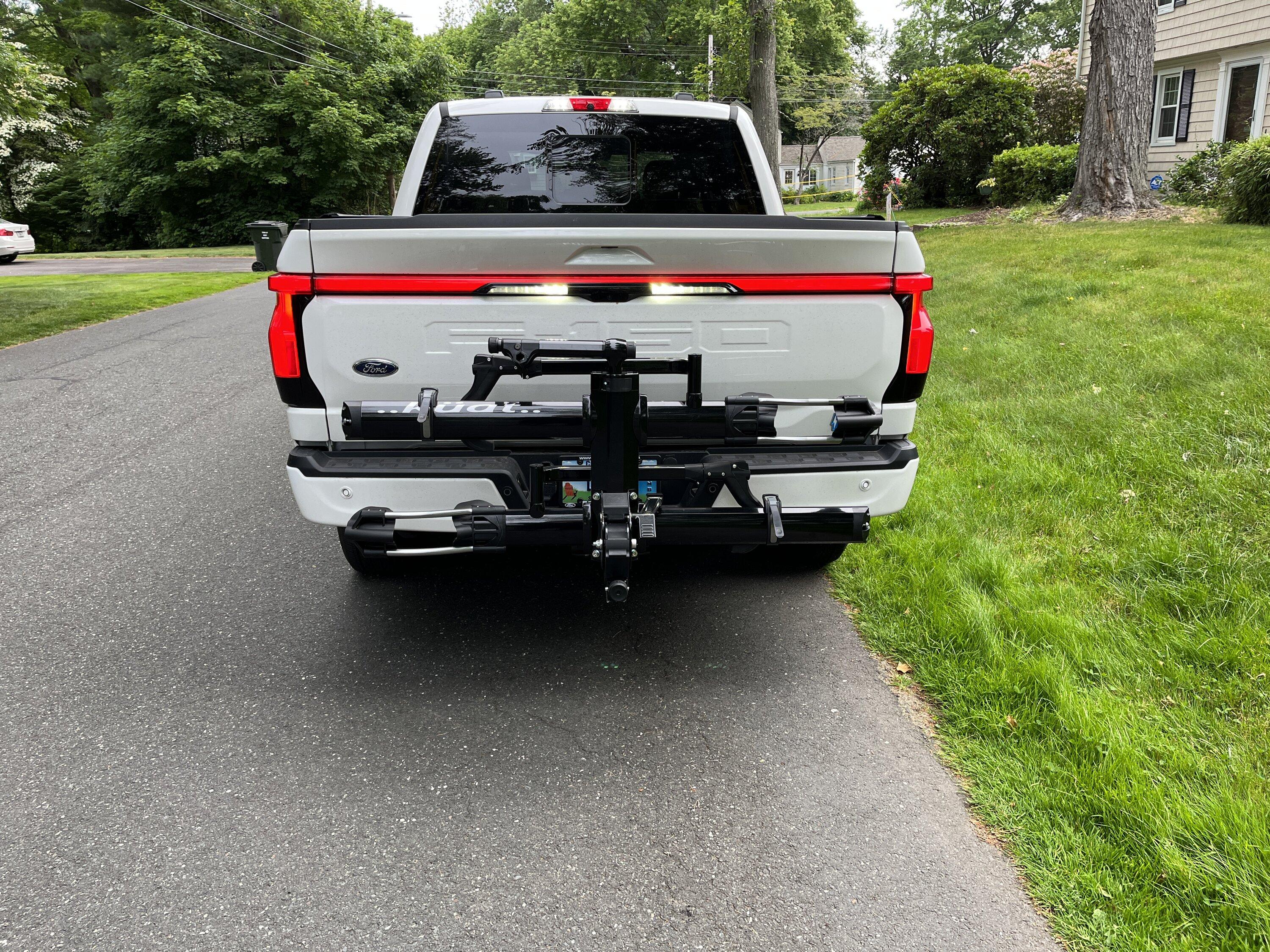

Any tips on how to easily turn off the reverse sensors when you’re backing up with a bike rack mounted at the tail hitch?
The truck brakes and stops me from backing up, thinking I’m going to hit something/someone.
I’ve tried using the tow status , picking a trailer to get the truck to relax the back up sensor,
But that doesn’t seem to always work, and I’m wondering if there’s a quicker, easier way to put the truck into a mode that will ignore my bike rack ?

You need to add the bike rack as a trailer, with a 3 foot length. This adjusts the cross traffic alert. This is explained in the manual.
Each time you use the bike rack, you'll want to go in and select it manually. Then, when you are done, go in and unselect it.
Or, you can cancel the alert each time you back up, it will hold once per key cycle.

Thanks, that seems to be working out now.
I also never noticed this little slide button option on the screen to quickly turn off the back sensors, when you put the truck in reverse. That works like a charm !
