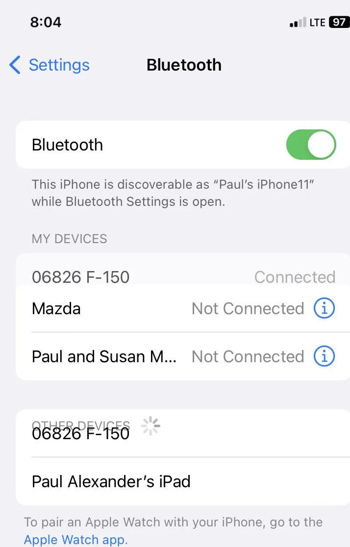

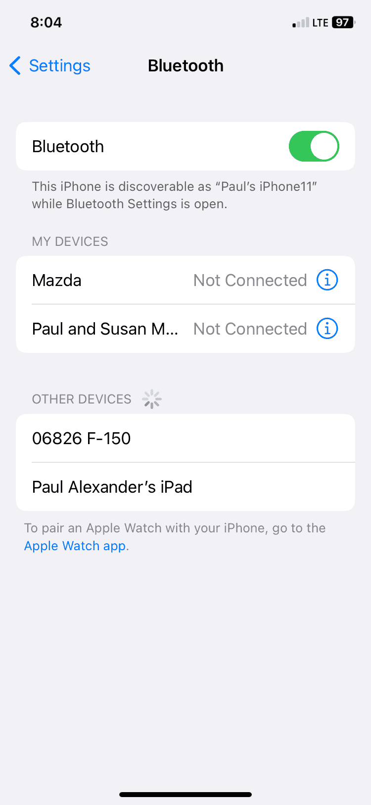

Recently my Bluetooth stopped working in the Lightning. I set it up on the 15'" SYNC screen and it worked fine for a while. Now, Ford Pass shows Bluetooth Disconnected. I attempt to discover it on my iPhone and there is a Bluetooth device that resembles the last 5 digits of my VIN. However, it flashes on and off and does not connect (see attached). The named device from my Lightning does not appear in the list of devices on my iPhone, just the flashing 'ghost' device. Any assistance would be greatly appreciated.

If anyone is interested, I found two separate issues. SYNC had lost my phone. It was showing up in "Phone List," making me think it was OK. But when I readded the phone, I was able to reconnect Bluetooth and Appleplay. The other issue of the 'ghost' Bluetooth device. That was the Lightning's Bluetooth device for PaaK having lost connection with my iPhone PaaK. I reloaded Paak and I'm all set. The need for this reloading was not apparent because Paak seemed to be working. The clue is the Frunk and Tailgate buttons are unavailable. On my MME over the last 2 years, I've had to reload PaaK five times, now twice on the Lightning. It has become old hat.
