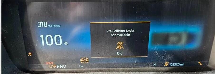

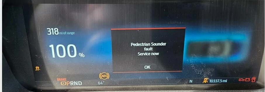

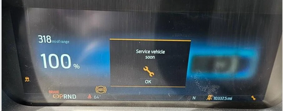

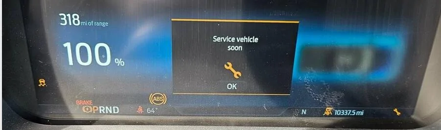

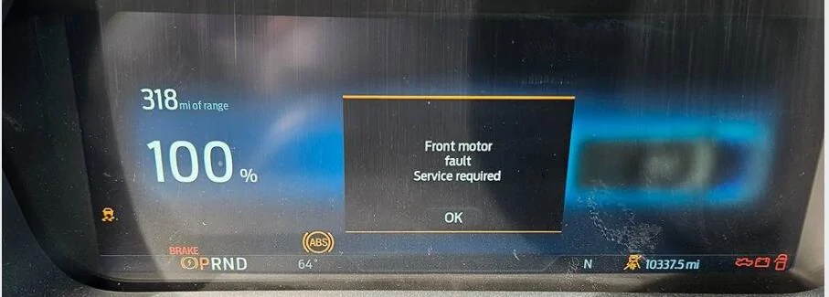

Here are pics of dash errors
Ford F-150 Lightning Automatic updates stopped working 1743728243120-qn
Ford F-150 Lightning Automatic updates stopped working 1743728282655-h
Ford F-150 Lightning Automatic updates stopped working 1743728309029-
Ford F-150 Lightning Automatic updates stopped working 1743728331340-bd
Ford F-150 Lightning Automatic updates stopped working 1743728359625-yo

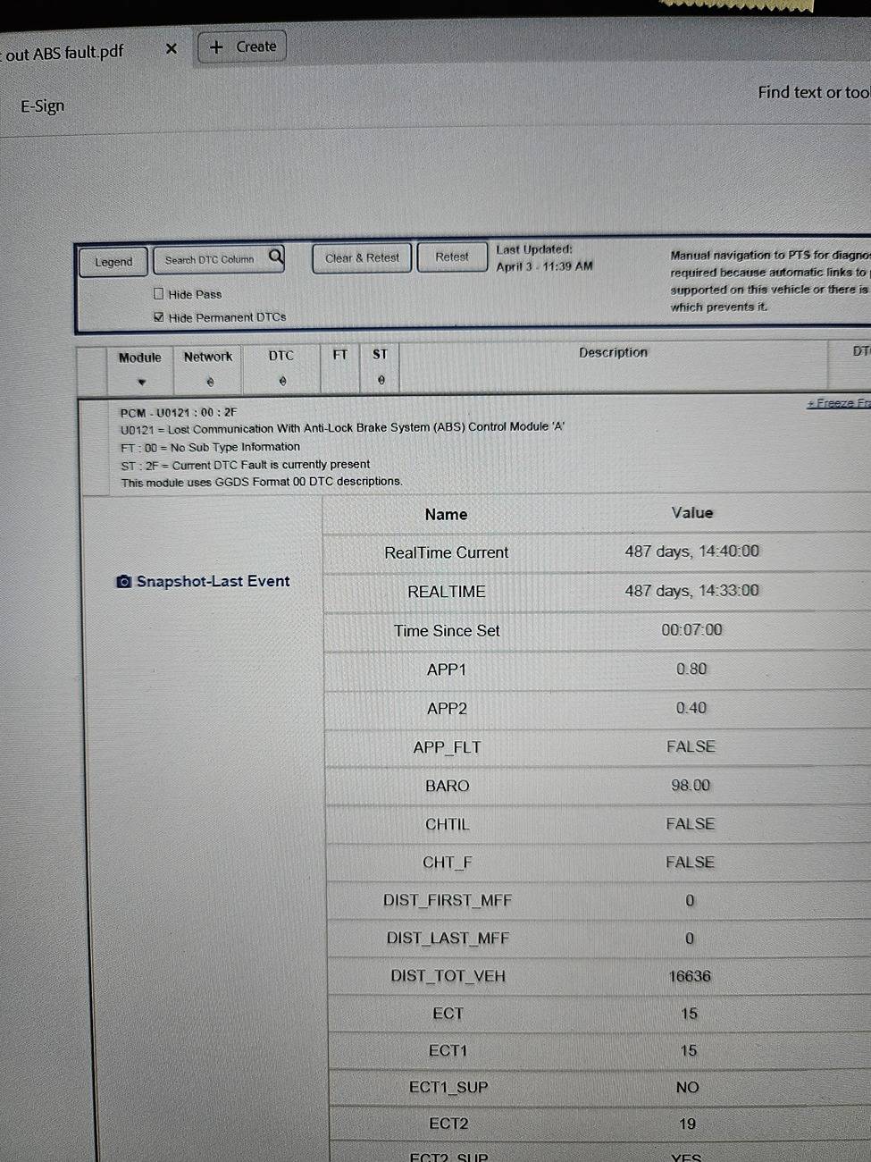

What DTC's are you seeing in FDRS? Communication errors with ABS module?

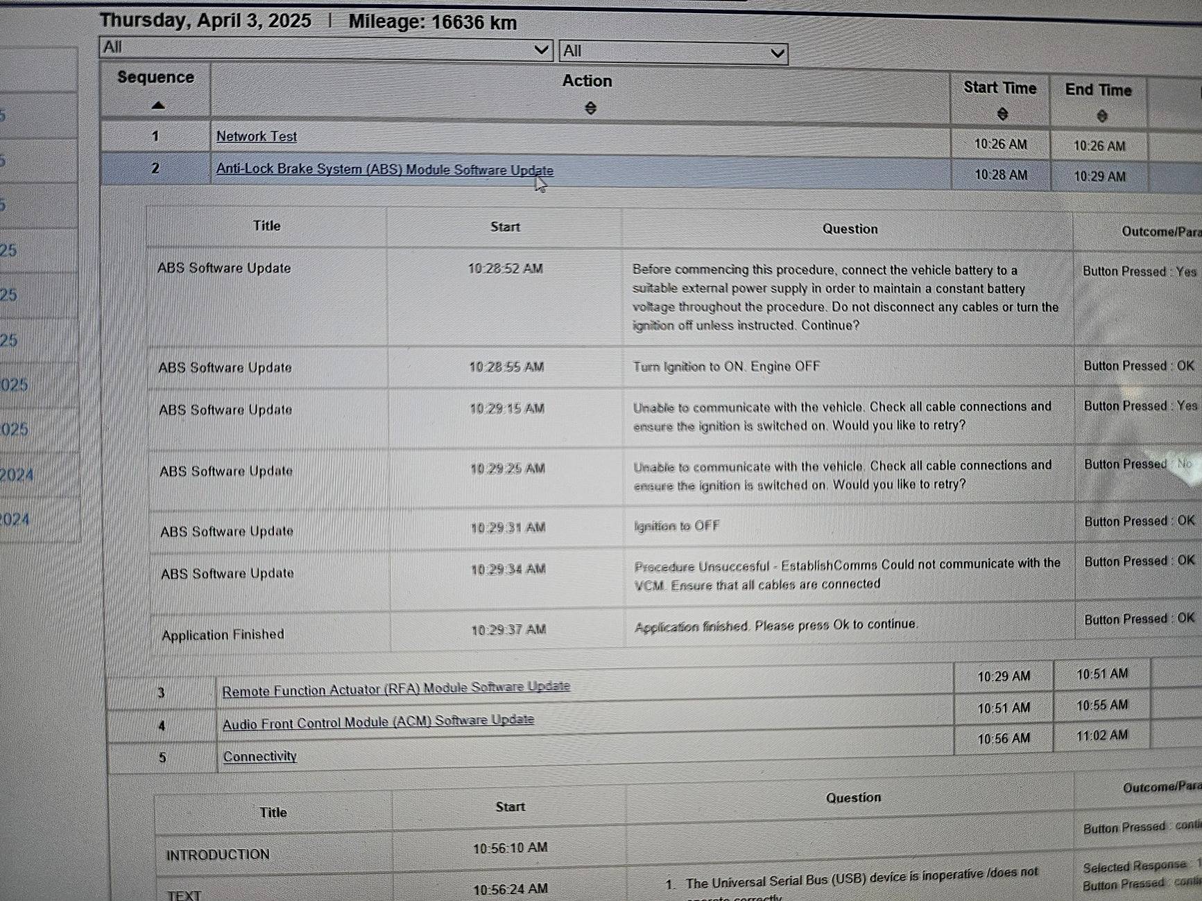

Yes, several DTC errors, but at top level all say cannot communicate with ABS Module.
Ford F-150 Lightning Automatic updates stopped working 20250403_151640

The truck is reporting the following code:
Ford F-150 Lightning Automatic updates stopped working 1743718902785-nv
The TSB referenced by the code is attached. It could be due to a loose camera connection between the IPMA and the camera itself.
In terms of the connectivity issue, I think I found the problem. Assuming you are in the US, the country code in your TCU is wrong. This can easily be fixed with FORScan. Your truck was sent an OTA to fix this, but it failed.
Ford F-150 Lightning Automatic updates stopped working 1743719124476-13
The country code for the US is 5553. Changing 3030 to 5553 will fix the TCU issue.
Not sure if Trump has thrown Indiana out of USA yet or not, but I think I still am. I wonder how county code got altered? Maybe I have always been in 3030. Is that the country of Winchester??? Is this TCU thing common? I will get my forscan set up tomorrow. I guess the dealer will get first crack to fix everything. That is fine, if when I get it back everything is perfect. I am just skeptical.

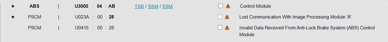

Have a question for you that TSP you sent. It talks about U3000 : 49. Is that the same as U3000 : 04?
Good catch.....I didn't notice that. Not sure what the 49 failure means, but in the case of the ABS code you have, 04 cites "system internal failure" when I highlight it. What is strange is the TSB cites code U3000 49 in the IPMA; not in the ABS. However, this is the TSB that it takes me to when I click it. The SSM's are unrelated to the issue.
However, the other codes it is reporting cite lost comms between the IPMA and PSCM and also invalid data coming from the ABS to the PSCM, so possibly related.
