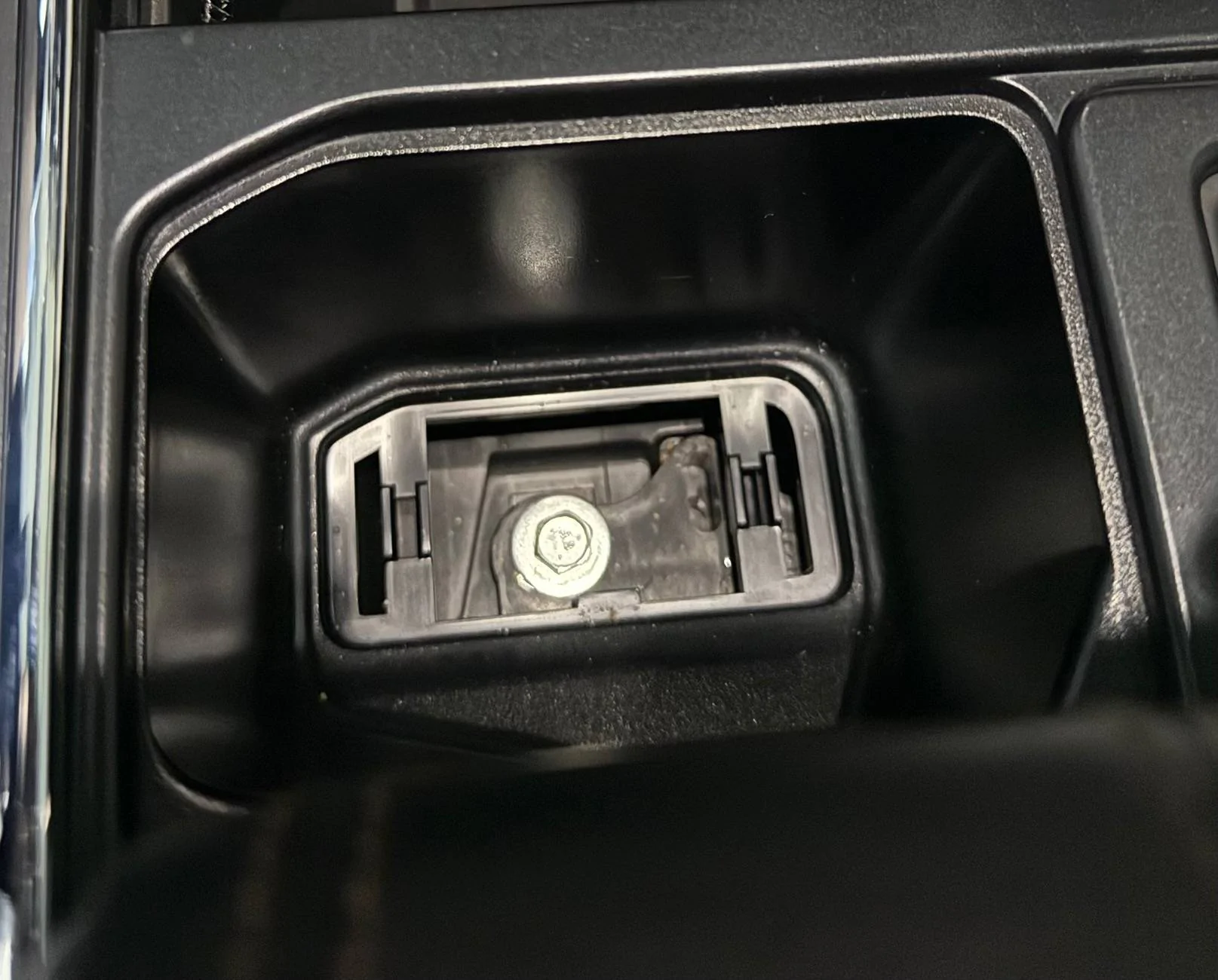

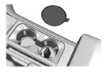

Pop the little door open under the rubber mat in the shifter area. Stick the key in to unlock the shifter and move to neutral
I might be mistaken, but there is no keyable unlock for the shifter on the center console on these shift by wire vehicles.
Are you confusing the passive key fob reader under the cup holder rubber mat?
That's to be used when your key fob battery has died, or to program new keys and create Mykeys?
Are you confusing the passive key fob reader under the cup holder rubber mat? That's to be used when your key fob battery has died.
As per usual @TaxmanHog is correct - I thought the little rectangle hole to the right of the bolt was a release like in ICE vehicles.
@BSEE SPARKY Ignore what I said - There is no manual release.

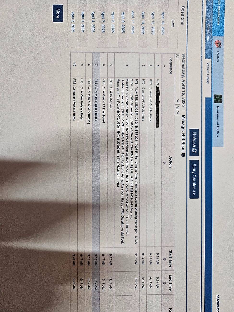

Update on status: They found a workaround for truck stuck in Park. However the parking brake also was set. Therefore they still had to put truck on car dollies to wheel back into shop. They received the new ABS Module and installed it yesterday. They can now start and move vehicle under its own power. They told me something about ford configuration management. They said ford did use each truck as it's own software configuration manager. Therefore every truck might have a slightly different configuration. When new Modules were installed, they would perhaps backward configure to match software version of Module being replaced. However that is not ford's current management plan. They now want configuration control at Ford server. I assume then that all trucks carry a common configuration to greatest extent possible. Anyway they are waiting for Ford to provide the configuration for ABS Module. I think they are also updating any Module that does not match the common configuration being pushed by ford.
The long and the short is I still don't have truck back. I will be surprised if it is done tomorrow, but I dare to dream.
I pulled up data in FDRS, one of the last things they did showed ABS module not responding. But the did have an all green self test. So that is progress. I think it showed 3 Modules that had software update available.

Vehicle history shows the new ABS module was successfully programmed yesterday. Unfortunately, the truck has not reported any codes to the cloud to provide a clue as to what is going on.
The good news is, your truck got OTA 10.1.1 and the BC 1.4 OTA while in the shop. The BC 1.4 OTA did not update the config for lane change and the other new features to work, but you can fix that with FORScan yourself easily when they get it back.
I printed this off this morning
